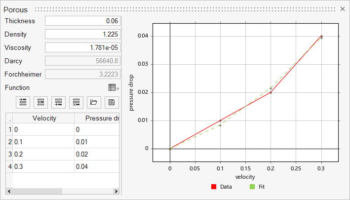

In this tutorial, you will utilize the porous coefficient calculator to calculate the Darcy coefficient and the Forchheimer coefficient after curve fitting of the array data of pressure drop vs velocity. The pressure drop across the porous region can be simplified as the permeability is not included in the curve fitting.
ΔP Δx = C D μ V x + C p ρ V x 2 ∼B V x +A V x 2 MathType@MTEF@5@5@+= feaagKart1ev2aaatCvAUfeBSjuyZL2yd9gzLbvyNv2CaerbuLwBLn hiov2DGi1BTfMBaeXatLxBI9gBaerbd9wDYLwzYbItLDharqqtubsr 4rNCHbGeaGqiVu0Je9sqqrpepC0xbbL8F4rqqrFfpeea0xe9Lq=Jc9 vqaqpepm0xbba9pwe9Q8fs0=yqaqpepae9pg0FirpepeKkFr0xfr=x fr=xb9adbaqaaeGaciGaaiaabeqaamaabaabaaGcbaWaaSaaaeaacq qHuoarcaWGqbaabaGaeuiLdqKaamiEaaaacqGH9aqpcaWGdbWaaSba aSqaaiaadseaaeqaaOGaeqiVd0MaamOvamaaBaaaleaacaWG4baabe aakiabgUcaRiaadoeadaWgaaWcbaGaamiCaaqabaGccqaHbpGCcaWG wbWaa0baaSqaaiaadIhaaeaacaaIYaaaaOGaeSipIOJaamOqaiaadA fadaWgaaWcbaGaamiEaaqabaGccqGHRaWkcaWGbbGaamOvamaaDaaa leaacaWG4baabaGaaGOmaaaaaaa@50FC@
The figure below shows the Darcy and Forchheimer coefficient calculator after providing the velocity (m/s) and pressure drop (Pa) data in addition to the thickness (m) of the porous medium zone, density (kg/m3) and viscosity (kg/m-s) of air.
The Darcy coefficient C D MathType@MTEF@5@5@+= feaagKart1ev2aaatCvAUfeBSjuyZL2yd9gzLbvyNv2CaerbuLwBLn hiov2DGi1BTfMBaeXatLxBI9gBaerbd9wDYLwzYbItLDharqqtubsr 4rNCHbGeaGqiVu0Je9sqqrpepC0xbbL8F4rqqrFfpeea0xe9Lq=Jc9 vqaqpepm0xbba9pwe9Q8fs0=yqaqpepae9pg0FirpepeKkFr0xfr=x fr=xb9adbaqaaeGaciGaaiaabeqaamaabaabaaGcbaGaam4qamaaBa aaleaacaWGebaabeaaaaa@37B3@ and Forchheimer coefficient C p MathType@MTEF@5@5@+= feaagKart1ev2aaatCvAUfeBSjuyZL2yd9gzLbvyNv2CaerbuLwBLn hiov2DGi1BTfMBaeXatLxBI9gBaerbd9wDYLwzYbItLDharqqtubsr 4rNCHbGeaGqiVu0Je9sqqrpepC0xbbL8F4rqqrFfpeea0xe9Lq=Jc9 vqaqpepm0xbba9pwe9Q8fs0=yqaqpepae9pg0FirpepeKkFr0xfr=x fr=xb9adbaqaaeGaciGaaiaabeqaamaabaabaaGcbaGaam4qamaaBa aaleaacaWGWbaabeaaaaa@37DF@ are then calculated based on the curve fit coefficients

  5. In the microdialog, click the coefficient calculator and enter the following values for the coefficient calculator.
    • porous zone thickness = 0.06 (m)
    • air density = 1.225 kg/m3
    • air viscosity = 1.781e-05 kg/m-sec
    Figure 12.
  6. Close the coefficient calculator and confirm the values of the Darcy coefficient and Forchheimer coefficient. Enter permeability values for the three directions as shown in the figure below
