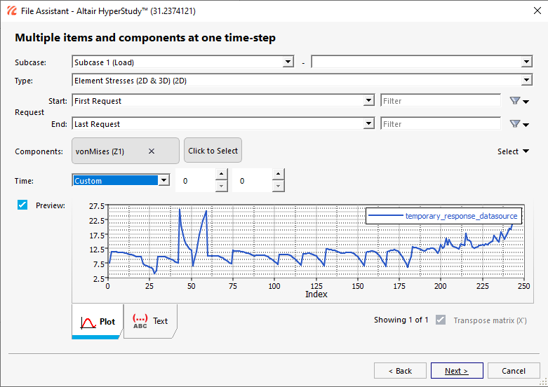

    4. Define the following options, and then click Next.
      • Set Subcase to Subcase 1(Load).
      • Set Type to Element Stresses (2D & 3D) (2D).
      • For Request, set Start to First Request and End to Last Request.
      • For Components, select vonMises (Z1).
      • For Time, select Custom and enter 0.
      Figure 5.
