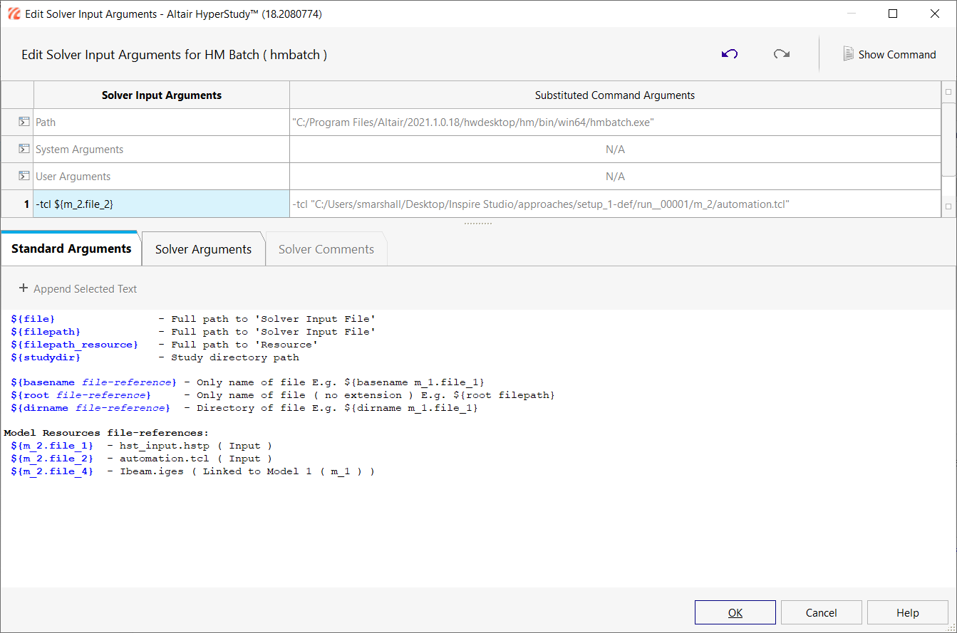

Setup HyperMesh Batch Operator Model
After the Inspire Studio Model run is complete, a geometry file, Ibeam.iges, is output. This file is read by HyperMesh and a finite element model (Ibeam.fem) is prepared via the automation.tcl script in the working directory.
Setup OptiStruct Operator Model
After the HyperMesh Operator Model run is complete, an input file (Ibeam.fem) is created to be used for finite element analysis in OptiStruct.

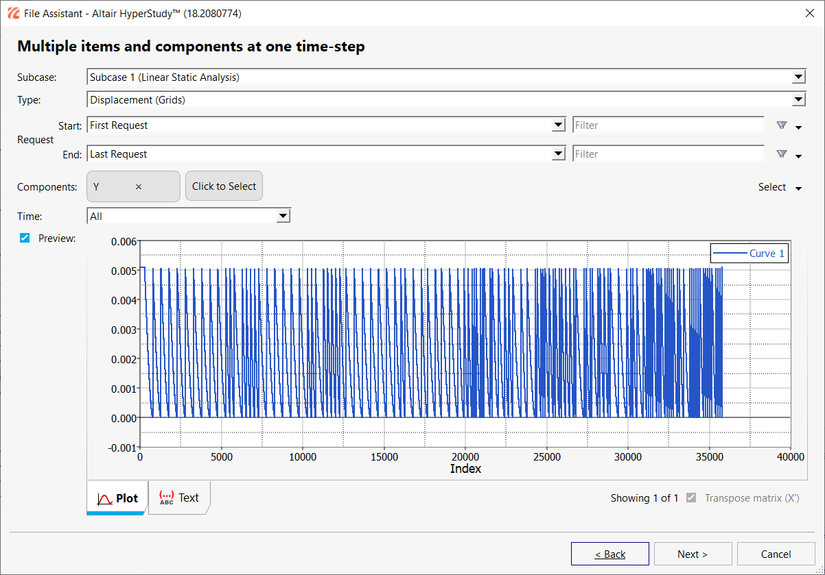

Create Output Response
In this step, you will create a single output response: Maximum Displacement of all nodes in Y direction.
- Go to the Define Output Responses step.
Create the Maximum Displacement output response.
- Click Evaluate.
