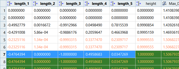

- Go to the Optimization 3 (GRSM, 6 IV, Exact Solver) > Evaluate step.
- Click the Iteration History tab.
Select the optimal parameter values for length_1, length_2, length_3,
length_4, and length_5 parameter, then right-click and select
Copy from the context menu.

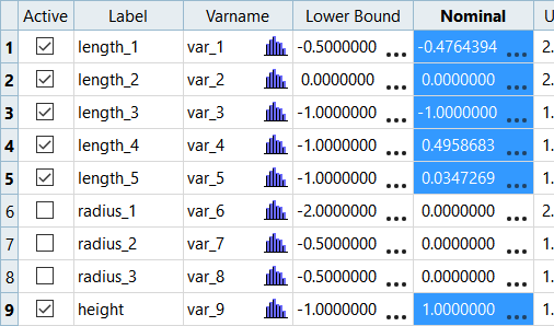

Figure 2. - Go to Stochastic 1 > Definition > Define Input Variables step.
- Select the Nominal fields for length_1, length_2, length_3, length_4, and length_5, then right-click and select Paste transpose from the context menu.
- For height, change the Nominal value to 1.0.

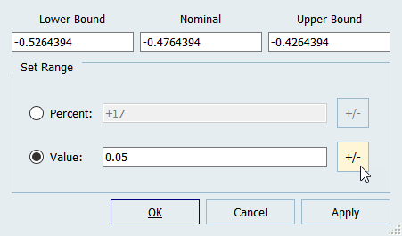

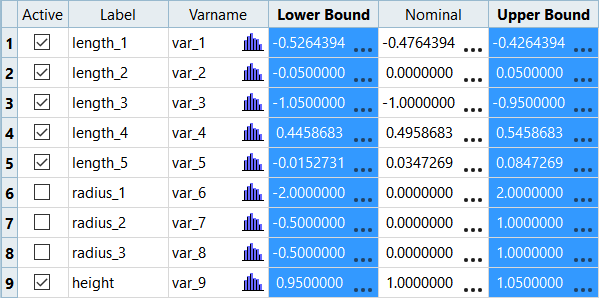

Change the lower and upper bounds for every active input variable to match the
dimensions' tolerances.
For this tutorial, assume that the tolerances are within 0.05 mm.
- For all active input variables, click (...) in the Nominal field.
In the pop-up window, Value field, enter 0.05
and click +/-.
Figure 4. - Click OK.
The Lower and Upper bounds for all active input variables should replicate the image below.

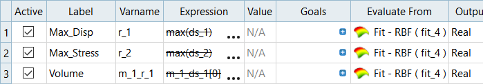

Figure 6. - Go to the Stochastic 1 > Definition > Define Output Responses step.
In the work area, Evaluate From column, select Fit - RBF
(fit_4) for all output responses.
Even though Max_stress was not used in the Optimization, you will use it in the Stochastic study to check the reliability.

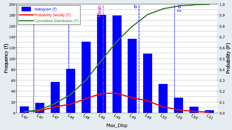

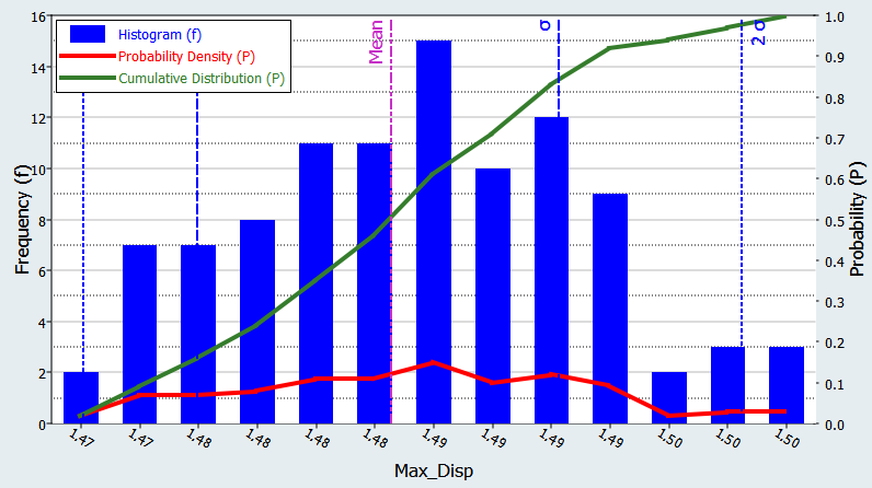

Review histogram of the Stochastic results.

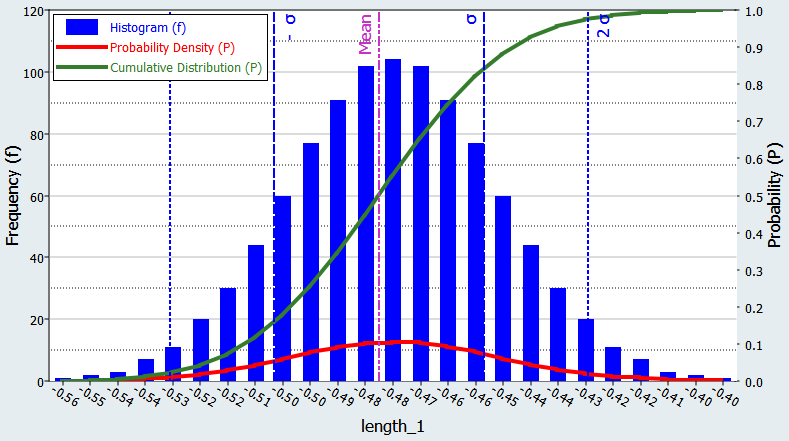

- Click the Distribution tab.
- Using the Channel selector, select Length 1.
The chart shows three pieces of information about the distribution of values for the selected input variable. The Histogram uses the left axis, and represents the frequency of runs yielding a sub-range of response values. The Probability density uses the right axis, and indicates the relative likelihood of the input variable to take a particular value. A higher value indicates that the values are more probable to occur. The Cumulative distribution is another curve that uses the right axis. It is equal to the integral of the Probability density. The value of the Cumulative distribution indicates what percentage of the data falls below the value’s threshold. Note that the initial value of the Cumulative distribution will always equal 0, and the final value of the CDF will always be 1.0. This is because all of the data will reside between the upper and lower bounds.
Figure 8. -

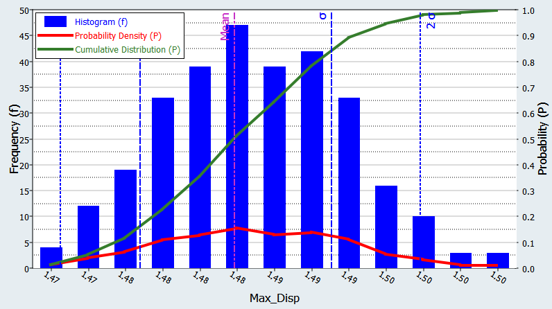

Review the Probability density and the Cumulative distribution of Max_Disp.
Compare the distributions obtained with the different number of runs for
Hammersley (100, 300, and 1000).
Note: You can see the pattern of the distribution changes quite a bit from 100 to 300 runs, but very little from 300 to 1000 runs.
Figure 9. Hammersley, 100 Runs
Figure 10. Hammersley, 300 RunsNote:
Figure 11. Hammersley, 1000 Runs -

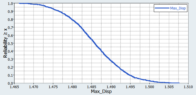

Click the Reliability Plot tab to see the relationship
between the desired threshold and the reliability of the system.
The values reported in the Reliability column of the Reliability tab can be observed on these reliability curves. On the Max_Disp reliability curve, only 11.4% of the designs have a value above 1.5, which means 88.6% are below 1.5. A reliability of 95% can be reached by changing the threshold for Max_Disp to 1.49763.
- Locate the optimal design and copy the length_1, length_2, length_3, length_4, and length_5 parameter values.
- Go to Optimization 7 > Definition > Define Input Variables step.

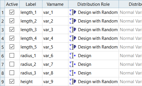

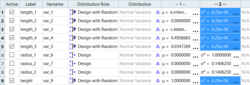

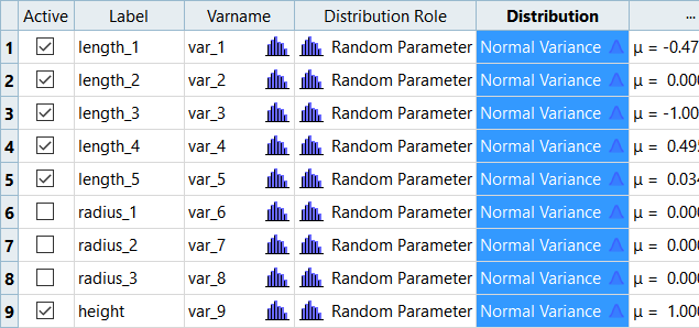

Modify distribution.
- Click the Distributions tab.
In the Distribution Role column, select Design with
Random for all active input variables.
Figure 17. -
In column 2, enter 6.25e-04 for all active input
variables.

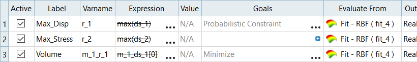

- Go to the Optimization 7 > Definition > Define Output Responses step.
- Click the Objectives/Constraints - Goals tab.
Apply an objective on the Volume output response.
- Click Add Goal.
- In the Apply On column, select Volume.
- In the Type column, select Minimize.
Figure 19. -
Apply a Constraint on the Max_Disp output response.
- Click Add Goal.
- In the Apply On column, select Max_Disp.
- In the Type column, select More.
- In column 1, select Probabilistic Constraint.
- In column 2, enter <= 1.5000000,CDF=95.000000.
Figure 20. -

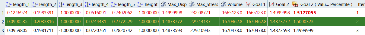

Click the Iteration History tab to review the results of
the Optimization in a table.
A deterministic optimum is found first. As you can see in iteration 1, the displacement is at the constraint bound. This design is not 95% reliable as required in this probabilistic Optimization study. The SORA will work to make sure the constraint satisfies the probabilistic requirement. As seen in iteration 2, the design that meets 95% reliability is the one that has a max displacement shifted away from the bound of 1.5. Corresponding to this improvement, there is an increase in the objective value (volume).

- Go to the Optimization 7 > Evaluate step.
- Copy the length_1, length_2, length_3, length_4, and length_5 optimal parameter values.
