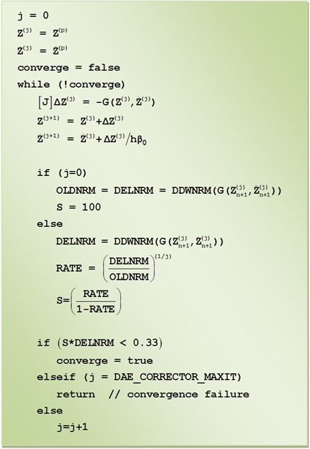

dae_corrector_maxit
The maximum number of iterations that the corrector is allowed to take to achieve convergence.
The default value for dae_corrector_maxit is 4. Under no circumstances should this be increased beyond 8. If the results don't converge for a particular time step, it may be better to let the integrator fail and try to solve with a smaller time step.
If integrator type is CSTIFF, then dae_corrector_maxit defines the fixed number of iterations within each time step.
dae_corrector_minit
The minimum number of iterations that the corrector is allowed to take before it checks for corrector divergence.
The default value for dae_corrector_minit is 0. A value of 0 lets the integrator choose the minimum number of iterations. The integrator may choose to skip corrector iterations if the norm is less than the tolerance for a given step.
Under no circumstances should this be increased beyond 3.
If integrator type is CSTIFF, this attribute is ignored.

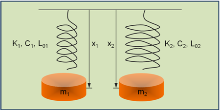

      The concept of numerical stiffness is explained using the simple example shown below.
      The figure below depicts two unconnected spring-mass systems. The first system has a mass M1 supported by a spring with properties K1, C1 and L01. The second system has a mass M2 supported by a spring with properties K2, C2 and L02. The displacement of mass M1, measured with respect to a global coordinate system, is denoted as x1. The displacement of mass M2, measured with respect to a global coordinate system, is denoted as x2.
      Assume:
      • M1=1Kg, C1=2 N sec/m and K1=104 N/m
      • M2=1Kg, C2=2x104 N sec/m and K2=108 N/m
    Figure 1. Two Unconnected, Simple Spring-mass Systems
    For each system, i, the following are easily ascertained:
    • The equation of motion for system-i is:
      (1)
      M i x ¨ i + C i x ˙ i + K i ( x i L 0i )=0
    • The eigenvalues for system-i are:
      (2)
      λ i = C i ± C i 2 4 K i M i 2 M i
    • The eigenvalues and response for the first system is:
      (3)
      λ 1 = 1 ± 99.995 i x 1 ( t ) = X 01 e ( 1 ± 99.995 i ) t = X 01 e t [ cos ( 99.995 t ) + i sin ( 99.995 t ) ]
    • The eigenvalues and response for the second system is:
      (4)
      System 1 is under-damped. It will display decaying oscillations in response to an initial disturbance. After 0.01 seconds, the initial disturbance is reduced by a factor = e-0.01 = 0.99 of the original value. System 1 oscillates at a frequency of 99.995 radians/sec.
      In contrast, system 2 is over-damped. After 0.01 seconds, the initial disturbance is reduced by a factor = e-100 = 3.72 x 10-44 of the original value. For any initial disturbance, system response is almost instantaneously damped out. System 2 does not oscillate at all.
      A system exhibiting these characteristics is called numerically stiff. One component of the solution exhibits slow decay to an initial excitation whereas another component rapidly dies almost instantaneously.

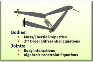

  2. Differential Algebraic Equations
    A system of equations, which is a combination of ordinary differential equations, and algebraic constraint equations are called differential algebraic equations.
    Figure 2. A Multibody system.
    For example, in a multibody system (MBS), Newton's second law manifests itself in the form of second order, ordinary differential equations (ODE) while constraints in the system (joints, for example) manifest themselves as algebraic equations (AE). Hence, the mathematical representation of a typical multibody system is a system of differential algebraic equations. The mechanism shown in the figure above is usually characterized by differential algebraic equations.
    Ordinary differential equations are represented as:(5)
    y are the states to be integrated
    Differential algebraic equations are represented as:
    (6)

    Assume that a system is defined as follows:
    • "N" displacement coordinates q=[q1, q2, … qN]T are used to represent the system.
    • The coordinates q are not all independent.
    • "M" displacement constraints Φ =[ Φ1(q,t), Φ2(q,t), … ΦM(q,t)]T exist between the "N" coordinates q.
    • Let λ = [ λ1, λ2 … λM]T represent Lagrange Multipliers required to maintain the constraints Φ.
    • Let F = [F1, F2 … FNa]T represent external forces acting on the system.
    • Let the kinetic energy of the system be and the potential energy be.
    • Then the Lagrangian function may be expressed as .
      Under these assumptions, the equations of motion for the system can be represented as:
    The above equations are called the Euler-Lagrange representation of the equations of motion. In matrix form, equation (1) can be written as:
    Equations (2.1) represent the force balance equations. The first term represents the inertia force, the second term represents the constraint forces and the third term the generalized external forces. Equations (2.1) is thus a restatement of Newton's Second Law of Motion. Equations (2.1) are differential equations that relate the time derivative of velocity (acceleration) to the external and internal forces acting on the system.
    Equations (2.2) represent the kinematic differential equations in the system. These equations represent the equations of motion in first order form. To accomplish this, a new set of variables, u, the velocities are created. Velocities are defined as first-time derivatives of displacements. Equations (2.2) are also differential equations.
    Equations (2.3) represent the algebraic constraints in the system. These come into existence because the equations were not formulated in terms of an independent coordinate set. The system has p=N-M degrees of freedom. The N coordinates therefore can be related to each other through M algebraic constraint equations.
    Equations (2.4) represent the user-defined differential equations, specified using Control_Diff, Control_SISO, and Control_StateEqn elements. The user-defined states are denoted by x.
    Equations (2) are a set of implicit, differential-algebraic equations (DAE). Let Z = [u, q, λ, x]T. Equations (2) can be represented in compressed notation as:

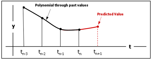

      a) Predict
      The purpose of the predictor is to provide a good initial guess for the corrector. The predictor fits a polynomial through the previously calculated solution points. It then extrapolates the polynomial to the new value of time to "predict" the solution.
    Figure 5. The Predictor
    The image above shows how the predictor in DSTIFF works. Tn is the current time, and the integrator is predicting the value at tn+1. The predictor polynomial is shown in black. The extrapolation is shown in brick red. The predictor simply extrapolates past values; it does not solve the equations of motion. The order of the integrator defines the number of past values to take. In Figure 5, the order of the integrator is three, so three past values, starting from tn, are considered.
    DSTIFF uses Newton Divided Differences to create an interpolating polynomial. This polynomial has the form:
    The quantities [ Zn,Zn-1 ], [ Zn,Zn-1,Zn-2 ], etc. represent divided differences of the state Zn.
    VSTIFF and MSTIFF use a slightly different scheme. An integrator of order K at time = tn has available to it K orders of derivatives. The integrator simply uses a Taylor's series expansion of the states Z to predict a solution at time = tn+1. This is shown in equation 8 below.
    h = tn+1 - tn is the step size.

      The corrector goal may be stated more precisely as:
    • Given a predicted value Zn+1(p) that is determined by the predictor, find a corrected value Zn+1(c) that satisfies the equations of motion (equations 3 or 7).
      Using a first order Taylor's series expansion of G() about the predicted value, you obtain,
    Define:
    Then:
    From (9) we get:
    Substituting (12) into (11), we get the corrector relationship:
    The matrix [J] is called the Jacobian matrix of the equations of motion. From (13), a corrector iteration sequence is defined as shown in the figure below. At the heart of the process is the Newton-Raphson method of solving non-linear algebraic equations.
    Figure 6. Corrector iteration sequence in DSTIFF.

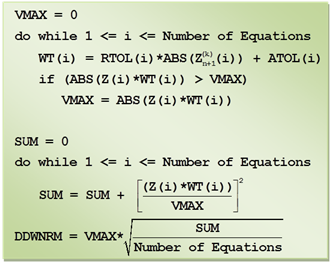

    The error norm is calculated in DDWNRM(…) as shown in the figure below.
    Figure 7. The calculation of the error norm in DDWNRM (…).
    In the figure above:
    • RTOL[i] (relative tolerance) and ATOL[i] (absolute tolerance) are calculated from the error tolerance, INTEGR_TOL, specified in the PARAM_TRANSIENT block of the input file and a scale factor that is dependent on the variable type: RTOL[i] = ATOL[i] = INTEGR_TOL * SCALE[i].
    • SCALE[i] is calculated from the attributes VEL_TOL_FACTOR and DAE_ALG_TOL_FACTOR specified in the PARAM_TRANSIENT block of the input file and is explained further in the table below. The various states in Z are scaled as follows:

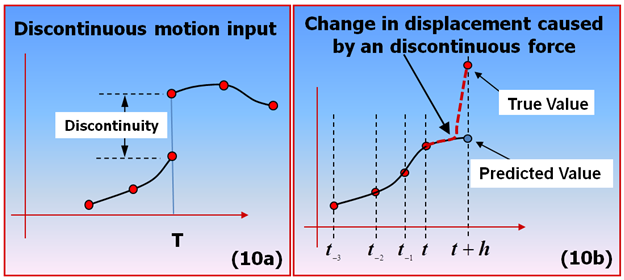

  9. My model fails due to integrator failures. How can I diagnose this issue and fix it?
    Multi-step integrators like DSTIFF and VSTIFF estimate the local error at each step by computing the difference between the predicted and the corrected value of the solution, and scaling it by an "error coefficient" that is calculated by the integrator. A bad prediction can therefore cause an integration error.
    Predictions can be inaccurate for two reasons:
    • There is a discontinuous motion input in the system.
    • There is an almost discontinuous force in the system.
      The effect of such modeling is shown in figures 10a and 10b below.
    Figure 9. Discontinuities are the root cause of integration failures.
    Discontinuities such as those shown above can be caused by function expressions or user subroutines that use IF-THEN-ELSE logic carelessly. Modeling elements that should be examined for discontinuities or sharp changes include:
    • Forces
    • Variables
    • User Differential Equations
    • General State Equations
      It is a good idea to replace IF-THEN-ELSE logic with smooth STEP functions. Also, use the MotionSolve XML statement:
