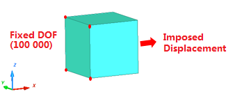

Uniaxial tensile one brick element with imposed displacement and fixed in other side only in X direction.
Figure 2. Problem description
Units: mm, s, Mg, N, MPa

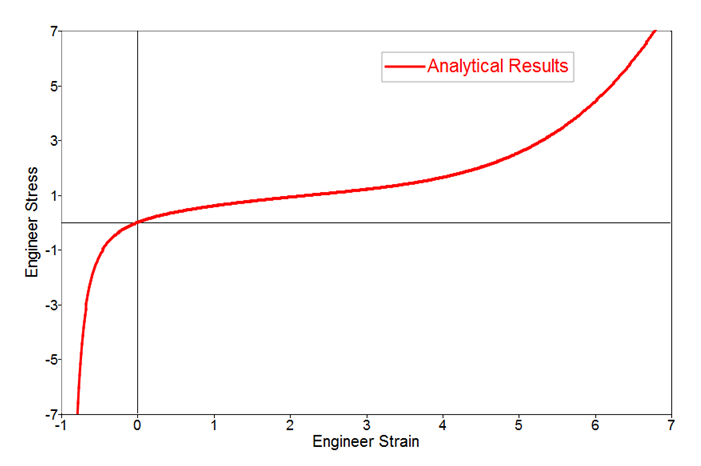

    In this example, three material parameters are defined below: (7) C10=0.18C20=-2e-3C30=5e5
    Figure 3. Engineer stress-strain curve

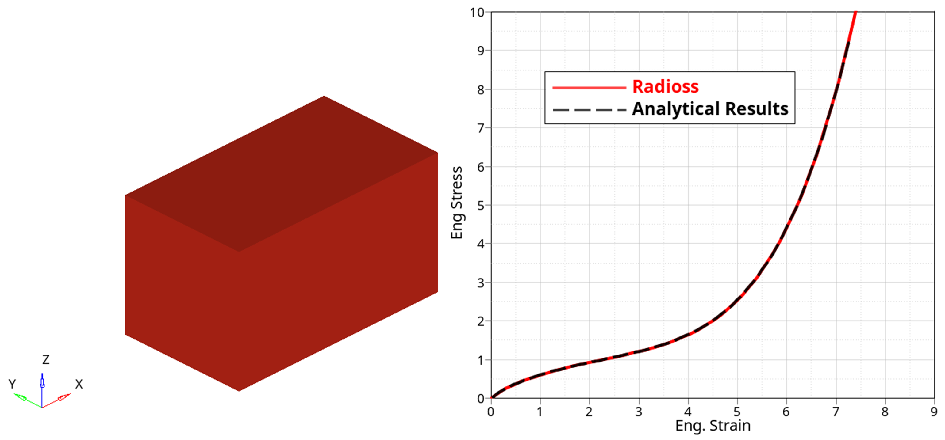

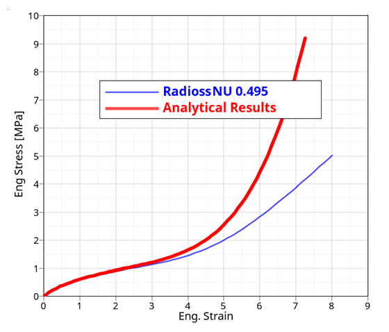

Compare the above results, then show the difference with analytical results especially in high deformed area.
Figure 4.

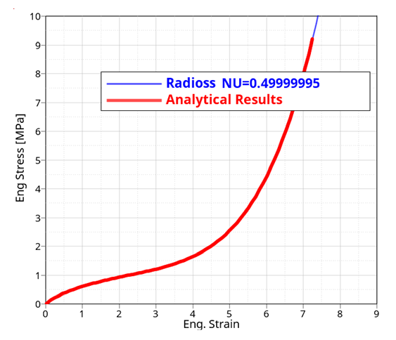

In order to match the incompressible hyperelastic analytical results, the Poisson’s ratio needs to be defined as close to 0.5 as possible, but can not be simply defined as ν=0.5, which will lead to infinite small time step in numerical computation. In this example ν=0.49999995 is used. It shows Radioss results are well matched with analytical results.
Figure 5.
Since material incompressible is assumed in analytical calculation., Poisson’s ratio closer to 0.5 is better, but the computation time will increase. Just one element tension model from ν=0.495 to ν=0.49999995 run time is more than 20 times increased. In this example, use ν=0.4997; therefore, set D1=0.003334.
