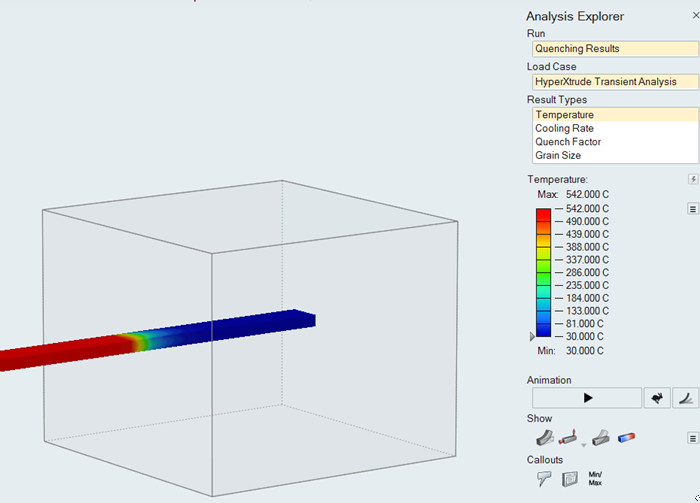

Use the Show Analysis Results tool to view the results of an analysis in the Analysis Explorer. View and animate results, add callouts, and compare results from different runs.
Results must be available before attempting post-processing.

Animation Options
The animation options on the Analysis Explorer allow you to start and stop the animation and adjust basic settings.
Option | Description | |
Play/Stop Animation | ![]() |
Animate the selected result. |
Animation Speed | ![]() |
Change the speed of the animation. |

Result Types
Grain Size |
For advanced applications like automotive and aerospace, it is very important to control grain structure. Uniform and small grain structure leads to higher product strength. Grain size distribution depends on various process parameters, alloy, and die design. Grain size contour represents how the re-crystallization occurs during the extrusion. |
