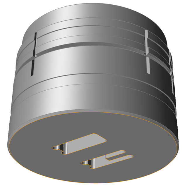

Model contains madrel and die cap. Two hollow profiles are being extruded through this die assembly. Data files are available in the tutorial_models folder in the installation directory in Program Files\Altair\2023\InspireExtrudeMetal2023\tutorial_models\extrudemetal\tutorial-2\.

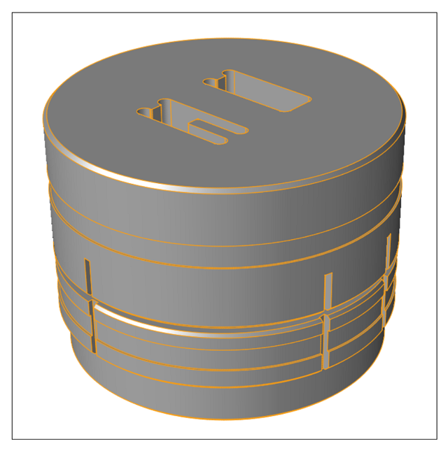

Import and Orient Die Solids

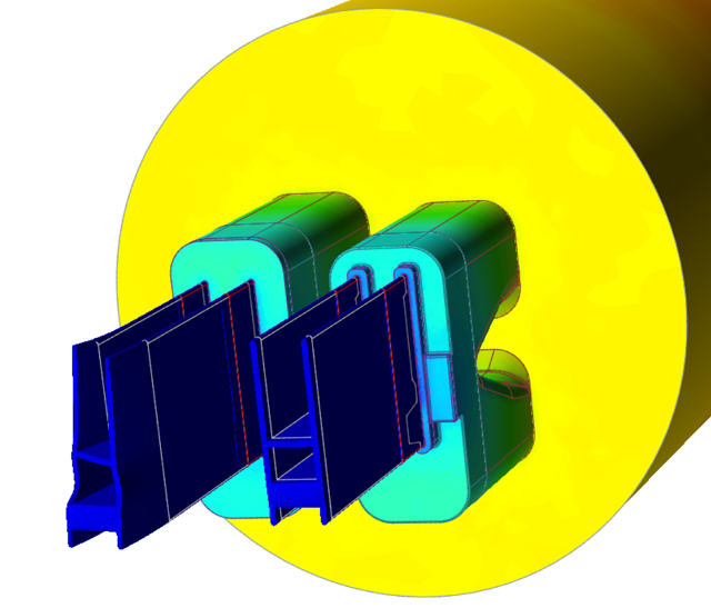

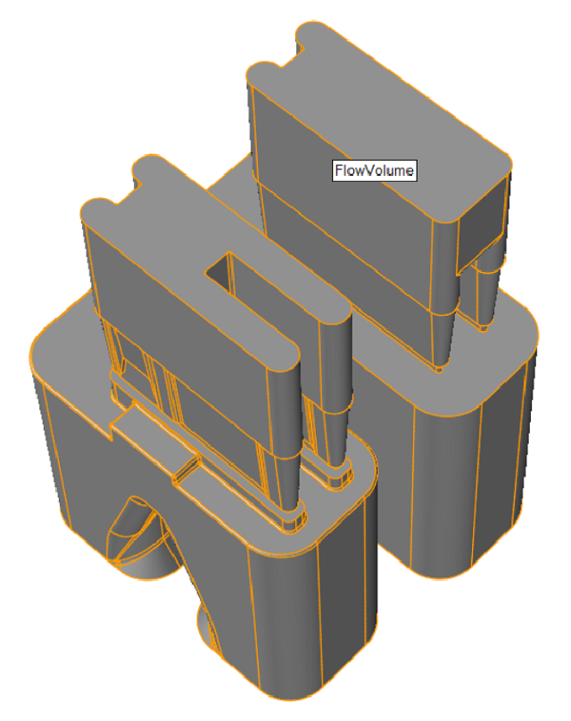

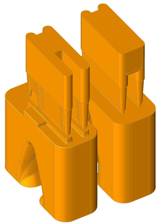

Extract Flow Volume
Click the Flow Volume icon to extract flow volume inside
of the die cavity.
Click and hold left mouse button while you drag a box around all the die solids
as shown.
Release left mouse button to extract flow volume automatically.

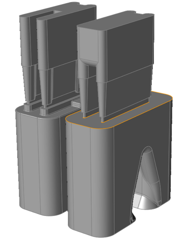

Combine Flow Volume
Hold CTRL and click on each flow solid as shown.
Right-click on either selected solid and click .

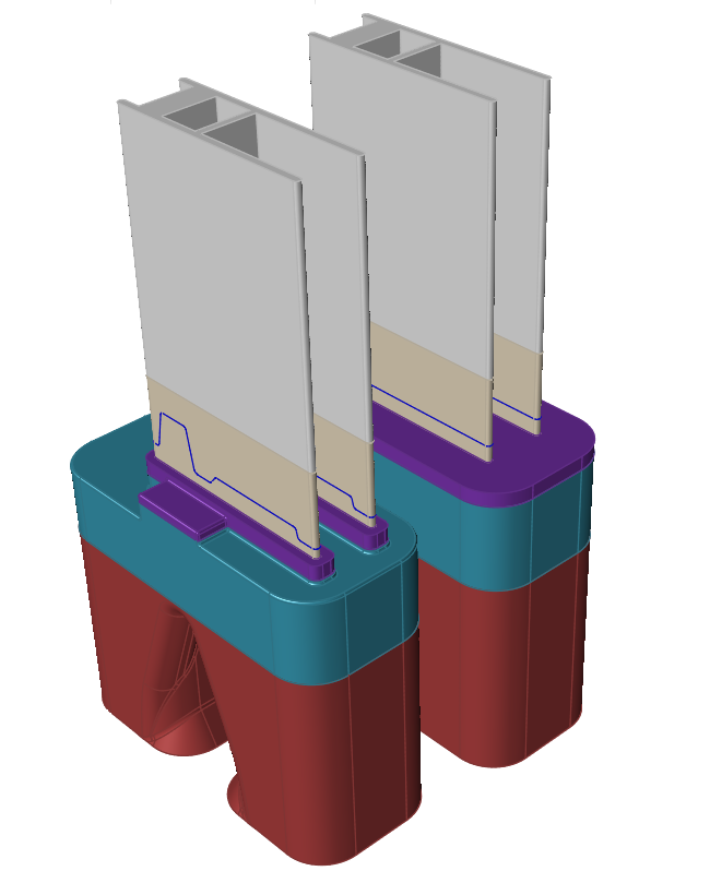

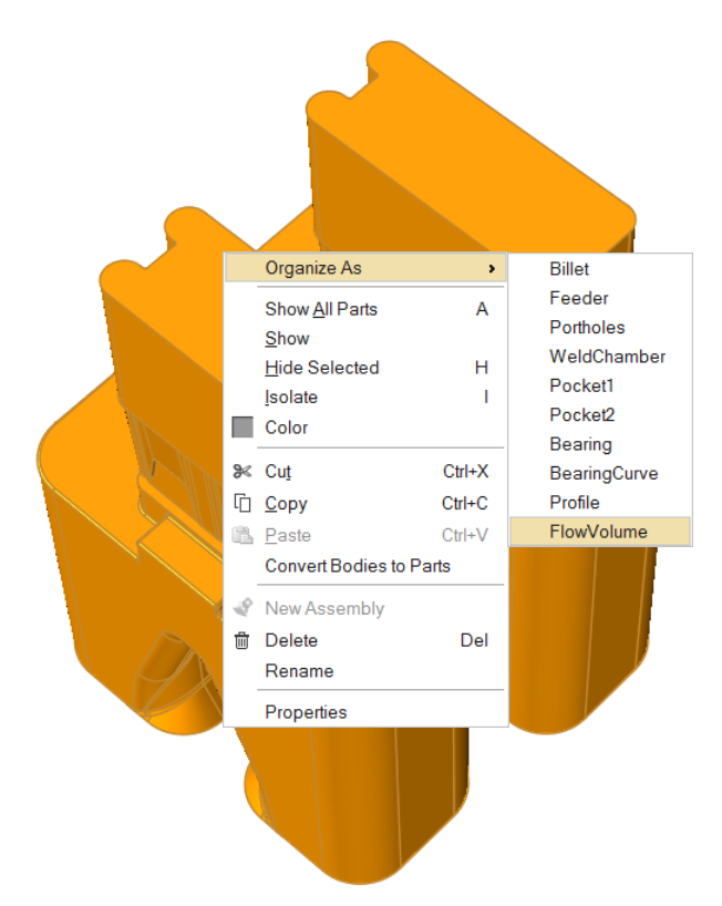

Extract Bearing Region
Organize Flow Volume

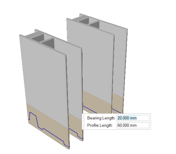

Click the Organize Volumes based on Length Icon.
A micro dialogue will pop up, where you must enter the following
measurements:
- Press OK to close the window.

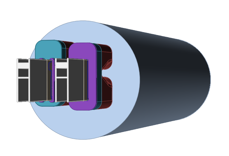

Create the Billet

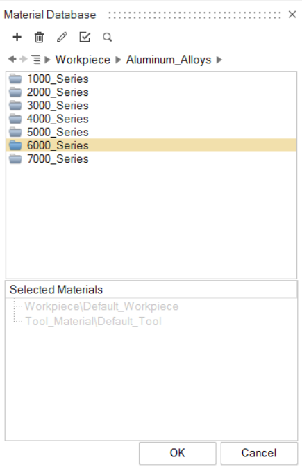

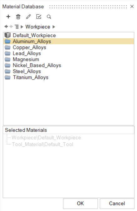

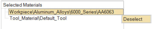

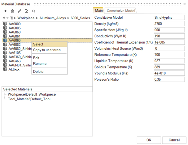

Select the Material

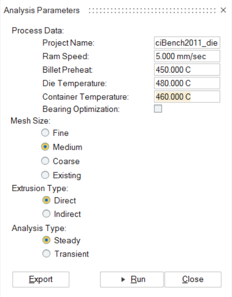

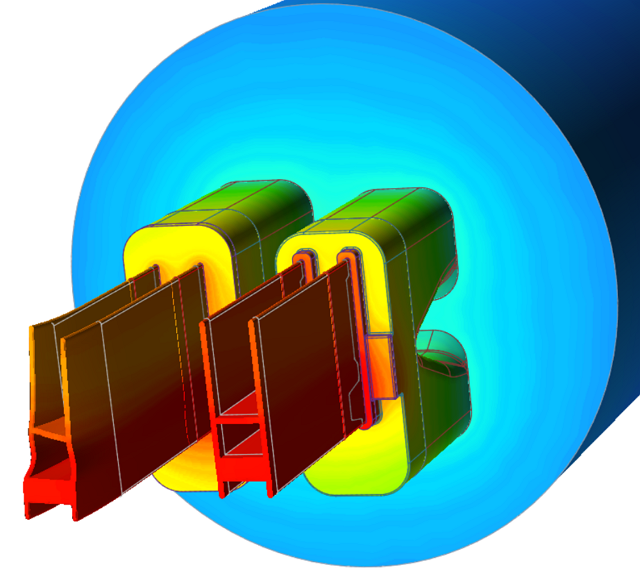

Specify Process Parameters and Simulate
Click theSubmit job for analysis icon to run the
simulation.
In the Analysis Parameters window that pops up, enter
values as shown.
- Click the Run button.
| Status after submitting the job |
| Status after meshing is completed |
| Status when job is running in the solver |
