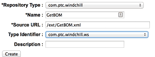

Integrate Inspire Extrude with PTC Windchill™.
To integrate Inspire Extrude with PTC Windchill™, webjects must be installed on the Windchill server as part of the setup process. Windchill versions up to 11.1 are currently supported.
- A valid Windchill username and password
- The full URL for the host server, which can be provided by your Windchill
administrator
Example: Host = http://trwindchill10.altair.com
To integrate Inspire Extrude with Windchill:

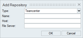

Add a Repository
Add a repository to manage files on your PDM system.
First, you'll need to:
- Integrate Inspire Extrude with your PDM system.
- Obtain the Name, Host, and File Server for the repository, which can be provided by your network administrator

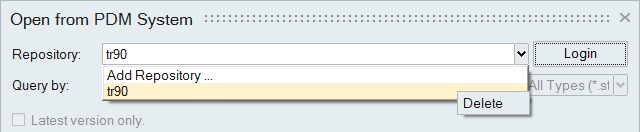

Delete a Repository
Delete a repository when you no longer need it.

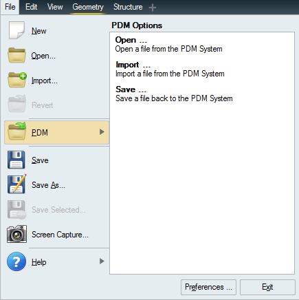

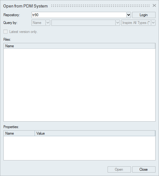

Open a File from Your PDM system
Open a model from your PDM system, or import a saved model from the PDM system and merge it with the current model.
- Add a repository.
- Log in to your PDM system.
- Select Check for updated parts on the Open from PDM System window to automatically refresh the query results. Out-of-date parts are shown in red in the list of files. You can adjust how often to check for updates using the Timer setting under .
- You can select a part, name, or ID you have previously searched for from the drop-down list.

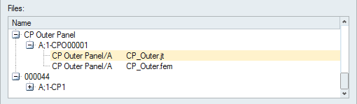

- In Teamcenter, revisions of a file are shown as children under the parent node. In Windchill, the parent node is a container. The actual file and all of its revisions are listed under the container node.

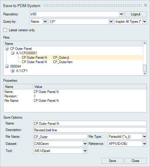

Save a File to Your PDM System
Save a file to your PDM system.
- Add a repository.
