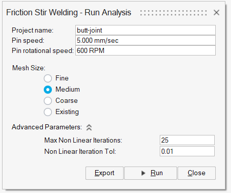

- Launch HyperXtrude solver to run friction stir welding analysis

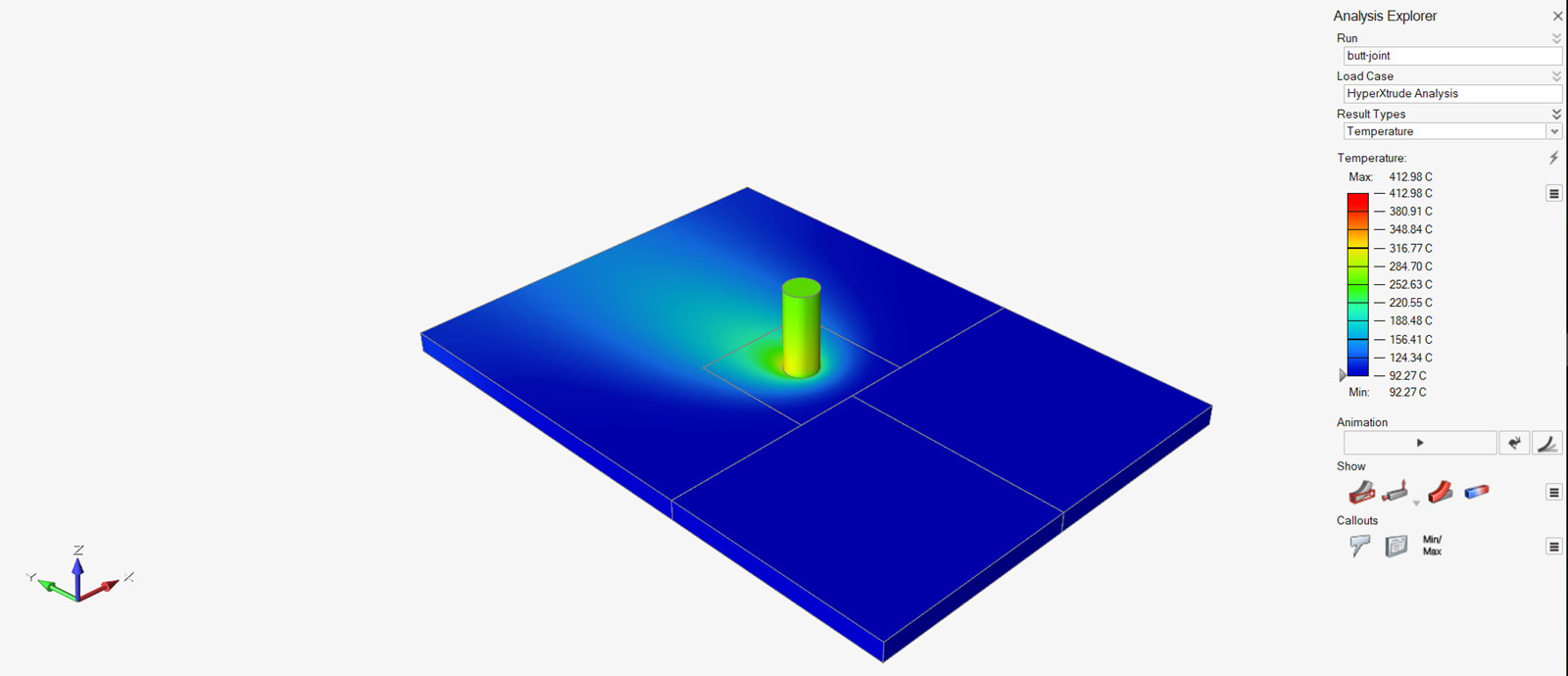

- Post process the results

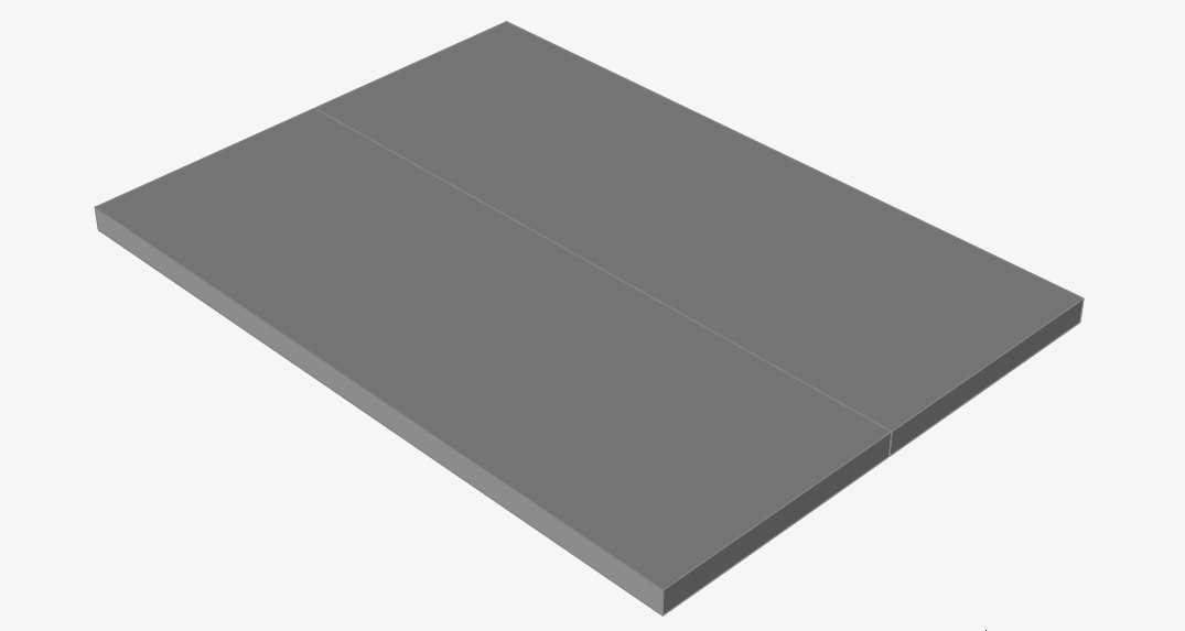

Open the Tutorial Model
Data files are available in the tutorial_models folder in the installation directory in Program Files\Altair\2023\InspireExtrude2023\tutorial_models\fsw\tutorial-1\.

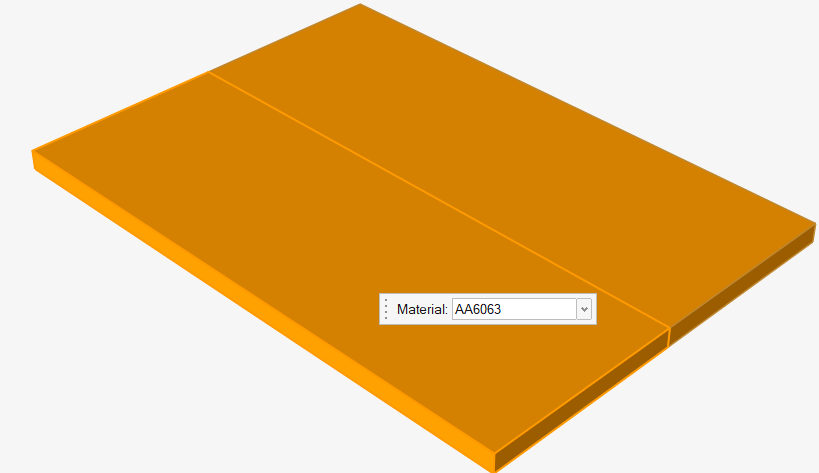

Select Materials

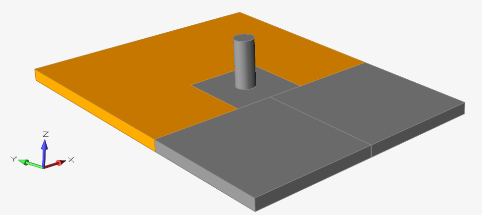

Identify the Plates

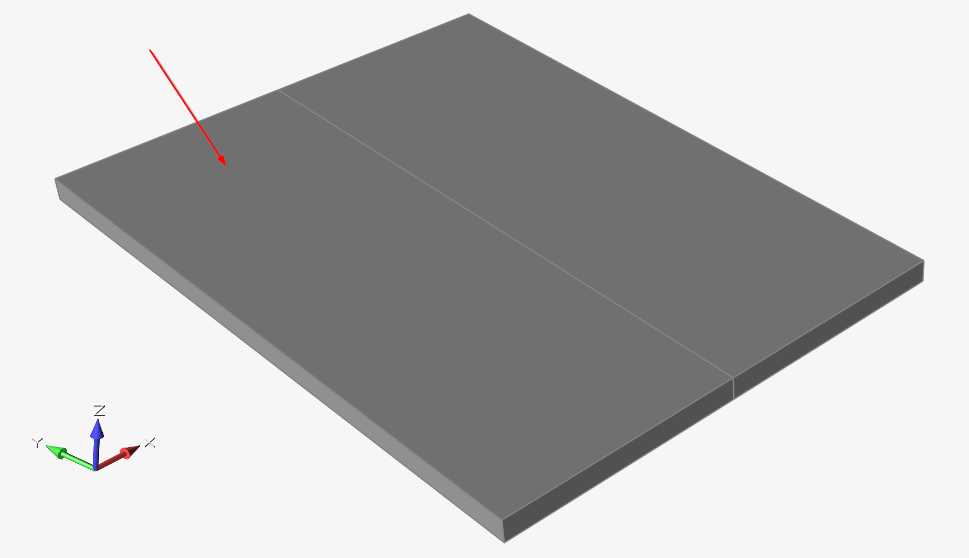

Orient the Model

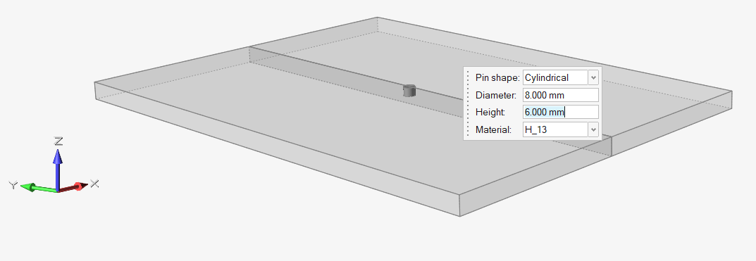

Create the Pin

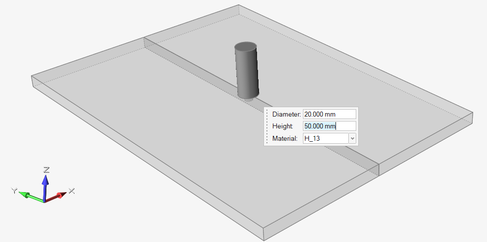

Create the Shoulder

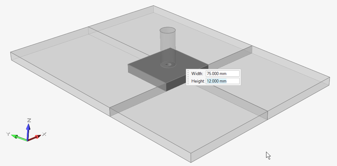

Create HAZ
