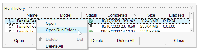

Where are the Run Files?
Where Is the Clamp Force Result?
The clamp force result is in the file c2mRun.out in the Run folder.
