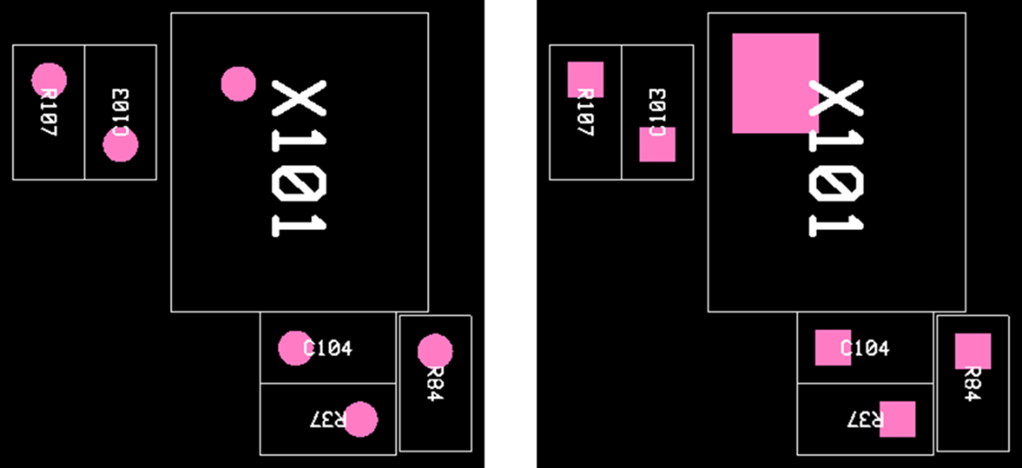

- First Pin: Mark the first pin position.
- First Pin-Pad Max Area: The first pin pad is marked with a pink
solid rectangle. If not selected, it displays as shown in the left
picture.

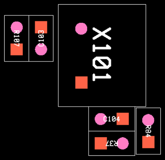

Figure 1. - Second Pin: Mark the second pin location.
Figure 2. - Pin PAD Scale: Set the marking size of the first and second pins.

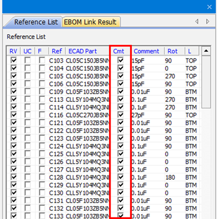

- Reference Name: Select whether to display the reference name.
- Part Name: Select whether to display the part name.
- Property Selection: Select whether to display the property information.
- Part Comment: Select a part property to display.
- Reference Comment: Select a reference property to display.

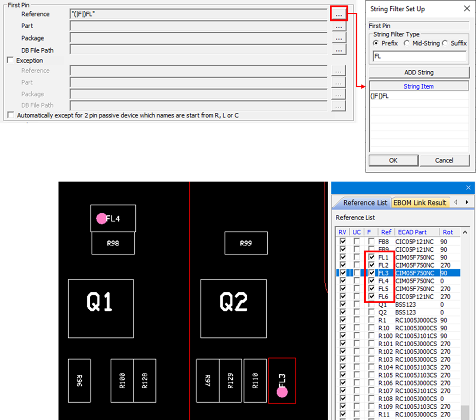

Pin Display Settings
Define pin settings.
Figure 4.
- Exception: Select a part that excludes the first pin marking.
- Automatically except for 2pin passive device which names are start from R, L, or C: Exclude the two-pin passive device automatically, which starts with R, L, and C.
User-Defined Pin
- Table
- Filter Type: Specify the filter type as either DB file or part name.
- Filter/DB File Path: Specify the filter condition or part DB file path by double-clicking the column.
- Pin Name: Specify the pin name to display as the first pin.
- Add: Add a new item to the table.
- Delete: Delete a selected item from the table.
- Edit DB: Edit a selected DB file by running the Edit Component DB. Refer to the [Appendix] Edit Component DB in this manual.

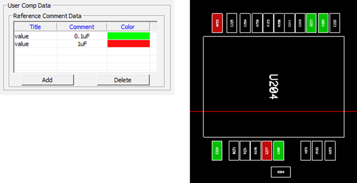

User Comp Data
Figure 6.
Component Group Color
- Select Type of Component Group: Select a type to define a component group among Reference Name, Part Name, Package Name, and Component DB.
- Component Group Content: Set the string filter for defining the component group.
- In the above example, parts starting with the reference name C are in a component group.
- When you select the Select Type of Component Group as DB, you can load a pre-defined component DB file from your computer. For more detailed information on how to create or edit a DB file, refer to Appendix Edit Component DB in this manual.
- Property: Display the property information of the selected component group.
- Default Comment: Enter the title of the property information to be displayed.
- Alternative Comment: To display the alternative component information, select the title of the property.
- Display Component List from User Selected Property: Create a list based on the property value and directly select whether to highlight the component.
- Visible Property in Component: Display the property value specified in the component area.
- Fill: Define the highlight color of the component.
- Display User Comment: Select whether to display the comment for the specified component group.

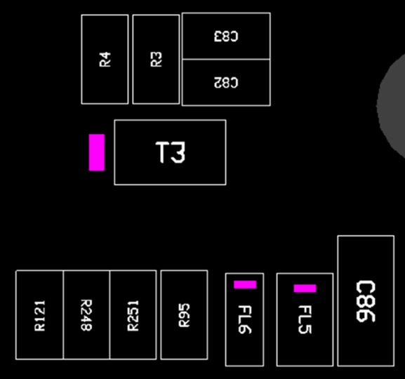

User Defined Polarity Marking
- Marking Type: Select the shape of the polarity mark.
- Point: Display the polarity mark in dot. Marking position is selected among Left Top, Left Bottom, Right Top, Right Bottom, Top, Bottom, Left, Right, First Pin, or Second Pin.
- Bar: Display the polarity mark in bold lines. Marking position is selected among Top, Bottom, Left, Right, First Pin, or Second Pin.
- Arrow: Display the polarity mark in arrows. Marking position is selected either Left or Right.
- Position: Select where the polarity mark is placed. Marking position varies depending on the marking type.
- Filter Type: Set the filter type to designate the component group to display the polarity mark, which is selected among reference, part, package, or DB file.
- Filter/DB File Path: If the filter type is reference, part, or package, you can select the part having the specified string through the string filter function. If the filter type is DB file, you can select the pre-defined component DB file. For more detailed information how to create or edit a DB file, refer to [Appendix] Edit Component DB in this manual.
