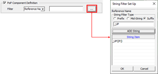

- PoP Component Definition: For parts with high component densities, such as
mobile phones and digital cameras, a package on package (PoP) design is
sometimes applied. Option to check if the position of pin 1 of the upper
part of the PoP is the same as the position of pin 1 of the lower part.
- Filter: Sets through the string filter to recognize the top part of
the POP from the mount data.
Figure 1. - In the above example, the part with the same reference name and the suffix _UP is recognized as the top material of the PoP. For example, if U100 parts and U100_UP parts exist in the mounting data, U100 parts are recognized as lower parts and U100_UP parts as upper parts.

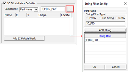

Fiducial Parameters
- IC Fiducial Mark Definition: Sets location and shape of IC fiducial mark on
board.
- Component: When the IC fiducial mark is designed as a component on the PCB design, it can be recognized using a string filter.
- String Filter: Selects String Filter Type from prefix, mid-string,
suffix, and input the string for part recognition. The example below
means that the part name on the PCB design recognizes all parts
starting with IC_FID.

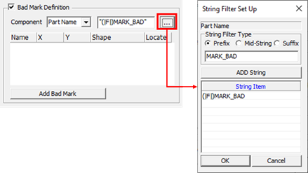

- Bad Mark Definition: Sets location and shape of bad mark on board.
- Component: When the bad mark is designed as a component on the PCB design, it can be recognized using a string filter.
starting with MARK_BAD.
