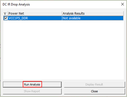

DC IR Drop Analysis
- Note : DC IR Drop value is possible to obtain a negative (-) voltage
drop value but this usually indicates an error in the simulation setup
or the circuit being simulated.
If a negative value is obtained for DC IR drop, it could be caused by a mistake in the simulation setup, such as an incorrect placement of voltage sources or ground connections, or an incorrect sign of the resistance values. It could also be caused by a problem in the circuit being simulated, such as an unintended feedback loop that is boosting the voltage.
For example, the voltage source is fixed as 0.8V and the user set the operation current as 30A supplying the specific IC chip. In this case, these electrical design is possible to get error and the negative (-) value of voltage drop can be shown in the result display DC IR Drop analysis.

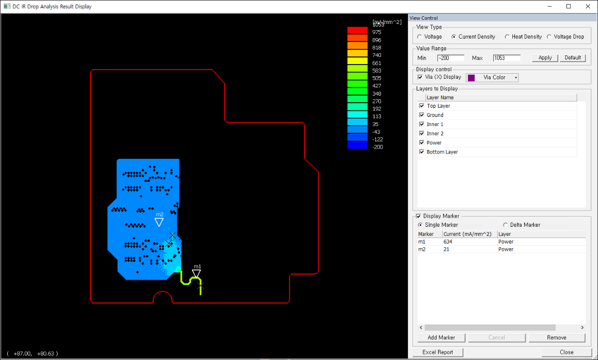

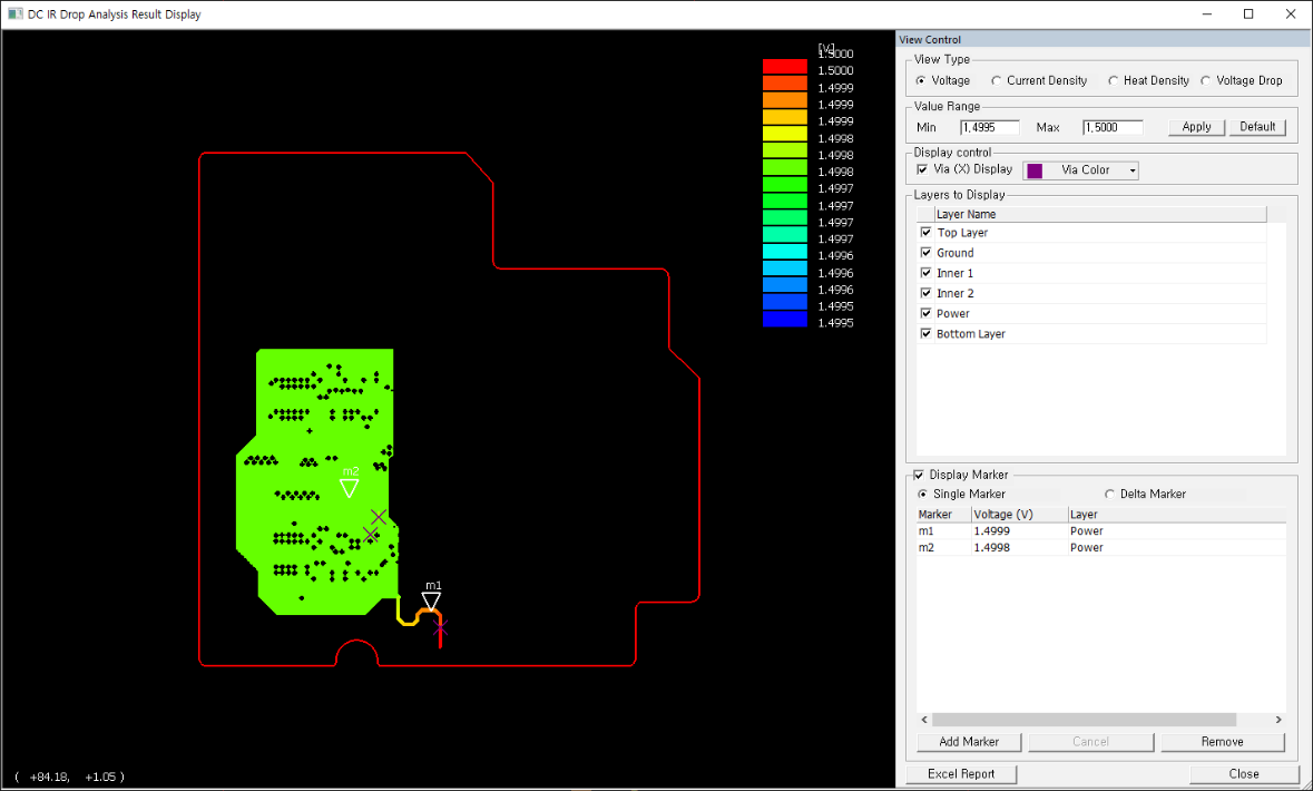

Figure 2. Voltage View
Figure 3. Current Density View

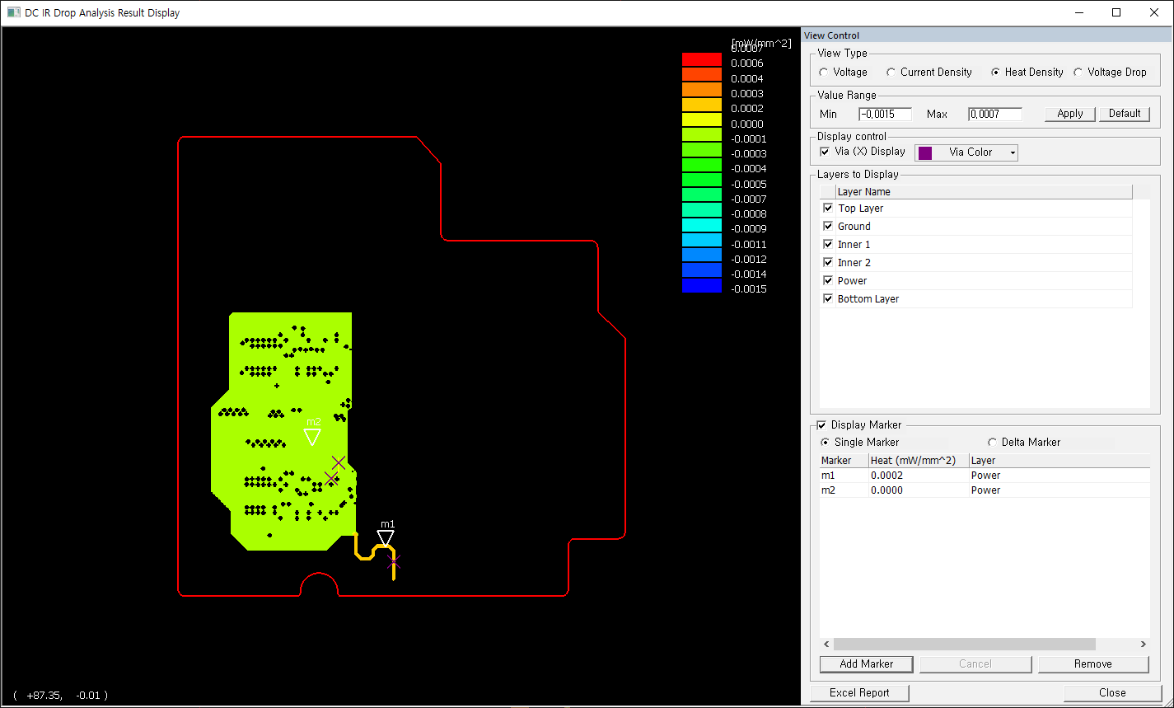

Figure 4. Heat Density View
