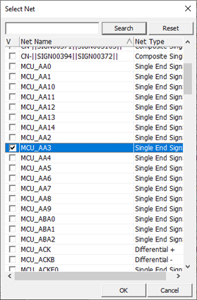

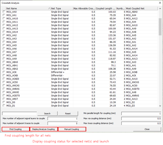

Crosstalk Analysis menu allows you to analyze the crosstalk effect among closely coupled nets. Upon selecting the menu entire signal nets are listed. In certain degree entire nets in the PCB design have crosstalk coupling with each other. However, it is not only practical but also not necessary to analyze a lot of coupled nets together since crosstalk noise between far apart lines or short parallel lines is not significant. Separation amount and parallel line length are used as criteria for identifying closely coupled nets for the analysis. The crosstalk coupling control parameters include the maximum number of adjacent signal layers, maximum number of adjacent traces, minimum parallel trace length, maximum parallel via distance, and maximum parallel trace distance.
Figure 3.

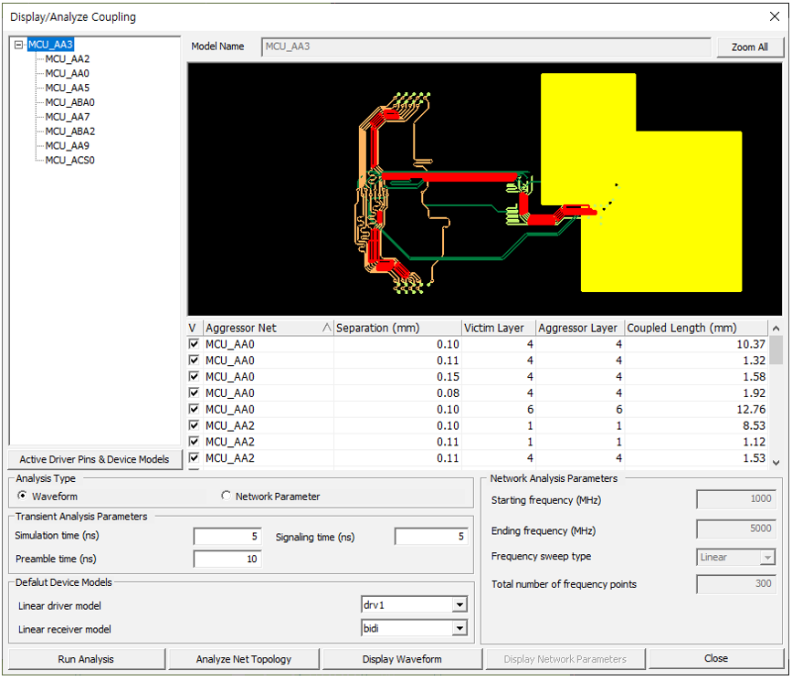

Active Driver Pins menu allows you to select active driver pins of the coupled nets. To make a net quiet, NONE must be selected for the active driver pin selection. You can define the input signal and make changes on the device model selection for driver and receiver pins of each coupled net by clicking Input Signal and Device Models, respectively.
Figure 4.

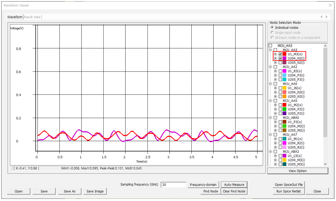

From the menu bar, click to execute waveform and network parameter analysis for the selected net(s) considering the coupling effects by neighboring nets. When you specify the victim net, the strongly coupled nets are automatically screened through whole PCB layers. The coupling parasitic will be extracted and configured as SPICE circuit for the crosstalk analysis.
Depending on the selected victim net, the screened aggressor nets and victim net are automatically displayed for exploring the location. Several parameters in the Crosstalk Analysis Parameters laid in Electrical Analysis Constraints, will work to fine the mostly coupled nets to the selected victim net.
