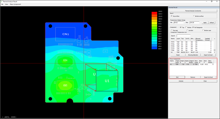

- Select component outline, reference designator, and temperature display options. In addition to the graphical display, component temperature values are listed in a table.
- Move Component
- Use to see the thermal effect of relocating components. Start is used to initiate moving individual components. The relocated components are listed in the table. End is used to exit from the component moving operation.
- Analysis
- Use to re-run thermal analysis.
