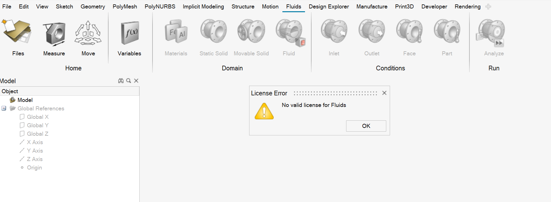

When you select a tab on the ribbon and the following license error message is
displayed, you should check in specific license features to draw sufficient Altair units.

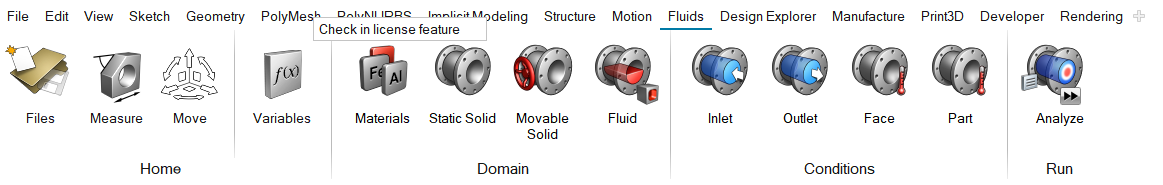

To check in specific license features:
Exit from the tab you want to check in by selecting a different ribbon
tab.
Right-click the tab you want to check in, and then select Check in
License Feature.
Figure 1. Example: Checking in the PolyMesh tab. In this example, we selected the Fluids tab to exit from the PolyMesh
tab. Then we right-clicked the PolyMesh tab to select Check
in license feature.

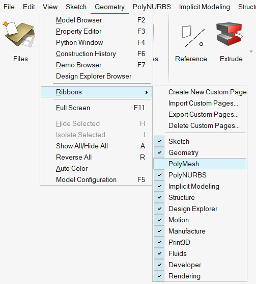

Or you can check in a license feature by hiding the tab
altogether. From the View menu, select
Ribbons, then turn off the tab you want to check in and
hide.
