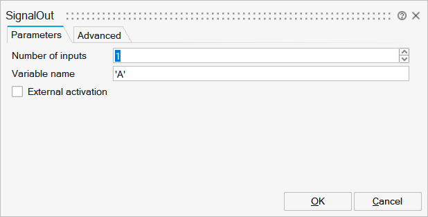

nin | Number of inputs | Number of inputs. Integer value. | Number | |
varname | Variable name | Name of the OML variable to be set in the OML workspace. | String | |
externalActivation | External activation | Specifies whether the block receives an external activation or inherits its activation through its regular input ports. When External Activation is selected, an additional activation port is added to the block. By default, external activation is not selected. | Number | 0 |

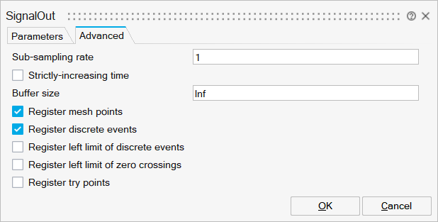

subsample | Sub-sampling rate | Sub sampling rate should be greater than 1. | Scalar | |
increasingTime | Strictly-increasing time | If enabled, a strictly-increasing time sequence will be created. | Number | 0 |
buffsize | Buffer size | Size of the buffer (gives the total number of samples recorded during the simulation). This is a circulate buffer. Integer value. 0 for an unlimited buffer. Default size is 128. | Scalar | |
R_MP | Register mesh points | Register the continuous time step. Event code is 0. | Number | 0 |
R_DE | Register discrete events | Register the discrete time event. Event code is 1 | Number | 0 |
R_MPLL | Register left limit of discrete events | Register the event just before a discrete event. Event code is -1. | Number | 0 |
R_ZCLL | Register left limit of zero crossings | Register the event just before a zero crossing event. Event code is 4. | Number | 0 |
R_TRY | Register try points | Register the events in try phase. Event code is 2 or 3. | Number | 0 |
