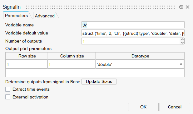

varnam | Variable name | Name of the variable in the OML workspace. | String | |
defvalue | Variable default value | Value used in case the variable is not defined in the OML workspace.Default is set to struct('time',0,'ch',{struct('type','double','data',[0])}) | ||
nout | Number of outputs | Number of outputs, equal to the number of channels in the cell "ch". | Number | |
outports | Output port parameters | Structure | ||
outports/outrow | Row size | Cell of scalars | ||
outports/outcol | Column size | Cell of scalars | ||
outports/ot | Datatype | Cell of strings | 'double' | |
outevent | Extract time events | This parameter defines if the block generates an activation event. When OutEvent is used, a additional event output port is added to the block. default is OFF. | Scalar | 0 |
externalActivation | External activation | This parameter defines if the block receives an external activation or inherits. When External Activation is used, a additional activation port is added to the block. default is OFF. | Number | 0 |

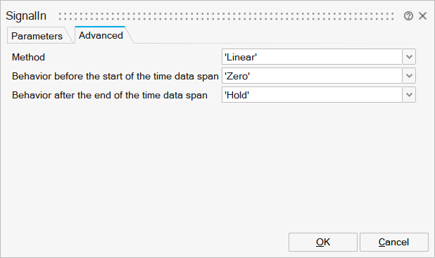

Method | Method | String | 'ZeroOrder(floor)' | |
Leftside | Behavior before the start of the time data span | String | 'Zero' | |
Rightside | Behavior after the end of the time data span | String | 'Zero' |
