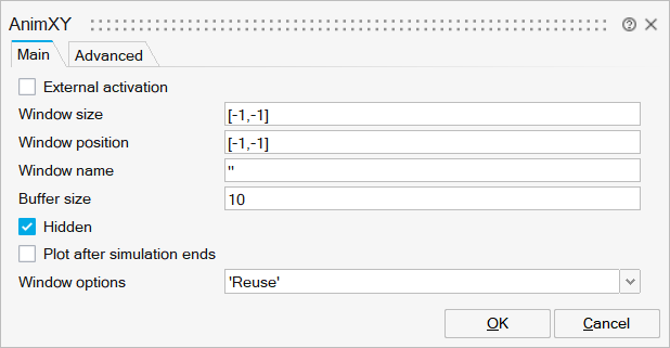

externalActivation | External activation | Specifies whether the block receives an external activation or inherits its activation through its regular input ports. When External Activation is selected, an additional activation port is added to the block. By default, external activation is not selected. | Number | 0 |
winSize | Window size | X,Y dimension of the plot window. Integer values. Default size is given as [-1,-1] and corresponds to [400,400]. | Vector of size 2 | |
winPos | Window position | X,Y position of the plot window. Integer values. Default [-1,-1] indicates the window is positioned automatically. | Vector of size 2 | |
winNam | Window name | Name of the plot window. String. Default is empty. | String | |
bufferSize | Buffer size | Size of the buffer. Integer value. Default 10. | Scalar | |
winHidden | Hidden | The window is hidden initially by default. | Number | 0 |
showAtEnd | Plot after simulation ends | Display the plots (lines) at the end of simulation instead of progressively along with simulation time. | Number | 0 |
option | Window options | Define the scope window setting for a simulation. Default is 'Reuse'. - 'Reuse': An initial simulation plots results in a scope window. Subsequent simulations plot results in the same window, but any existing data is erased. - 'Overlay': An initial simulation plots results in a scope window. Subsequent simulations plot results in the same window. Existing plots are retained. - 'New': Each simulation creates a new scope window. - 'Recreate': Each simulation produces a new scope window, and the existing scope window is deleted. | String | 'Reuse' |

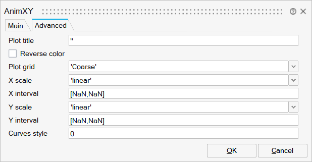

plotTitle | Plot title | String | ||
plotColor | Reverse color | Number | 0 | |
plotGrid | Plot grid | String | 'No | |
xScale | X scale | String | 'linear' | |
xInterval | X interval | Vector of size 2 | ||
yScale | Y scale | String | 'linear' | |
yInterval | Y interval | Vector of size 2 | ||
curvesStyle | Curves style | Vector |
