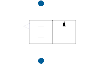

Extends from HydraulicsByFluidon.Components.Valves.Base.PartialValveBase_x2
and HydraulicsByFluidon.Components.Valves.Base.PartialValveHyd_2x
Type | Name | Default | Description |
Boolean | enableStrokeOut | false | Enable Stroke Output |
VolumeFlowRate | NominalVolumeFlow | 5e-4 | Nominal volume flow |
Pressure | NominalPressureDifference | 500000 | Nominal pressure difference |
Density | ReferenceDensity | 860 | Reference density for volume flow and pressure difference |
DimensionlessRatio | Overlap | 0 | Valve edge relative overlap |
Boolean | tableFromFile | false | Table is provided by file |
String | fileName | "NoFile" | File where look-up table is stored |
String | tableName | "NoTable" | Table name on file |
Real | manualTable[:,:] | [0,0; 1,1] | Manually provided look-up table |
VolumeFlowRate | ZeroVolumeFlow | 0 | Volume flow due to leakage |
Pressure | ZeroFlowPressureDifference | 500000 | Pressure difference for leakage flow |
Volume | deadVolume | 1e-6 | Dead volume at ports |
Connectors
Type | Name | Description |
FluidPort | portA | Hydraulic port A |
FluidPort | portP | Hydraulic port P |
output RealOutput | valveStrokeOut | Valve Stroke |
