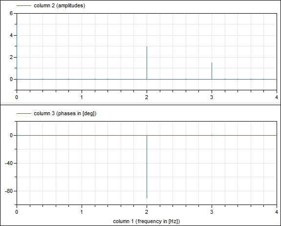

Model Modelica.Math.FastFourierTransform.Examples.RealFFT1
In this example the signal y
y = 5 + 3*sin(2*pi*f1) + 1.5*cos(2*pi*f2)
is sampled and an FFT is computed from the sampled signal (default: f1 = 2 Hz, f2 = 3 Hz). In the public part the FFT is stored up to f_max (internally in the protected part the FFT is stored up to 5*f_max). With the default values for f_max (= 4 Hz) and f_resolution (= 0.2 Hz), the following results are achieved:
fi[0] = 0, Ai[0] = 5; // mean value of signal fi[11] = 2, Ai[11] = 3; // frequency/amplitude of sine fi[16] = 3, Ai[16] = 1.5; // frequency/amplitude of cosine
A plot of the resulting FFT is shown in the next image:
Note, phases of small amplitudes (= smaller as 0.0001*maximalAmplitude) are explicitly set to zero, since the corresponding "phase" is numerical noise (and would just be confusing). Furthermore, note that the FFT phases are with respect to a cos(..) signal.
