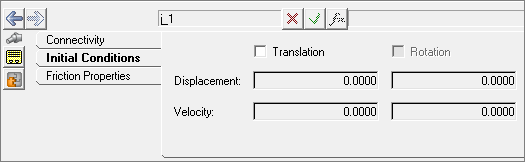

  3. Insert a translational joint, label it CartTranslation, and set the Connectivity parameters as follows:
  4. Set the Initial Conditions as follows:

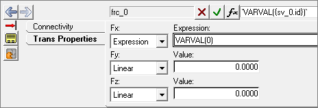

  1. Create two solver variables: ControlForce (varname: sv_0) and PivotTorque (varname: sv_1) as follows:
  2. Connect the two solver variables to the forces you created in the previous section, Adding Forces.
    As you see in the following figure, on the Trans Properties tab for ControlForce, for Fx, select Expression, and for f, enter: VARVAL({sv0.id}). This expression specifies the ControlForce to be the first solver variable, sv_0. This variable sets the control signal sent from Twin Activate to be the control force acting on the translational joint of the Cart.
  3. Verify that the varnames match (sv_0): From the Expression Builder, select the solver variable by name and enter its ID as you see in the following figure:

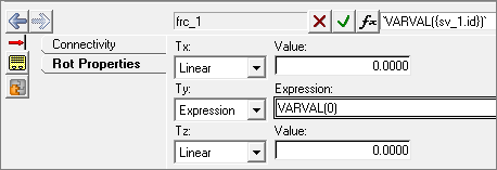

  4. On the Rot Properties tab for PivotTorque, for Ty, select Expression, and then for f, enter:VARVAL({sv1.id}). This expression sets the PivotTorque as the second solver variable, sv_1, which specifies the control signal sent from Twin Activate as the torque acting on the rotation of the pendulum.
