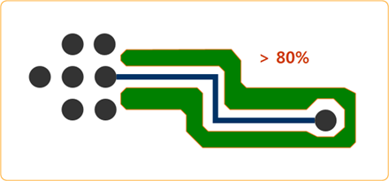

Complete Shield
This item checks for a shielding ratio on design. Ground shielding should consider the effect on impedance change.

- Max: Specify maximum distance from differential pair net to ground. The DFE searches shielding net within this range.
- Min: Specify minimum clearance from net to ground. If shield net exists closer than this clearance, it reports fail.
- Min Horizontal Shield Ratio(%): Minimum shielding net length ratio against total net. If the shielding ratio is smaller than the given value, it is reported as failed. (Ratio = The total length of shielded portion of net/Total length of net)

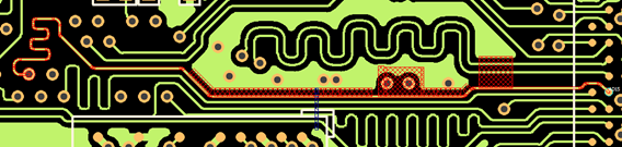

V-Shield Check
- Vertical Shield Ratio Check:
- Shield Distance (Extended V-Shield Width): Specify minimum required GND width of upper/below layer.
- Min Vertical Shield Ratio(%):Minimum ground shielding ratio. If the shielding ratio is smaller than the given value, it is reported as failed. (Ratio = Shield Area/Net Area)
- Shield Ratio Calculation Type: Determine test layer.
- All Layer: Calculate shield ratio for total net.
- Per Layer: Calculate shield ratio per each layer.
- Inner Layer: Calculate shield ratio for internal layer only.
- Exclude/Include Option
- Check Layer:
- L1 Layer: check one layer above and below.
- L2 Layer: check two layers above and below.
- L2-Hop Layer: check two layers, one layer apart above and below.

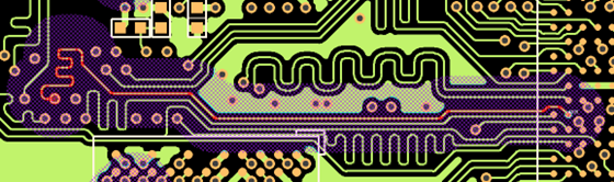

Figure 3. Check layer - Pin Escape: Enter a radius of circular region around pins to be excluded for the rule check.
- Via Escape: Enter a radius of circular region around vias to be excluded for the rule check.
- Exclude Short Pattern: Exclude the short length trace shorter than this value.
- Consider both upper and lower direction: Upon selecting, above and below layer will be tested if not wider layer side will be checked (above or below)
Figure 4.
If there are ground planes on adjacent layers, shielding ground on the signal layer may alter impedance when it is too close to the signal trace. The effect of ground shielding on impedance change needs to be carefully considered.
The shielding must be done at the same distance on both sides of signal trace. If there is a shielding ground only on one side, it may cause EMI problems.
Ground shielding not only provides solutions for EMI but also reduces return path.
