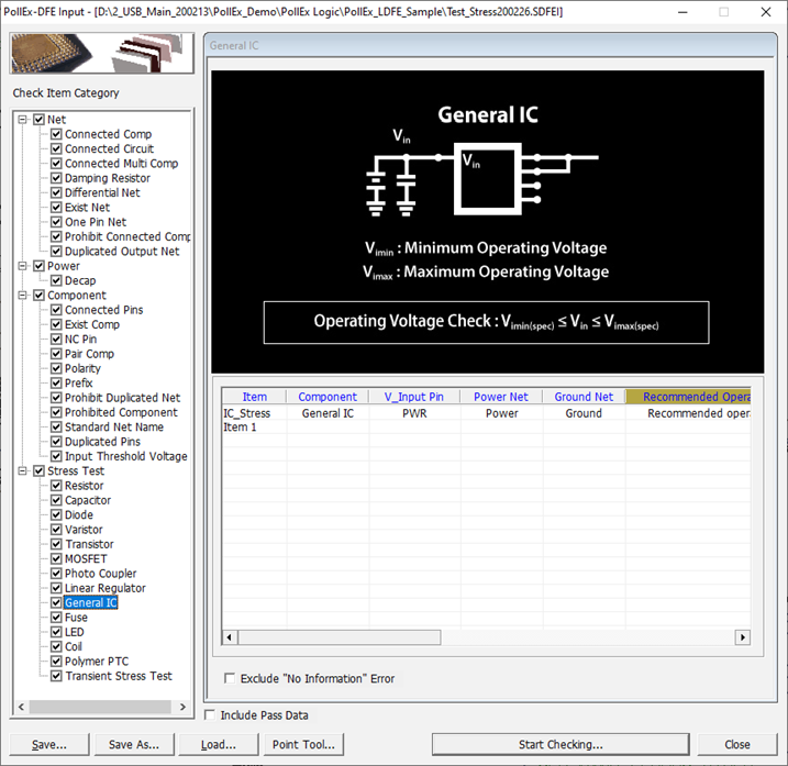

General IC
This item tracks the voltage and signal lines in the circuit, calculates the voltage value of each net, and checks whether the all general IC connected to the net is within the allowable voltage range.
- Vin_min ≤ Vin ≤ Vin_max (if it passes, 'V_In Pass' displays in the result table)
- Vin ≤ Absolute Maximum (if it passes, 'Absolute_V_In Pass' displays in the result table)
- Component: Select General IC component group to be checked.
- V_Input Pin:
Assign power input pin information of regulator. You can assign pin number
using Pin Number or Pin Property which contain pin number information.
Figure 2. - Power Net: Select power net group to which General IC components are connected.
- Ground Net: Select ground net group to which General IC components are connected.
