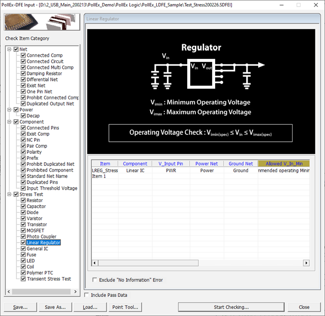

Linear Regulator
This item tracks the voltage and signal lines in the circuit, calculates the voltage value of each net, and checks whether the all linear regulator connected to the net is within the allowable voltage range.
- Vin_min ≤ Vin ≤ Vin_max (if it passes, 'V_In Pass' displays in the result table)
- Vin ≤ Absolute Maximum (if it passes, 'Absolute_V_In Pass' displays in the result table)
- Component: Select Linear Regulator component group to be checked.
- V_Input
Pin: Assign power input pin information of regulator. You can assign pin
number using Pin Number or Pin Property which contain pin number
information.
Figure 2. - Power Net: Select power net group to which Linear Regulator components are connected.
- Ground Net: Select ground net group to which Linear Regulator components are connected.
- Allowed
V_In_Min: Set the allowable minimum power input voltage of this component.
You can set this by entering the allowable value directly or select the
property name which contain allowable value.
Figure 3. - Allowed
V_In_Max: Set the allowable maximum power input voltage of this component.
Figure 4. - Absolute
Maximum[V]: Set the allowable absolute maximum power input voltage of this
component. You can set this by entering the allowable value directly or
select the property name which contain allowable value. You can also assign
tolerance of this test.
Figure 5.
