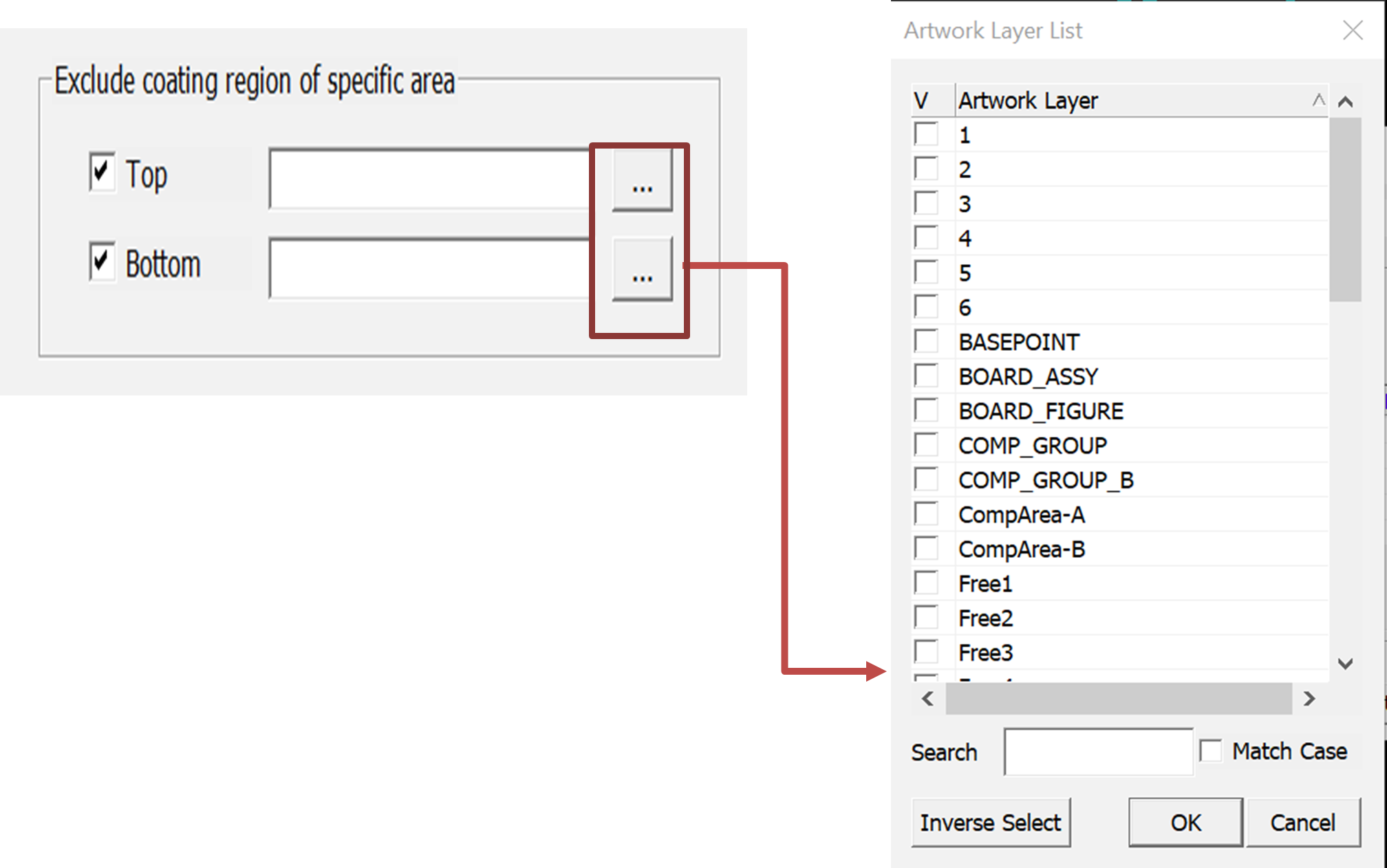

- Exclude coating region of specific area - This excludes specific layers in
the drawn object areas from analysis. You can choose which region of the
design to exclude between the TOP and BOTTOM layers.For either the TOP or BOTTOM region a specific area can be selected using the artwork layer list dialog bar.
- Artwork layer: Lists all the areas that are coated in the design by layer.
- Search: Looks for a specific area using it name.
- Match Case: Specifies all areas in accordance with the search name.
- Inverse Select: Selects all the areas displayed in the artwork layer dialog bar.

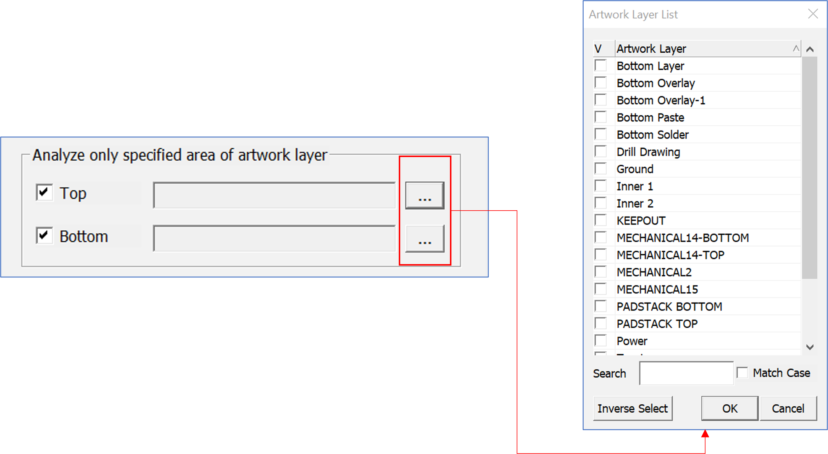

- Analyze only specified area of artwork layer - This selects specific areas
in artwork layers to analyze. You can choose which area of the artwork
layers of the design to analyse between the TOP and BOTTOM layers.The specific area for analyse required is selected as displayed below.

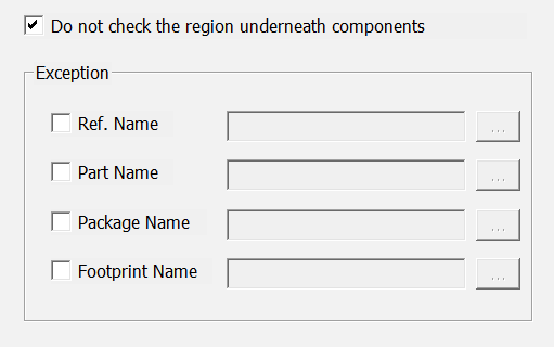

- Do not check the region underneath components - This option excludes the
component outline domain from analysis.
You can choose which Component to Exempt from the Options feature using the Name Categories, Ref. Name, Part Name, Package Name, and Footprint Name.

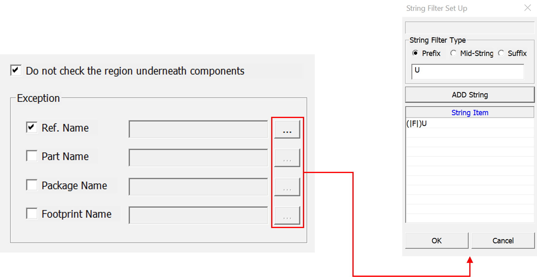

Figure 3. - Each component category to be exempted will be selected using the String
Filter Set Up.
Figure 4.
- Prefix - Net name starts with the given string
- Mid-String - Given string is in the net name
- Suffix - Net name ends with the given string
- Add String - Adds the defined conditions of the string filter and string filter type into the string item list.
- String Item- Displays strings added as a list.
