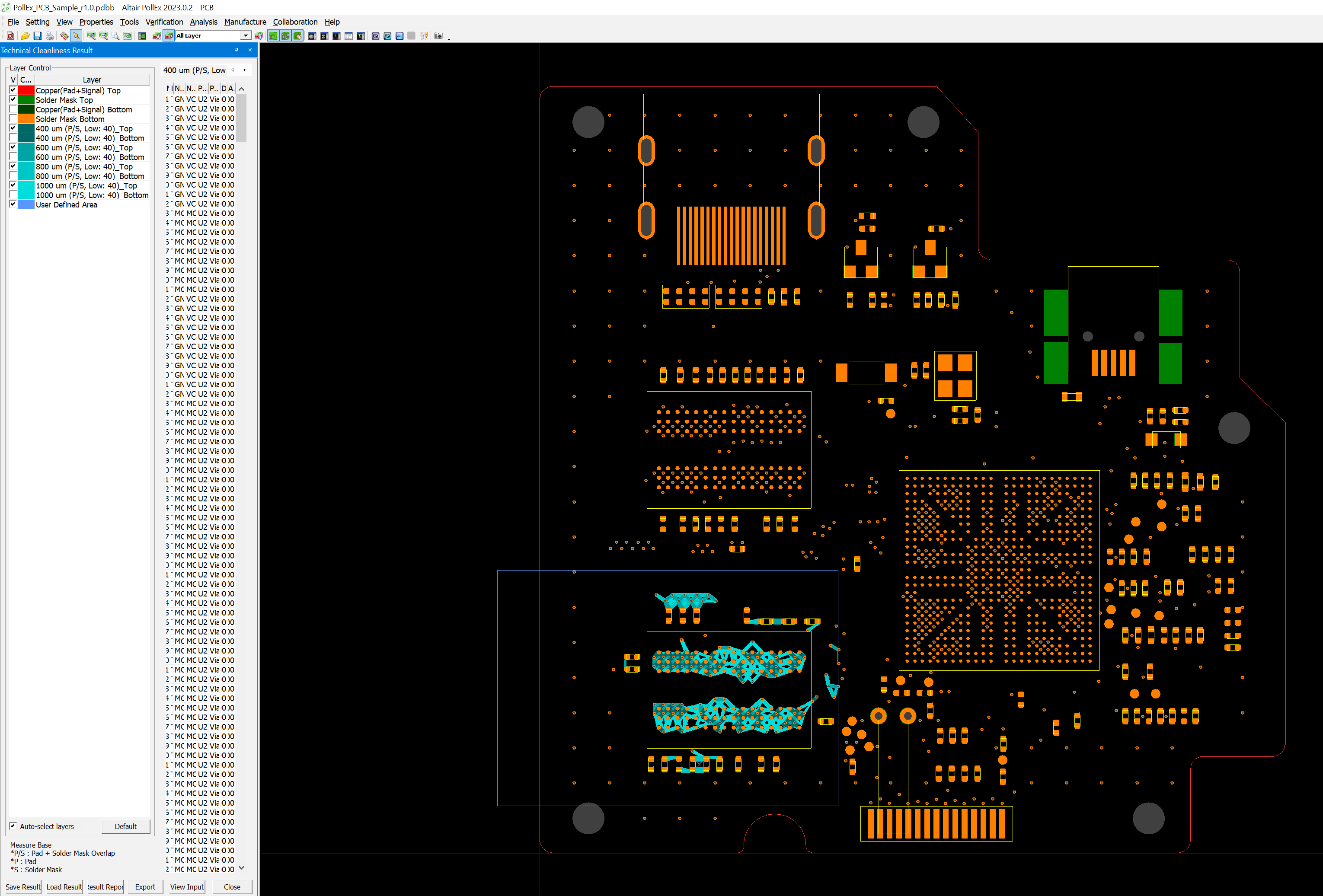

- Layer Control - This section shows the test categories and areas.

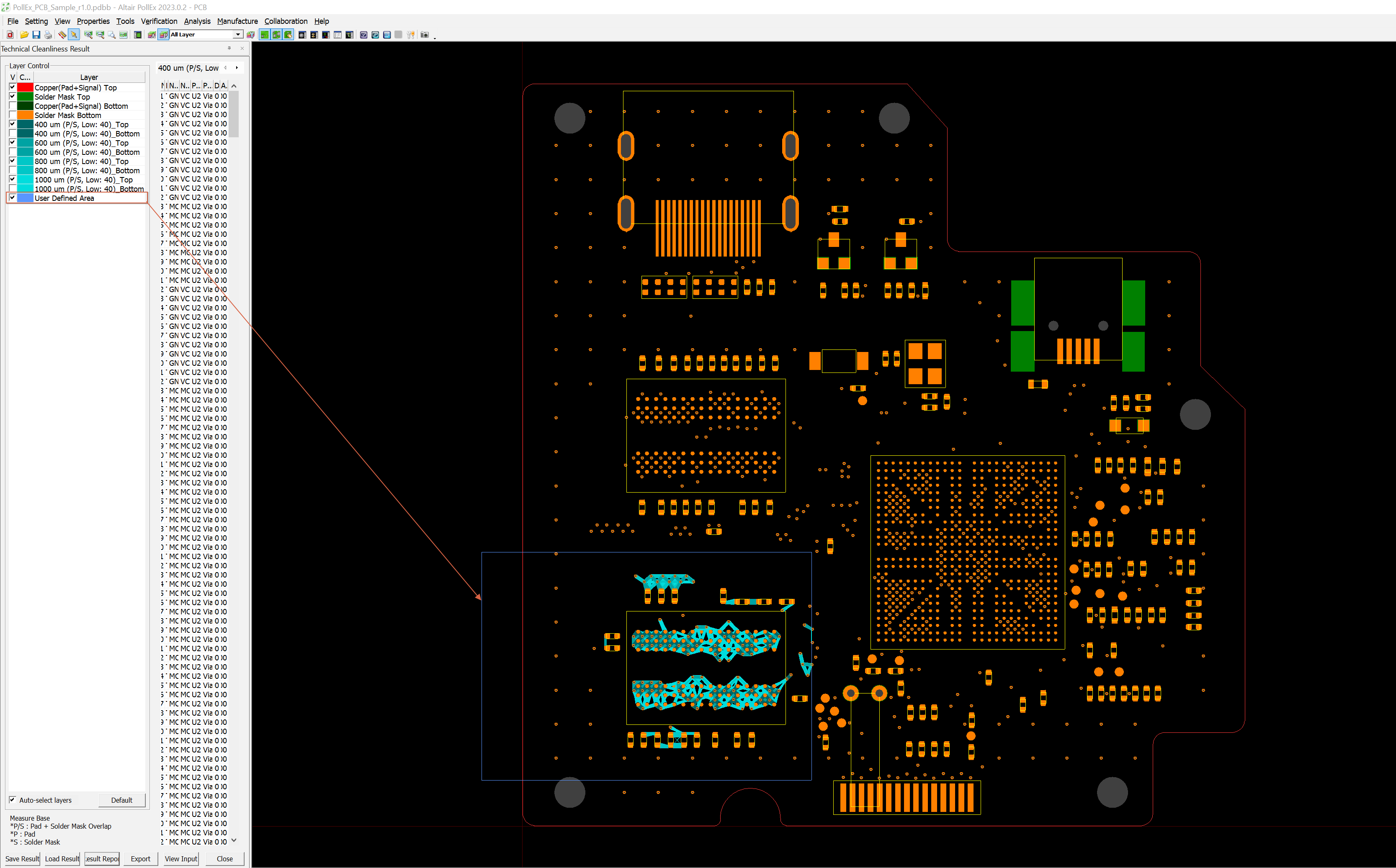

- User Defined Area - This layer is for the user specified section
selected before analysis. The set area is highlighted in Blue
- Default - This button resets the layer control to its original settings.
- Save Result - This button allows the result data to be saved.

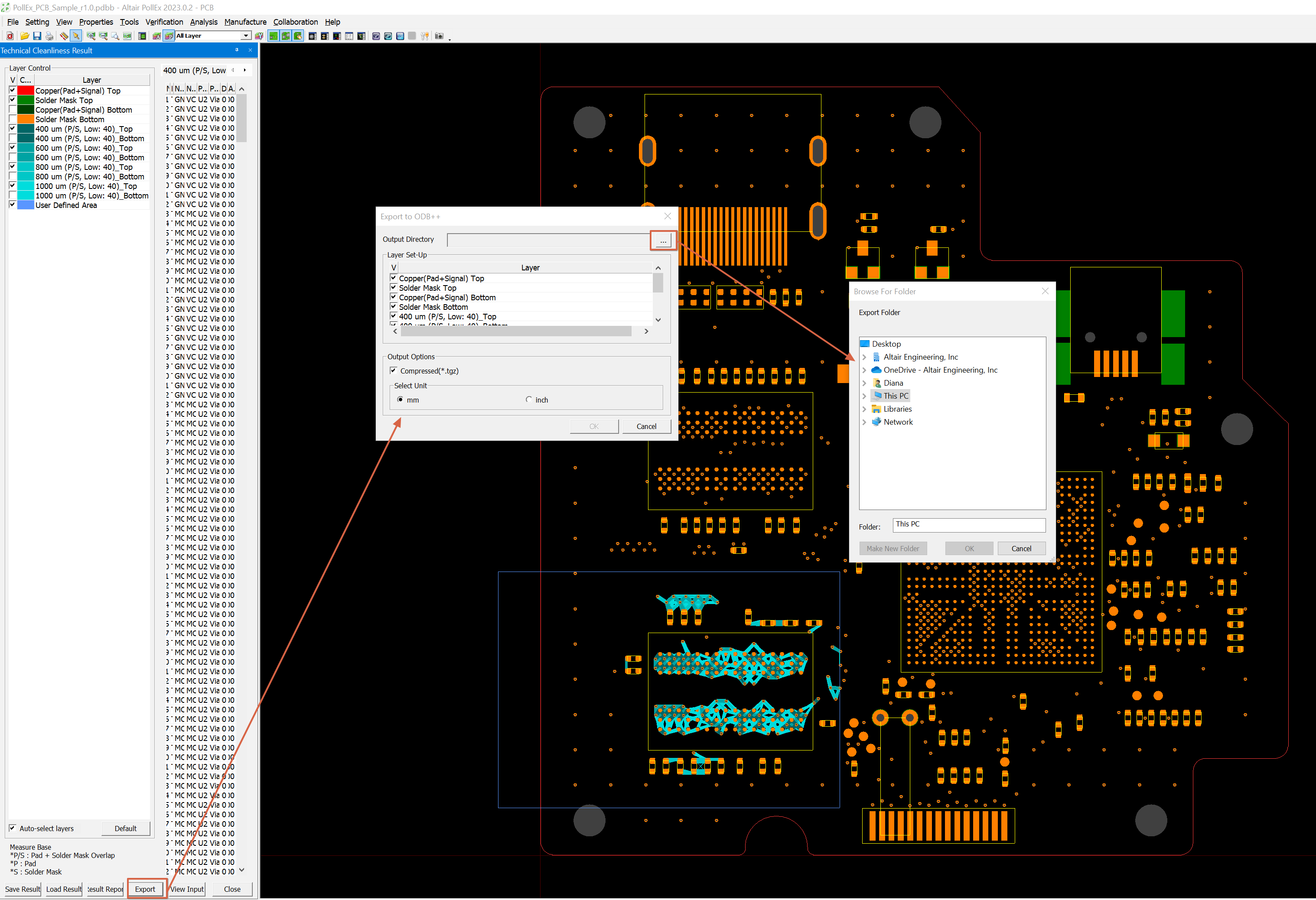

- Export - This button exports the result data to ODB++ format.
Figure 3.

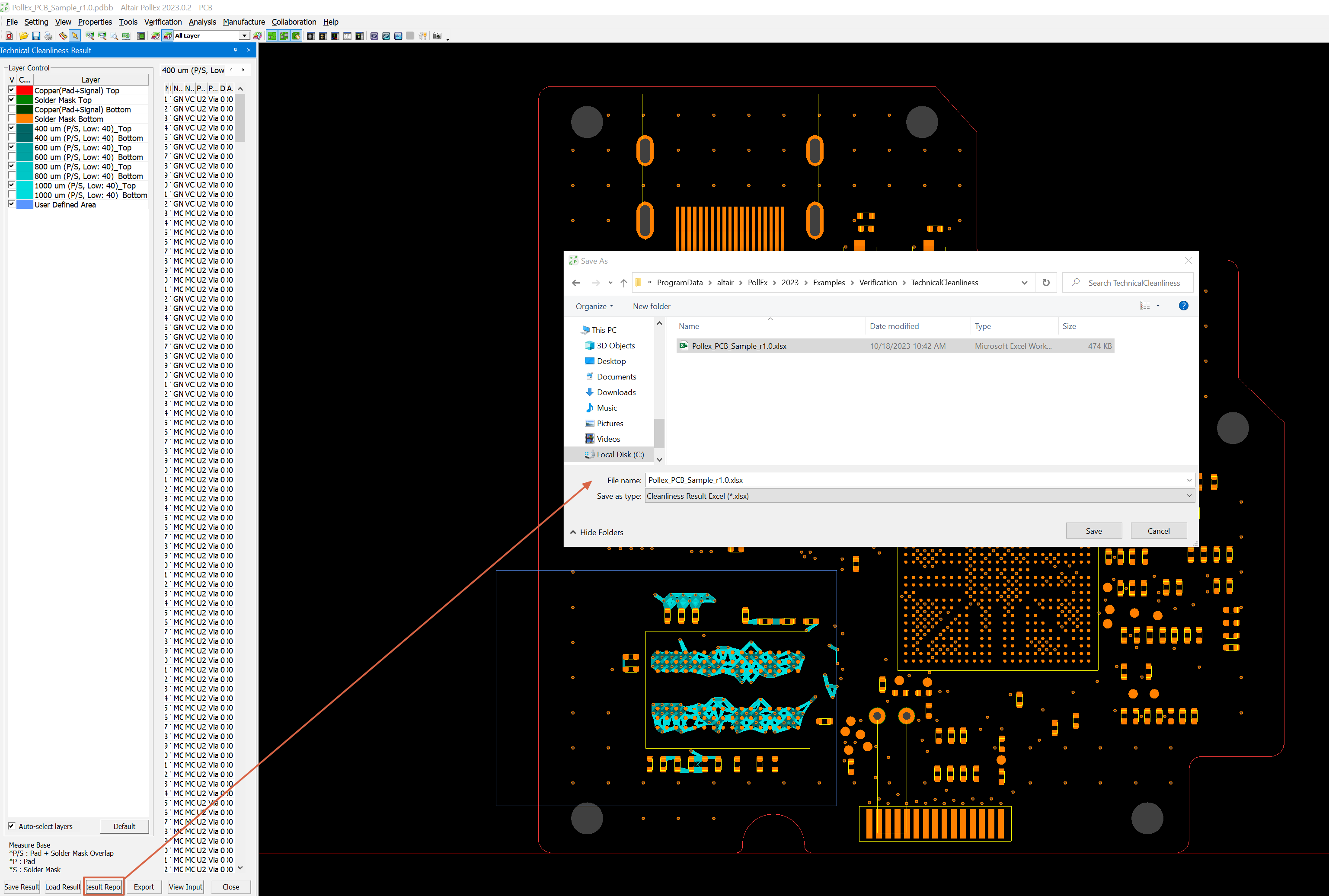

- Result report - This button allows the result data to be saved in an Excel
file format.
Figure 4.
