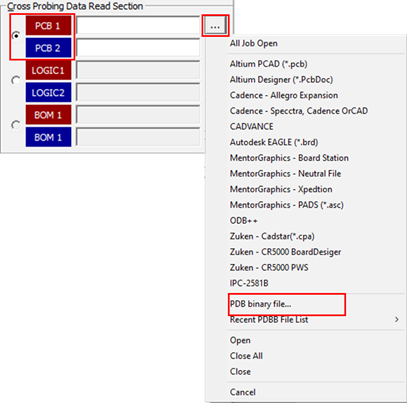

Select PCB, click
for PCB1, and select PDB binary file.
Figure 1. - Select the PollEx_CP_Sample_PCB_T1_r1.0.pdbb file from C:\ProgramData\altair\PollEx\<version>\Examples\Modeler\CP.

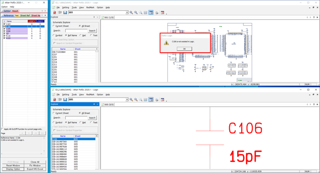

Click C106.
C106 exists in LOGIC2 only. In the LOGIC2 window, the component located area automatically zooms-in. In the LOGIC1 window, there is no C106.
Figure 7. -

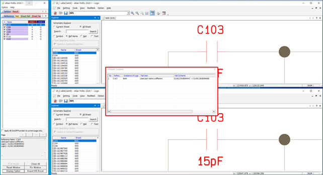

Click C103.
C103 exists in both schematic designs, but there is a difference of part name in each design.
Figure 8. -

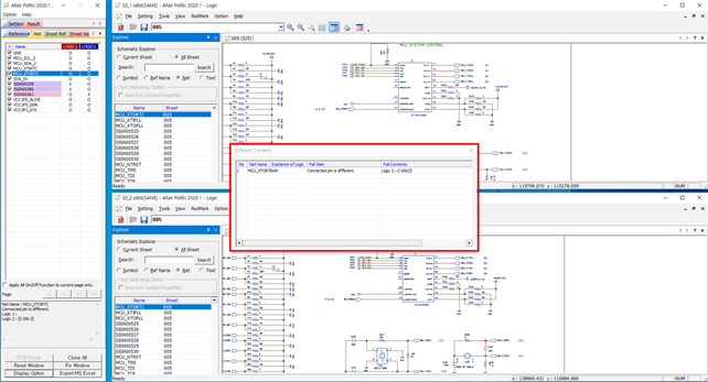

Click the Net tab and click
MCU_XTORTC.
MCU_XTORTC exists in both schematic designs, but there is a difference of connected Pin in each design.
Figure 9. -

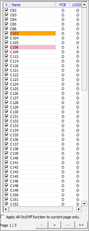

Highlighted in pink means that an object exists in only one design. Highlighted in yellow means that an object exists in both designs, but there is different information. The others (without highlight) means that there is no difference.
Figure 13.- Click Open All and click Reset Window to check the differences between the designs.
Click C106.
C106 exists in PCB design only. In the LOGIC window, there is no C106.

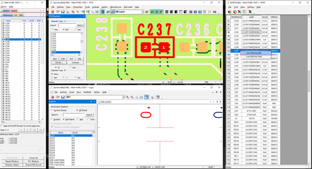

- Click Open All and then click Reset Window to reset each window.
- Select the Reference tab in the PCB window and select C103.
Click Link All.
Link All is only available in PollEx PCB. The C103 displays. The selected part displays on PCB, Logic and BOM.
Select C237 for BOM and right-click
Link All (Only Ref).
The selected part displays on PCB, Logic, and BOM.
Figure 15.

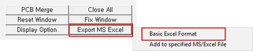

Export Result to MS Excel.
Click Export MS Excel and select
Basic Excel Format.
Figure 16.
Basic Excel Format.
