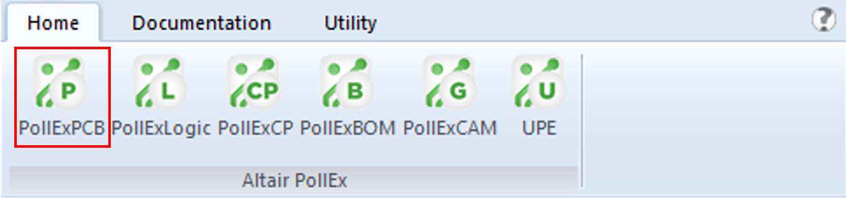

Open and Save PollEx PCB Layout Design File
From the Home ribbon of the PollEx Launcher, click
PollExPCB.

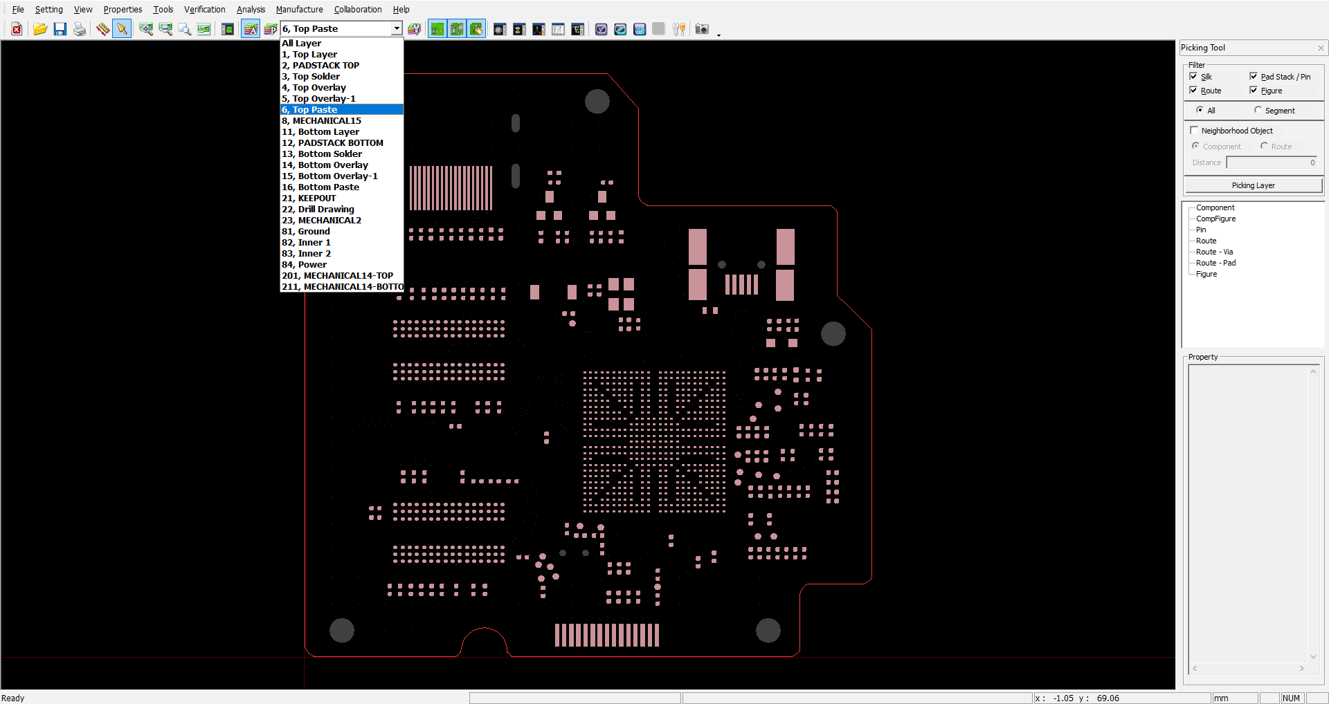

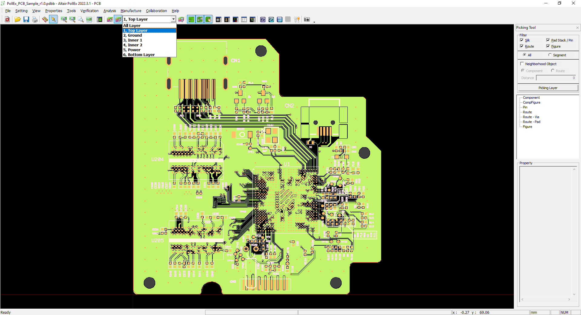

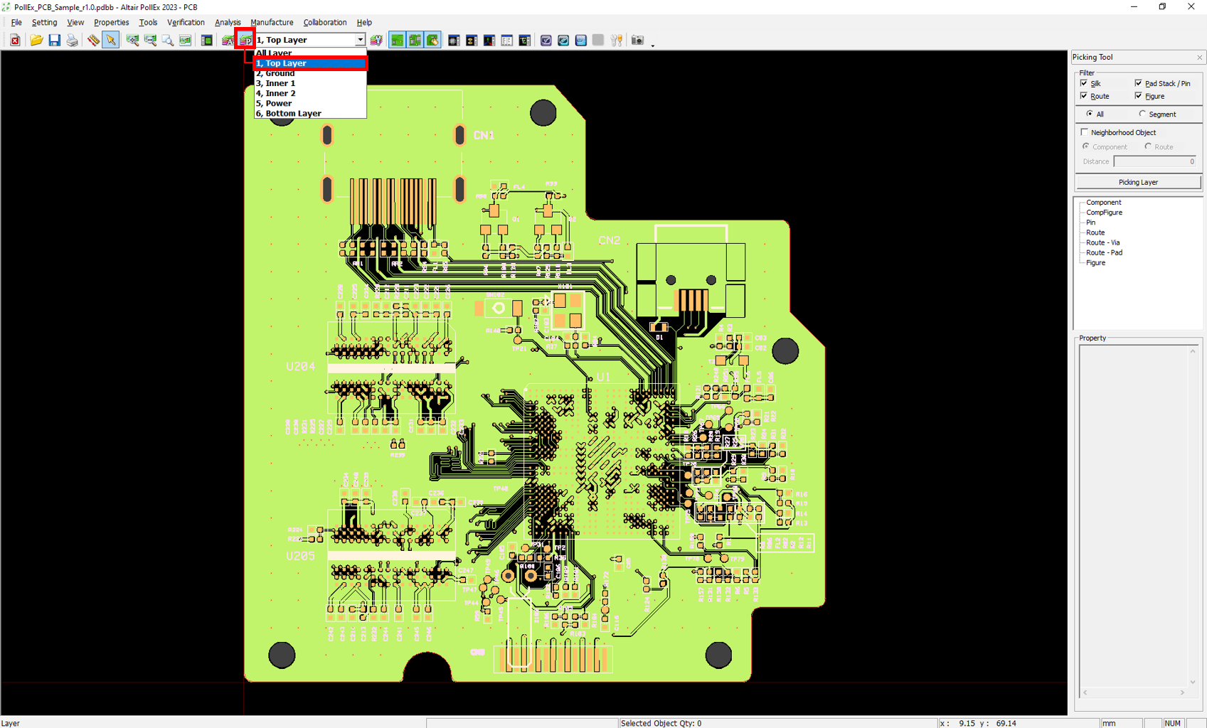

Change the layer display.
From the toolbar, click
and select 6, Top Paste.
Figure 2.Shape data on Top Paste displays. You can display and see the layer by selecting the name on the list. -
and select 1, Top Layer.
Figure 3.Combined layers as Top Layer is shown on the window.

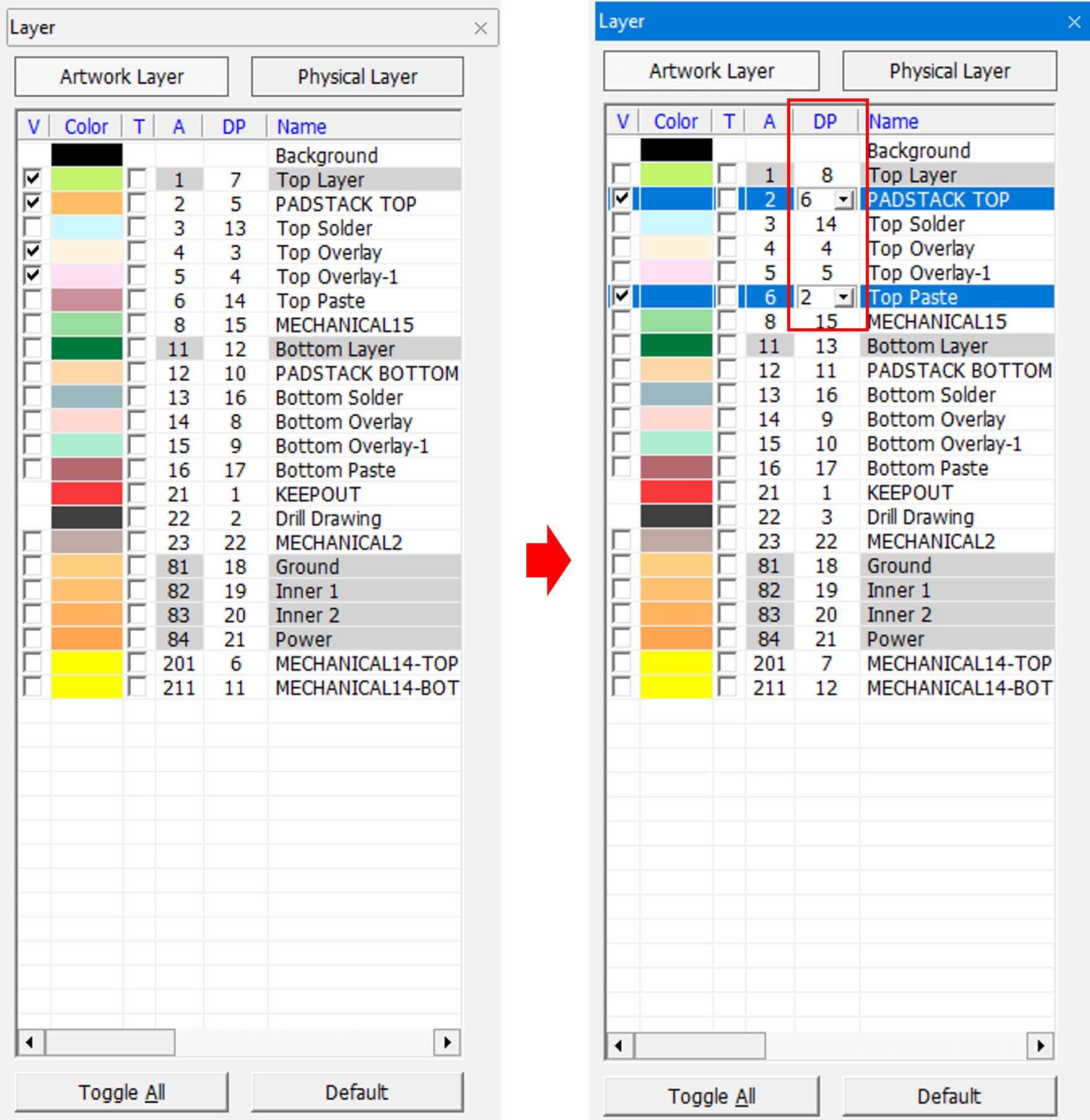

- From the menu bar, select Setting > Layer.
- In the Layer dialog, select PADSTACK TOP and Top Paste.
For Top Paste, change the DP value to 2.
Figure 4.Top Paste is overlapped on the PADSTACK TOP layer. - Close the Layer dialog.

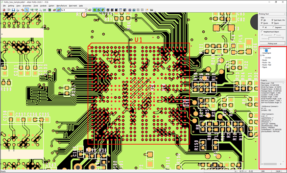

Find object properties using the Picking Tool.
Figure 5.
In the window, select an object within the design.
The object name and property information display.
Figure 6.

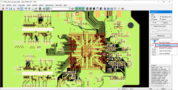

- In the window, select a component.
In the Picking tool window, right-click the component name and select
Run PCB Explorer from the menu bar.

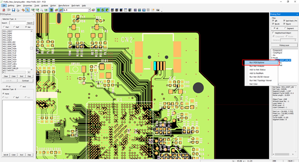

- In the window, select a Net to check.
From the Picking tool, right-click the Route name and select
Run PCB Explorer from the context menu.

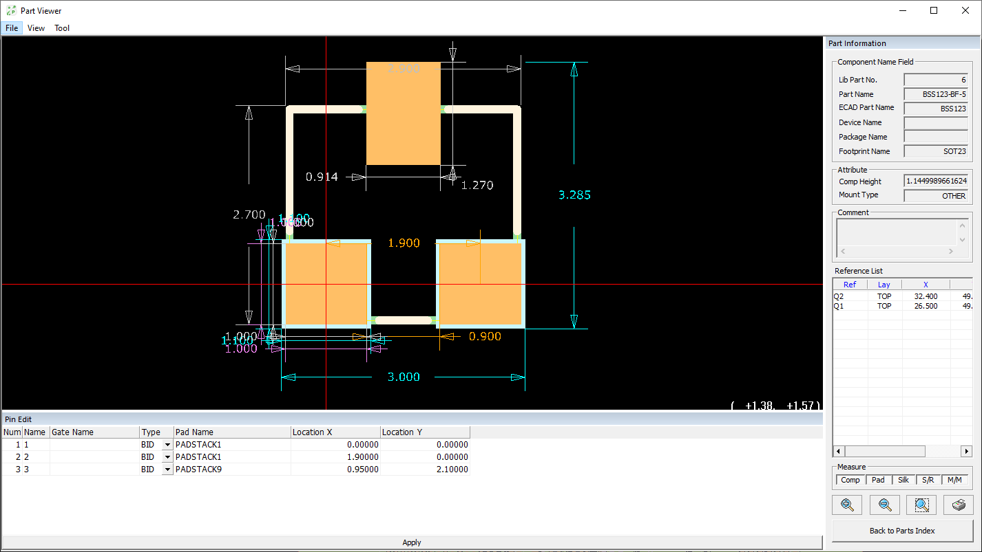

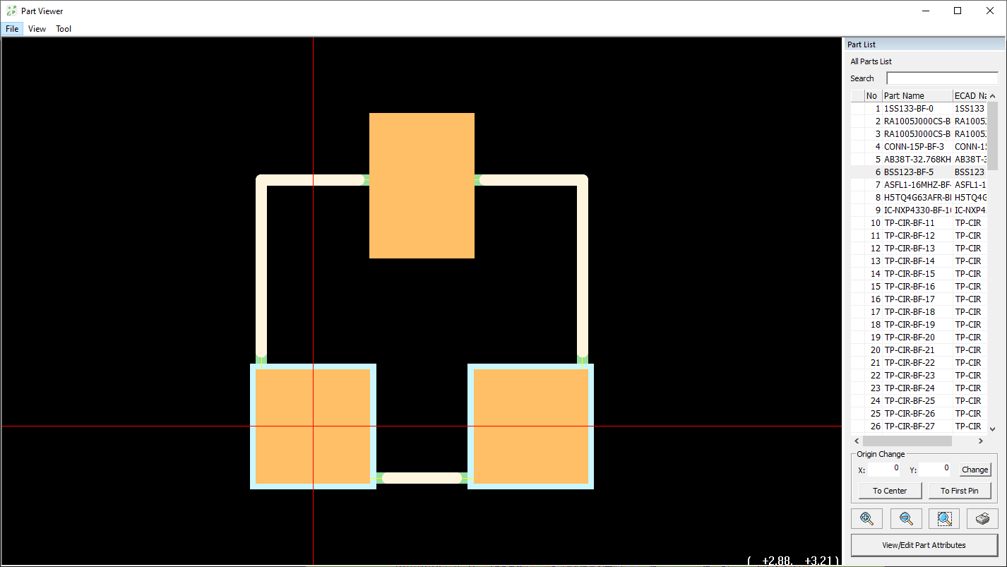

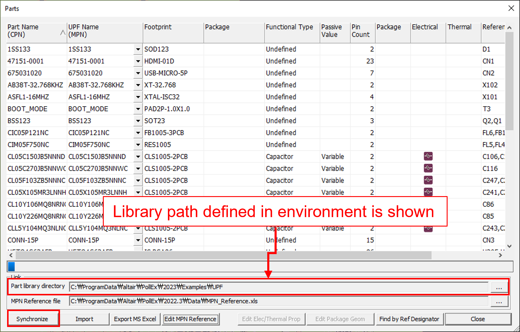

From the menu bar, click Tools > Part Viewer.
The Part Viewer dialog opens.
From the Part Viewer dialog, select a part from the part
list or use the search bar to find the desired part.
Figure 10.
Once a part is selected, click View/Edit Part
Attributes.
Figure 11.
Check the pin information of the selected part by completing one of the
following options.
- Check the reference name list with the same part name, Layer location, and Layer coordinates.
- Check the dimension information using the Comp, Pad, Silk, S/R, M/M buttons.
- Check the Pin name and location of the selected part.

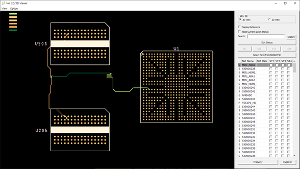

From the menu bar, click Tools > Net 2D/3D Viewer.
Use the Net 2D/3D Viewer to check nets connectivity and their three-dimensional structures. Run the Net 2D/3D viewer to see a 2D image with net lists and connected components, as shown in the following image.
Figure 12. -
Check the net structure and properties.
- Select 3D View from the 2D/3D section.
- From the net list, select MCU_ABAO.
Rotate the selected net by completing one of the following
options:
- Use the arrow buttons in the Net 3D Viewer Rotation menu.
- Move your mouse while holding left-mouse click.
- Click Property.
- Click each item under MCU-ABAO to see each structure in the net routing pattern.
- Close the Net 2D/3D Viewer dialog.

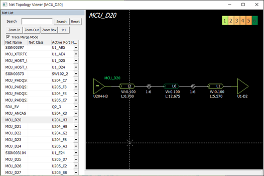

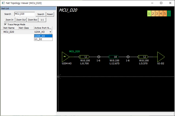

From the menu bar, click Tools > Net Topology Viewer.
The Net Topology Viewer dialog opens.
Use the Net Topology Viewer to check a net with a topology structure (Driver-Load-Receiver) including connected Vias and Branches. The viewer configures the net length and width of a trace and a component by displaying different colors per layer.
From the Net List, select MCU_D20.
Figure 13.: placed layer and color
- Driver
- W: net width
- L: net length
Change the Active Port Name to U1_D2.
Figure 14. - Close the Net Topology Viewer dialog.

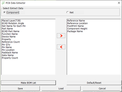

The PCB Data Extractor generates a document of component and net information that can be exported as an Excel file.
Use the PCB Data Extractor to export component and net information.
From the menu bar, click Tools > PCB Data Extractor.
The PCB Data Extractor dialog opens.
Use the red arrows to move items to be documented from the left column
to the right.
Figure 15. -
After the necessary items are selected, click Make BOM
List.
The PCB Data Extractor Result dialog opens.
- To export an Excel file, click Export to MS/Excel.
- To export Net information (Net length, connected via, total via numbers, and so on), select Net in the PCB Data Extractor dialog and repeat steps 1.b – 1.d.

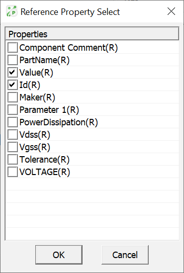

Export a report with reference property.
From the PCB Data Extractor dialog, move
Property from the left column to the right
using the red arrows.
The Reference Property Select dialog opens.
Enable the checkboxes of the necessary properties to be included in the
document and click OK.
Figure 16.The selected properties display in the right column. - Repeat steps 1.b – 1.d.

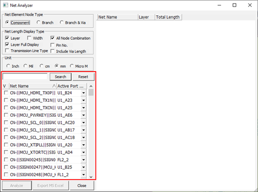

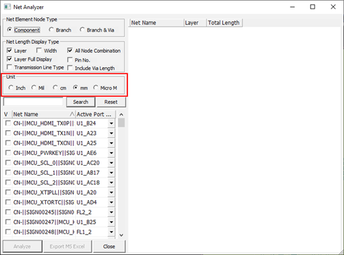

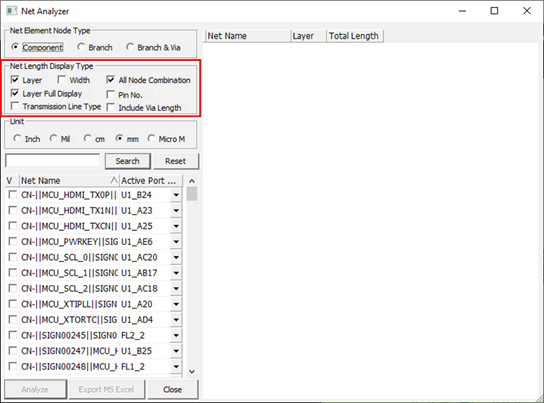

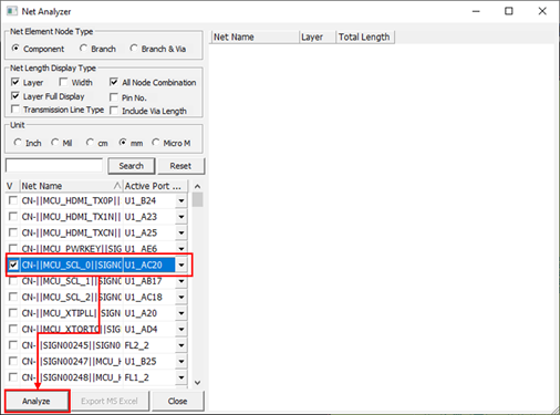

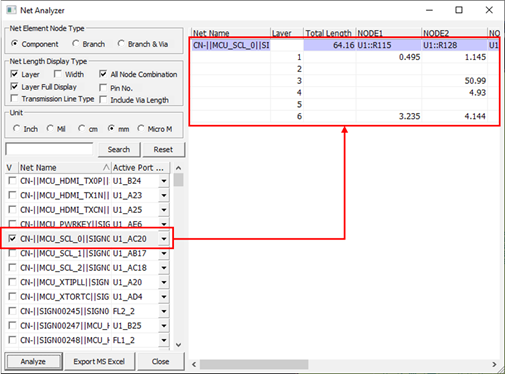

Use the Net Analyzer tool.

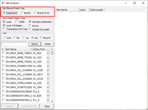

The Net Analyzer is used to analyze all net length information by considering Layer, Branch, and Via location.
From the menu bar, click Tools > Net Analyzer.
The Net Analyzer dialog opens.
From the Net Analyzer dialog, verify the Net
Element Node Type is set to Component.
Figure 17.- Component: net length among components.
- Branch: net length among components, including length of branched points.
- Branch & Via: net length among components, branching points, and vias.
Select at least one item to be displayed.
Figure 18.- Layer: display net length by a layer.
- Width: display routing pattern width.
- All Node Combination: display all combination of nodes.
- Layer Full Display: display stack-up information and net length by a layer.
- Pin No: display component pin number.
- Transmission Line Type: display lengths of micro strip line and strip line.
- Include Via Length: display via information.
Select a display unit.
Figure 19. -
Use the search bar to find the desired net name.
Figure 20. -
Enable the checkbox of the desired Net and click
Analyze.
Figure 21.
Figure 22. - To make a report, click Export MS Excel.

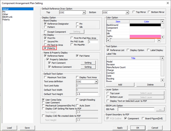

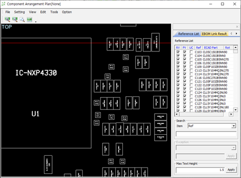

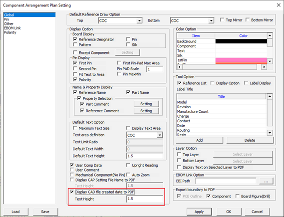

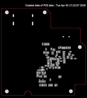

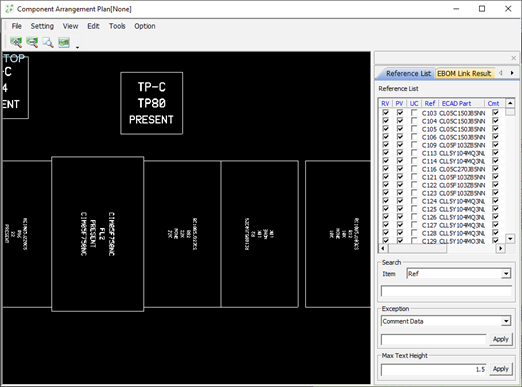

Use the Component Arrangement Plan tool to create a work-plan sheet. Using the created format, you can also apply this format to other designs to make another work-plan sheet.
From the menu bar, click Tools > Component Arrangement Plan.
Click Setting > CAP Data Setting.
The Component Arrangement Plan Setting dialog opens.

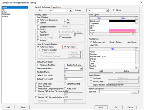

In the Component Arrangement Plan Setting dialog,
enable the Part Name checkbox and click
OK.
Figure 23.
Figure 24. -
From the Component Arrangement Plan dialog
menu bar, click Setting > CAP Data Setting.

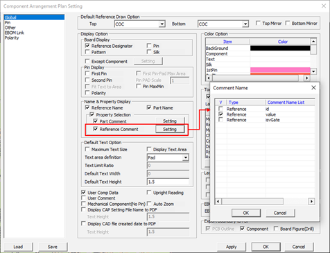

- From the Component Arrangement Plan Setting dialog, enable the Property Selection checkbox.
From the Comment Name dialog, select the value and
click OK.
If there is no value in the part property, you can select value in Reference Comment as shown below.
Figure 25.

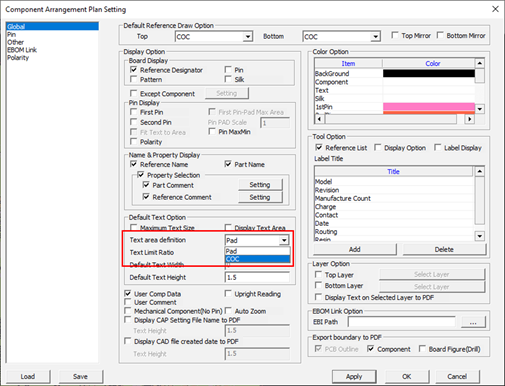

Figure 26. -

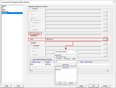

dialog, select COC for Text Area Definition and click
OK.
Figure 27.

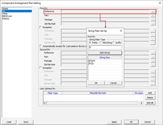

Display first pin location.
menu bar, click Setting > CAP data setting.

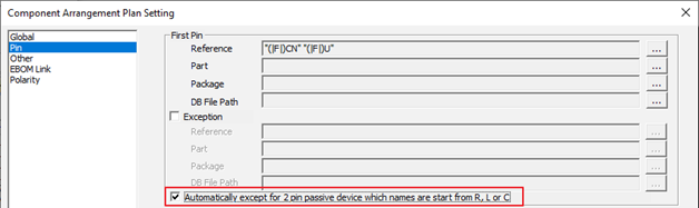

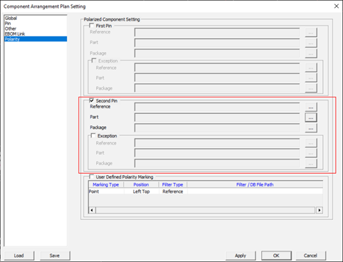

- Select Pin.
At the end of the Reference field, click the ellipses.
The String Filter Set Up dialog opens.
From the String Filter Set Up dialog, enter
U and CN for reference
prefix recognition.
Figure 28. -
enable the Automatically except for 2 pin passive device
which names are start from R, L or C checkbox and click
Global.
Two pin components that have a reference name starting with ‘R, L, C’ will not display in the 1st pin’s location.
Figure 29. -
From the Pin Display section, enable the First
Display component polarity.
For components with polarity like a capacitor, you can display their polarity.
- In the Component Arrangement Plan Setting dialog, select Polarity.
Enable the Second Pin checkbox.
Figure 31. -
Click the ellipses at the end of the Part field.
In the String Filter Set Up dialog, enter
CL10, press Enter, and
click OK.
Figure 32. -
Select Global, enable the Polarity checkbox from
the Pin Display section, and click OK.
Figure 33.

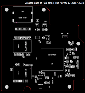

Output completed work-sheet.
enable the Display CAD file created date to PDF
checkbox and click OK.
This option shows the design creation date.
Figure 34. -
menu bar, click File > Print.
The Print Option dialog opens.
- From the Print Option dialog, select PDF and enable the Top and Bottom checkbox.
Verify the Paper Size is set to A4 and click
OK.
Figure 35. -
Specify a save location, enter a file name, and click
Save.
A worksheet for the top and bottom is output into a PDF file Top side worksheet. Bottom side worksheet.Top side worksheet.
Figure 36.

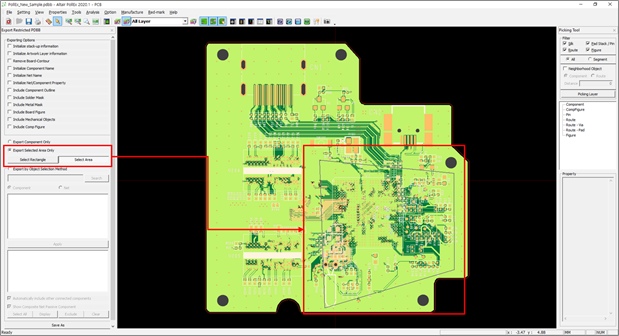

Restricted PDBB
Use PollEx PCB to change its design. Partially remove or hide some objects in the design.
If you want to share the PCB layout design with restricted objects or information such as certain components and nets, use Restricted PDBB to save as edited PDBB.
From the menu bar, click File > Export To > Restricted PDBB.
The Export Restricted PDBB menu shows on the left side of application.
- From the Export Restricted PDBB menu, enable the Remove Board-Contour and Include Metal Mask check boxes.
- Click Save As.
Save.
The Exported Restricted PDBB file is saved with the selected conditions.
- From the Export Restricted PDBB menu, select Export Selected Area Only and click Select Area.
In the window, draw an area to save and press
Enter.
Figure 38. - From the Export Restricted PDBB menu, click Save As.

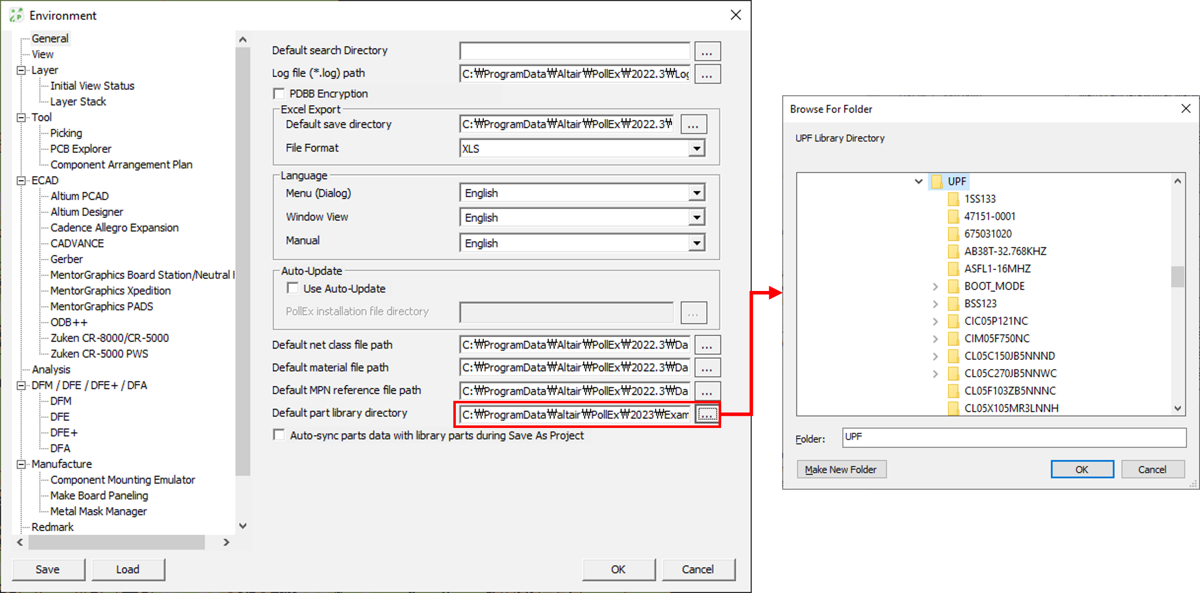

Link components.
From the menu bar, click Setting > Environment.
The Environment dialog opens. You can set the environment for importing 3D part libraries.
- From the Environment dialog, click the ellipses at the end of the Default part library directory field to define the default 3D part librarian path.
Define the unified part library directory found here:
ProgramData\altair\PollEx\<version>\Examples\UPF.
Figure 39. - Click OK.

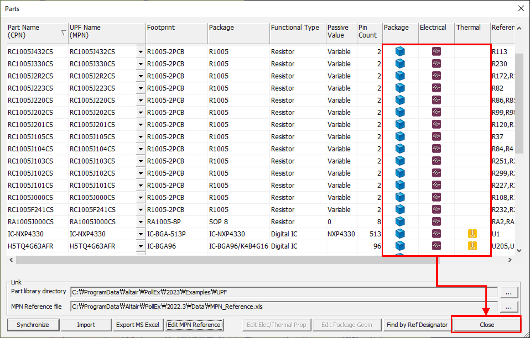

From the menu bar, click Properties > Parts.
The Parts dialog opens.
From the Parts dialog, click
Synchronize.
Figure 40.The image below shows the parts linked status.
Figure 41.: Linked to 3D packages
: Linked to electrical buffer model
: Linked to package thermal libraries
- Click Close.

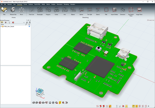

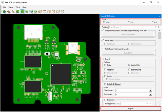

Export to 3D Format. Designs can be exported in the following formats: STEP,
STL or IDF.
In the Real PCB Assembly Viewer dialog, click File > Export To > 3D Format.
The Export 3D Option dialog opens.
From the Export 3D Option dialog, select an export
type, define the board settings, and click
Export.
Figure 42. -
Specify a location, enter a file name, and click
Save.
Use a mechanical CAD or MCAD system to read the exported STEP file.
Figure 43.
