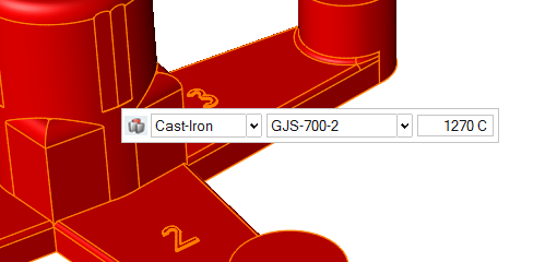

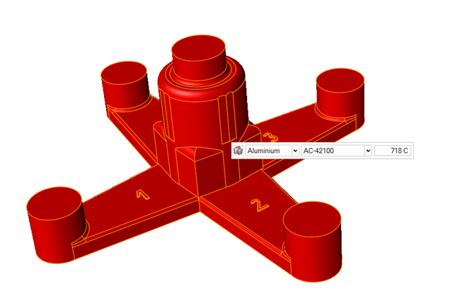

  1. On the Cast Part icon, click Designate Casting Part.
  2. Left-click to select which candidate is a cast part.
    Parts are automatically detected and highlighted based on your cursor position.
    The selected part is highlighted red.
  3. In the microdialog, select Cast-Iron as the material and GJS-700-2 as the alloy for the part.

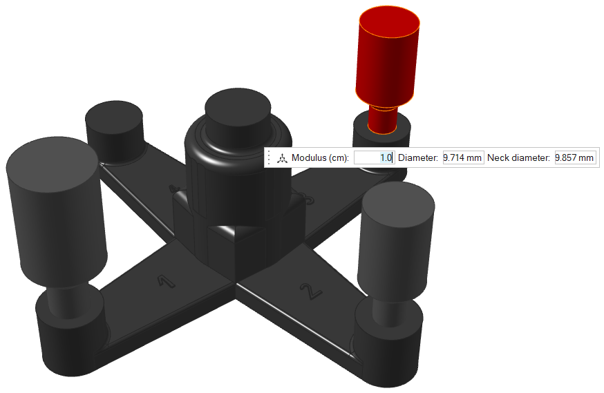

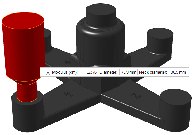

  1. Click the Components tool.
    Click the Add/Edit Riser tool in the secondary tool group.
  2. Click the center of the end of the first arm to create a riser and leave the default values.
  3. Click the center of the end of the second arm to create another riser and change the Modulus to 1.1.

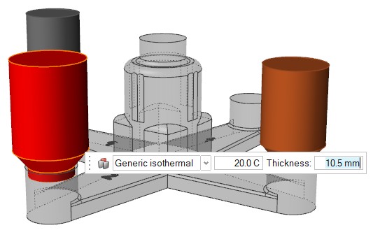

    Note: For the second branch we are going to use an Isothermal Sleeve. We can decrease the riser size since an isothermal sleeve keeps heat and helps the riser feed the part longer.

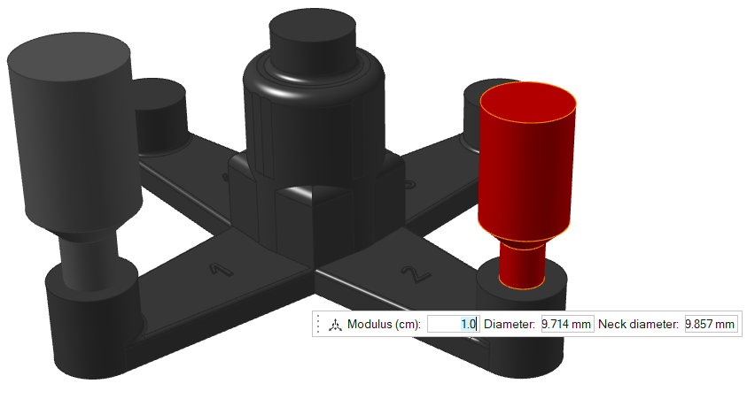

  4. Click the center of the end of the third arm to create another riser and change the Modulus to 1.0.

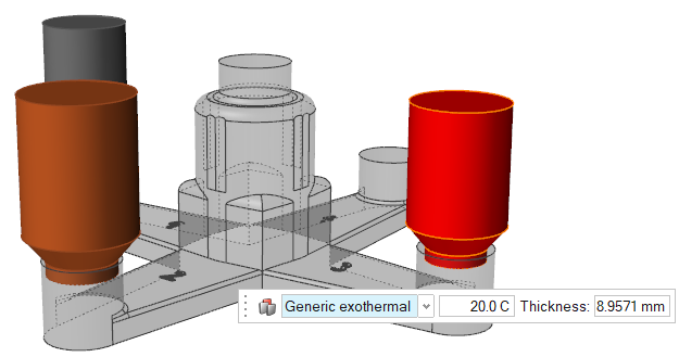

    Note: For the third branch we are going to use an Exothermal Sleeve. We can decrease the riser size even more since an exothermal sleeve releases heat during its burn and helps the riser feed the part longer.

  2. Click the riser on the second arm to create a Generic isothermal sleeve on top of it, and enter a temperature of 20° C and Thickness of 10.5mm.
  3. Click the riser on the third arm to create a Generic exothermal sleeve, and enter a temperature of 20° C and Thickness of 8.9571mm.
  4. Right-click and mouse through the check mark to exit, or double-right-click.

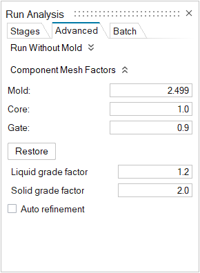

  3. Select the Advanced tab to manually select mesh factors for components like gate, mold, runner, riser, etc.

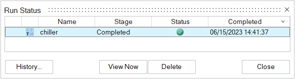

  4. Select the Stages tab and click Run.
    Note: The mold will automatically generate when you click Run.
    Note: Once the simulation calculation is finished, a green flag will appear on the analyze icon.
Analyze Results
  1. Click the green flag on the Analyze tool.
    Note: You can also view the results by selecting the run and clicking View Now in the Run Status window.

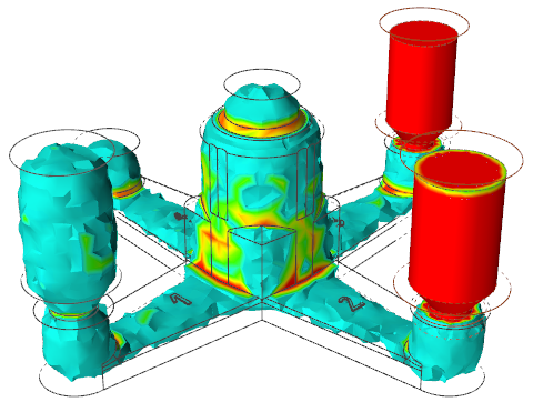

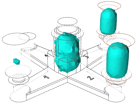

    In the animation, solidified material (above 0.7) is transparent, while liquid material (below 0.7) is shown colored. Shrinkage porosity is more likely to occur in isolated areas.
    Despite the diminished size of the second and third risers, they are able to feed the part longer because of the effect of the sleeves.
  5. Click Demolding under Stage, and click Porosity under Result Types.
  6. Set the percentage to 100%.
    Despite the difference in sizes of the risers, all of the porosity is formed in them rather than in the part, thanks to the sleeves.
