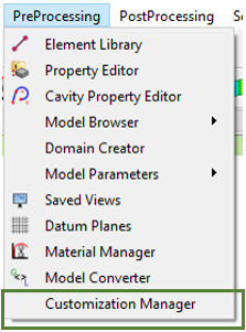

From the PreProcessing menu, select the customization manager.
Figure 1. PreProcessing Menu/Customization Manager option

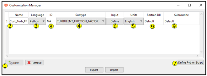

- Click New to create a new custom item.
- Give the item a name; no spaces allowed in the name.
- Select the programming language: Python or Fortran.
- Select the subtype for the custom item.
- Select English or SI units to control the units of variables passed between the custom code and the Flow Simulator solver.
- Define the unique inputs for the custom items. These can be used to add
inputs for each element that uses this custom item. These variables are
added to the argument list for the Python and
Fortran custom routines. No spaces are
allowed in the names.
Figure 3. - If Language=Python, write the Python code. Use the Restore button to update the Python code template that is supplied.
- If Language=Fortran, a unique ID can be given so that multiple items of the same subtype can be programmed in the same Fortran subroutine. The other option is to use a unique subroutine name for each item.
- If Language=Fortran, a unique DLL and subroutine names can be given. “Default” means the solver uses customize.dll and the subroutine names are found in the fs_custom_lib.f example file.
- Use Export to write a file containing all custom items in the current model.
- Use Import in another model to read all custom items into the model.

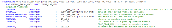

CUST_GET_FLUID_PROP retrieves fluid properties based on the pressure and temperature supplied.
Figure 8.
CUST_PRP_INP(1) = CUST_PRP_P
CUST_PRP_INP(2) = CUST_PRP_T
CUST_PRP_VIN(1) = PS
CUST_PRP_VIN(2) = TS + 459.67
CUST_PRP_LOUT = .FALSE.
CUST_PRP_LOUT(CUST_PRP_CON) = .TRUE.
CALL CUST_GET_FLUID_PROP(CUST_PRP_INP, CUST_PRP_VIN, CUST_PRP_LOUT, CUST_PRP_VOUT, ELEM, CUST_FLOW_ELM, ISTATUS)
K = CUST_PRP_VOUT(CUST_PRP_CON)

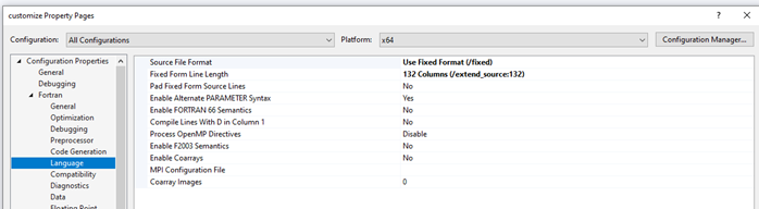

The INTEL Fortran compiler (v19.0.4.245) was used for development testing of this feature. Other compilers and versions may work but have not been tested. Compiling and linking should be done for 64-bit to be compatible with Flow Simulator. The fs_custom_lib.f uses the Fortran fixed format but with lines up to 132 columns, so use these compiler options. An example in Visual Studio:
