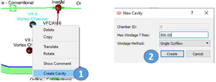

Quick Guide for Creating a Cavity in the GUI
- Right-click on a vortex chamber or inertial chamber (a cavity cannot be
applied to a plenum or momentum chamber) and select Create
Cavity. An optional cavity title can be given to help
identify it.

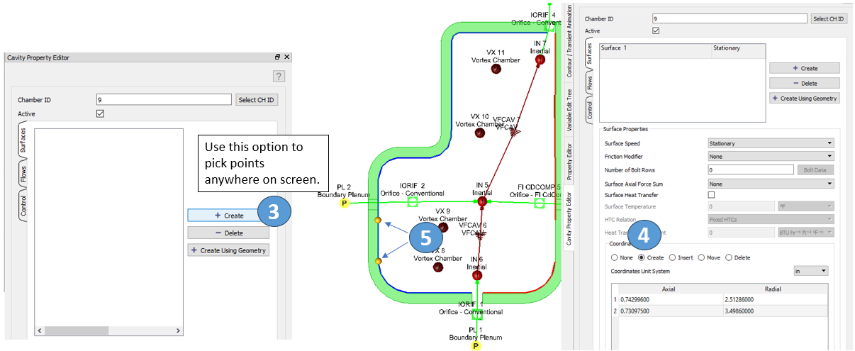

Figure 1. - Create the surfaces of the cavity. Cavities usually have multiple surfaces, with each surface associated with a different part in the machine. Each surface must have a unique speed so do not use points from a rotating and stationary part on the same cavity surface. Cavity surface points can be created using 1)the traditional approach of selecting a point on the screen close to the CAD geometry or 2) using the CAD geometry to place points directly on the curves.
- The Create option works best for creating a new
surface with the traditional approach. Use the
Insert, Move, and
Delete options to edit an existing surface.
Select the surface points on the screen to fully define the cavity
surface.

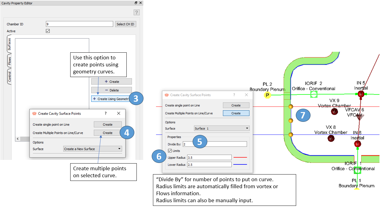

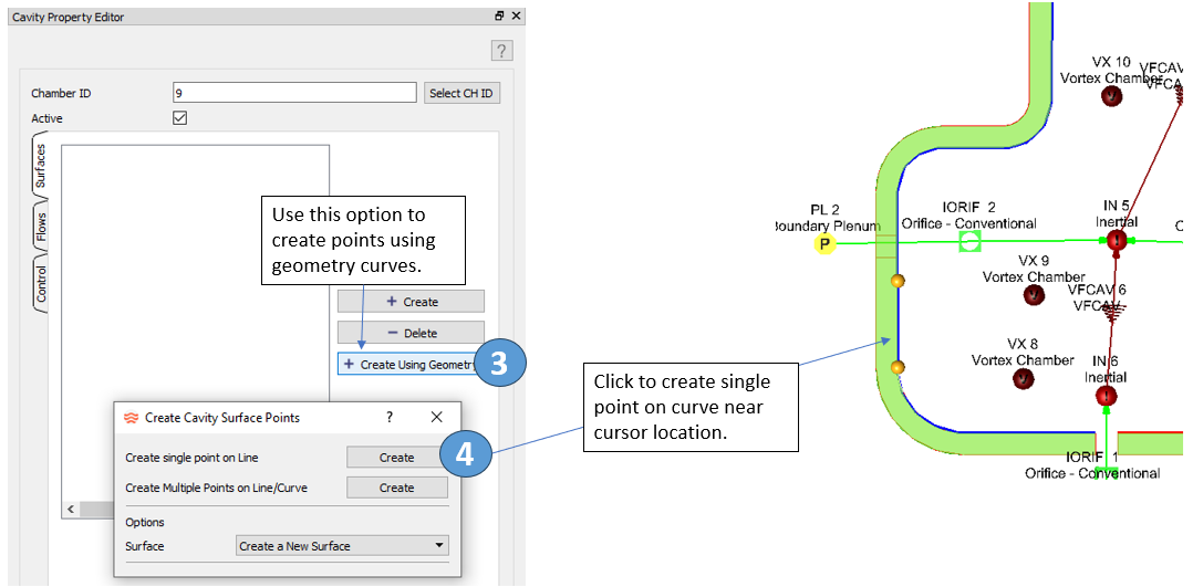

Figure 2. - Create surface points directly on the CAD geometry one at a time.
Figure 3. - Create multiple surface points directly on the CAD geometry with one
click.

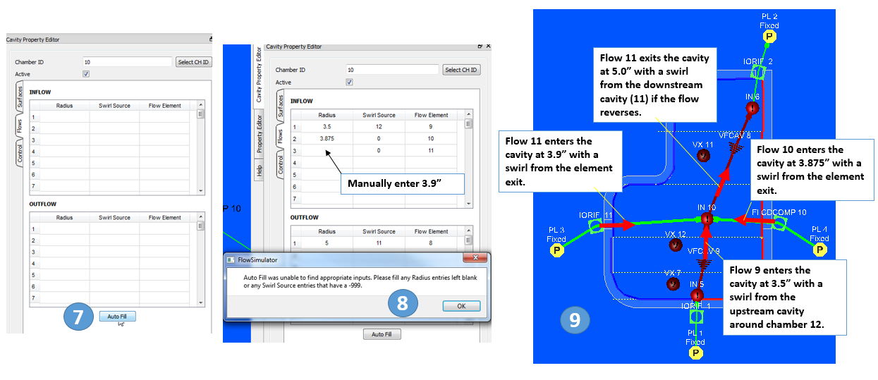

- After the surfaces are created, the flows entering and exiting the control
volume must be defined. The Auto Fill button can be
used to populate the table. However, “Auto Fill” must have information from
completed elements to work properly, so complete input for elements that are
attached to the cavity chamber before attempting “Auto Fill”. Manual edits
to this table may be required. The three inputs for each flow include:
- Radius: The radius (inches) of the flow entering or exiting the cavity control volume.
- Swirl Source: The chamber containing the swirl of the flow entering the cavity. Enter a “0” if the swirl of the fluid exiting the Flow Element is to be used (needed if no chamber contains the proper swirl). The Swirl Source for Outflows will only be used by the solver if the flow reverses in the element.
- Flow Element: The number of the flow entering or exiting the cavity control volume.

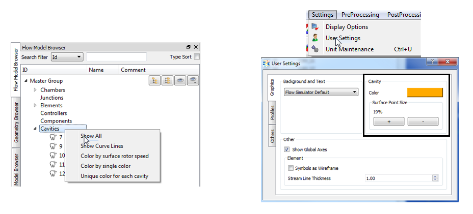

Figure 5. - Use the Cavity section in the Flow Model Browser to
adjust the cavity display and to delete cavities if needed. The
Colour by surface rotor speed is useful for
visualizing the surface speeds (Blue = stationary and Red = Rotor 1).
Left-click twice on a cavity in the list to center the view on the cavity.
The User Settings panel has the surface point size
control as a percentage of the chamber/element symbol size.

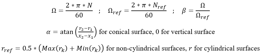

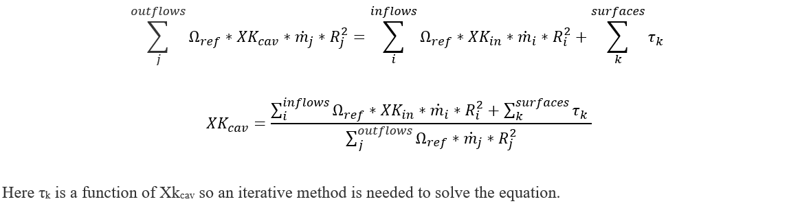

The Angular Momentum equation
Nomenclature:
KE: Volumetric Kinetic Energy
ρ: Fluid density
r, R: Radius from the engine centreline
Ω: Rotational speed
N: Speed in terms Rotation per Minute
XK: Ratio of the fluid absolute rotational speed to the rotational reference frame (i.e. rotor)
τ: Torque
cf: Coefficient of friction
x: Axial location of surface segment endpoint
α: Angle that the surface makes with the engine centreline
Nb: Number of bolts in the bolt row
Cdb: Cd for the bolt row (spacing correction is automatic)
Sb: Bolt interference scale factor for the bolt row
Ab: Cross sectional area of exposed bolt head surface
Rb: Radius from the engine centerline the bolt row
k: Cavity surface index
csf: Cylindrical surface skin friction
nsf: Non-cylindrical surface skin friction
CAV: Cavity control volume
ref: Cavity rotational reference frame
s: Cavity surface segment index
1,2: Cavity surface segment endpoints
i, j: Cavity inflow/outflow element indexes
const: Indicates that any radius terms have been removed from the parameter, this is useful to allow parameters to be pulled outside of an integral taken with respect to radius as “constants”

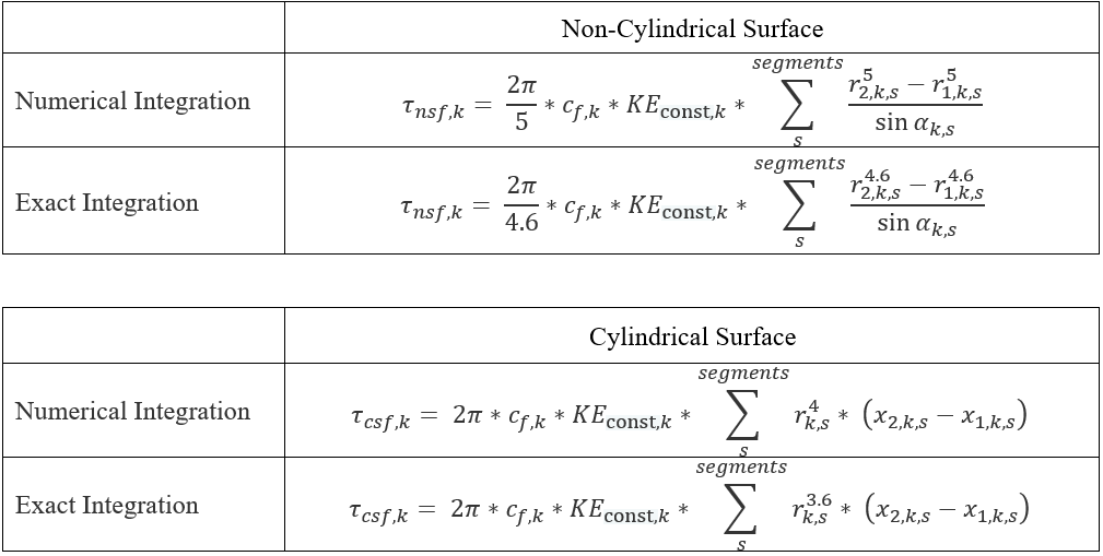

Surface Skin Friction Torque:
Torque due to non-cylindrical surfaces (Conical, Vertical surfaces with respect to engine centreline) and Cylindrical surfaces (Horizontal surfaces with respect to engine centreline) is computed either by a numerical integral or by the exact integral method. The torque integration method option is available under SolveràAnalysis SetupàSolver ConvergenceàCavity Solver Tolerancesà Torque integration method dropdown menu. The torque coefficients equations are summarized under following table:
The Volumetric kinetic energy term is defined as
Surface Bolts Form Drag Torque
Torque equation for bolts can be found in Sultanian (ref 6), section 4.3.2.
The interference scale factor, Sb,k,r is based on Fig 30 on page 5-14 of Hoerner (ref 7).

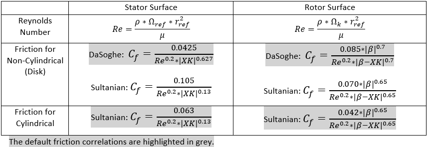

The skin friction coefficient equation depends on whether the surface is stationary or rotating. The following table presents the skin friction coefficient equations
The relation for friction coefficients on non-cylindrical surfaces that is used in all the cavity solvers was developed from data for rotating disks. Since most of the non-cylindrical surfaces in the cavities of interest are annuli rather than complete disks, use of an average radius was selected as the preferable method for the Flow Simulator cavity solver. As verified by running a wide range of test cases, the variation in results due to these methodological differences are generally minor and well within the range of engineering accuracy for the analysis.

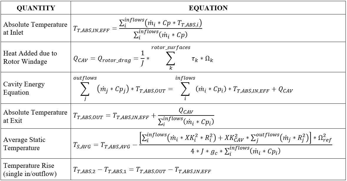

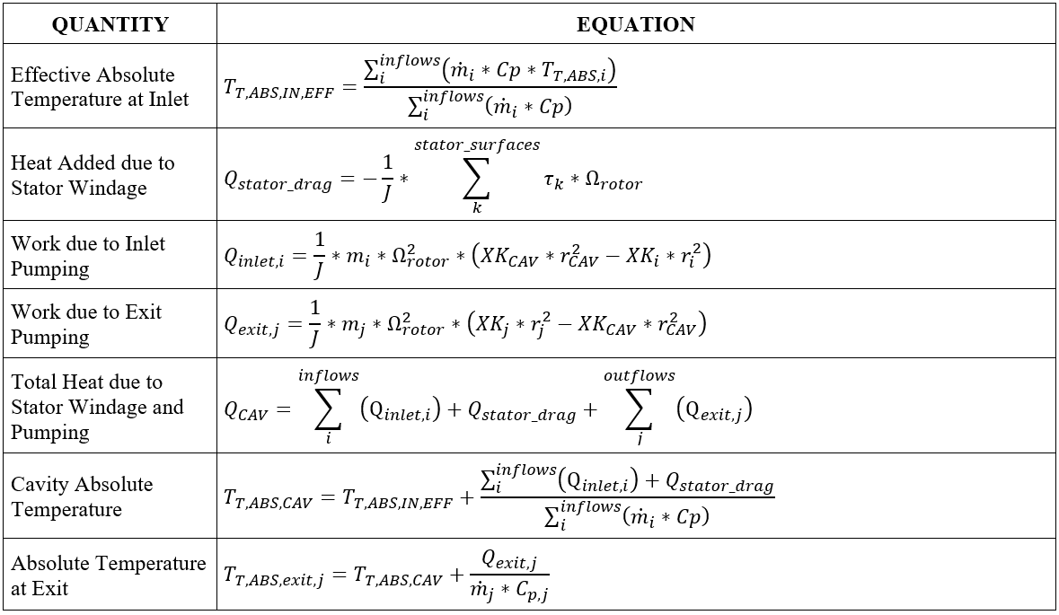

Delta Temperature across cavity:
The temperature rise across the cavity is calculated using energy balance accounting for the windage generated by rotor. The Energy balance and Delta Temperature Rise calculation are as follows:
Single In/Outflow Cavity:
Multiple In/Outflow Cavity
Cavity Heat Transfer
HTC = Heat transfer coefficient (user-supplied) or calculated by the correlation.

NAME | DESCRIPTION | UNITS ENG, SI |
NCHAMB | Cavity identification number, also the number of the associated chamber. | (ID) |
XK | Ratio of the absolute rotational speed of the fluid to the reference frame rotational speed (REF_RPM). | (unitless) |
WINDAGE | Heat added due to cavity windage. For the new multiple outflow cavity methodology, this is the sum of the stator windage and rotor pumping for element flow(s) exiting the cavity. |
BTU/s, W |
DT_WNDG | Total absolute temperature rise due to windage. For the new multiple outflow cavity methodology, this is the sum of the stator windage and rotor pumping for element flow(s) exiting the cavity. |
deg F, K |
TEMPERATURE | Total absolute temperature in the cavity, also stored as TTC
of cavity chamber (NCHAMB). For the new multiple outflow cavity methodology, this temperature only includes the effect from the stator windage and rotor pumping for all element flows entering the cavity. The change in temperature due to rotor pumping for any flow(s) exiting the cavity is applied to the chamber(s) downstream of the element(s). |
deg F, K |
PRESSURE | Static pressure in the cavity, also stored as PSC of cavity chamber (NCHAMB). | Psia, mPa |
FL2_MASS_FRAC | Secondary fluid mass fraction, also stored as FS of the cavity chamber (NCHAMB). | (unitless) |
CONV_ITER | Number of iterations required for the cavity to converge on the most recently completed cavity run. | (number) |
REF_RPM | Reference rotational speed for the cavity. Used with swirl factor (XK) to calculate fluid rotational speed |
rev/min |
CAVITY CHAMBER | Cavity identification number, also the number of the associated chamber. | (ID) |
CAVITY SOLVER ITERATIONS |
REF RPM | Reference rotational speed for the cavity. Used with swirl factor (XK) to calculate fluid rotational speed |
rev/min |
CAVITY XK | Ratio of the absolute rotational speed of the fluid to the reference frame rotational speed (REF RPM). | (unitless) |
CAVITY FLUID RPM | Rotational speed of the fluid in the cavity | rev/min |
CHAMBER TEMPERATURE | Total absolute temperature in the cavity, also stored as TTC
of cavity chamber. For the new multiple outflow cavity methodology, this temperature only includes the effect from the stator windage and rotor pumping for all element flows entering the cavity. The change in temperature due to rotor pumping for any flow(s) exiting the cavity is applied to the chamber(s) downstream of the element(s). |
deg F, K |
CONVERGENCE STATUS |
Cavity convergence status | (flag) |
CAVITY WINDAGE METHOD |
Cavity windage calculation method TOTAL APPLIED TO CAVITY All cavity results are applied to the cavity chamber. This is used for single outflow cavities (ICSOL = 0). MULTIPLE OUTFLOW, PUMPING APPLIED TO FLOW Stator windage and rotor pumping for flow(s) entering the cavity are applied to the cavity chamber. Rotor pumping for flow(s) exiting the cavity is applied to the chamber(s) downstream of the element(s). This is used for multiple outflow cavities (ICSOL = 1). |
(flag) |
ROTOR_WINDAGE (STATOR + PUMP WINDAGE) |
Heat added in the cavity due to windage (friction and drag) and rotor pumping of the fluid. | BTU/s, W |
T RISE FROM ROTOR WINDAGE (T RISE FROM STATOR + PUMP WINDAGE) |
Temperature rise due to cavity windage and rotor pumping. | deg F, K |
SECOND FLUID MASS FRACTION |
PRESSURE | Static pressure in the cavity, also stored as PSC of cavity chamber (NCHAMB). | psia, mPa |
SURFACE | Cavity surface index. | (index) |
SURFACE_RPM | Rotational speed of each cavity surface | rev/min |
TOTAL_TORQUE | Total torque applied to the fluid by each surface. | ft*lbf, N-m |
GEOM_PARAM | An intermediate variable that gathers geometric data for cylindrical segments and non-cylindrical segments of each surface and is then used to compute surface torque. | ft5, m5 |
RADIUS | Effective radius of each cavity surface. | inch, m |
COEFF_FRIC | Effective skin friction coefficient of each surface. | (unitless) |
RE | Fluid Reynolds number for each surface. | inch, m |
SURF_WINDAGE_Q | Windage due to each surface. | BTU/s, W |
SURF_WINDAGE_DT | Temperature rise due to windage from each surface. | deg F, K |
ELEMENT | Element identification number for each cavity inflow and outflow. | (ID) |
ANG_MOM | Angular momentum due to each flow into and out of the cavity. | ft*lbf, N-m |
FLOW | Flow rate of each cavity inflow and outflow. | lbm/s, kg/s |
XK_SRC | Source of fluid swirl factor for each cavity inflow. CH: Fluid swirl factor for the flow is obtained from specified chamber. EL: Fluid swirl factor for the flow is obtained from specified element. |
(ID) |
XKIN | Swirl factor of each cavity inflow. | (unitless) |
RPM_REF | Reference rotational speed for each cavity inflow. Used with swirl factor (XK) to calculate fluid rotational speed |
rev/min |
PUMP_Q | Rotor pumping (heat) for each flow into and out of the
cavity. Only printed when using MULTIPLE OUTFLOW, PUMPING APPLIED TO FLOW (ICSOL = 1) cavity method. |
BTU/s, W |
PUMP_DT | Change in fluid temperature due to rotor pumping for each
flow into and out of the cavity. Only printed when using MULTIPLE OUTFLOW, PUMPING APPLIED TO FLOW (ICSOL = 1) cavity method. |
deg F, K |
PUMP_CH | Identification number of the chamber to which the rotor
pumping (heat) is applied to for each flow into and out of the
cavity. For flow(s) into the cavity, the heat is applied to the cavity chamber. For flow(s) exiting the cavity, the heat is applied to the chamber(s) downstream of the element(s). Only printed when using MULTIPLE OUTFLOW, PUMPING APPLIED TO FLOW (ICSOL = 1) cavity method. |
(ID) |
