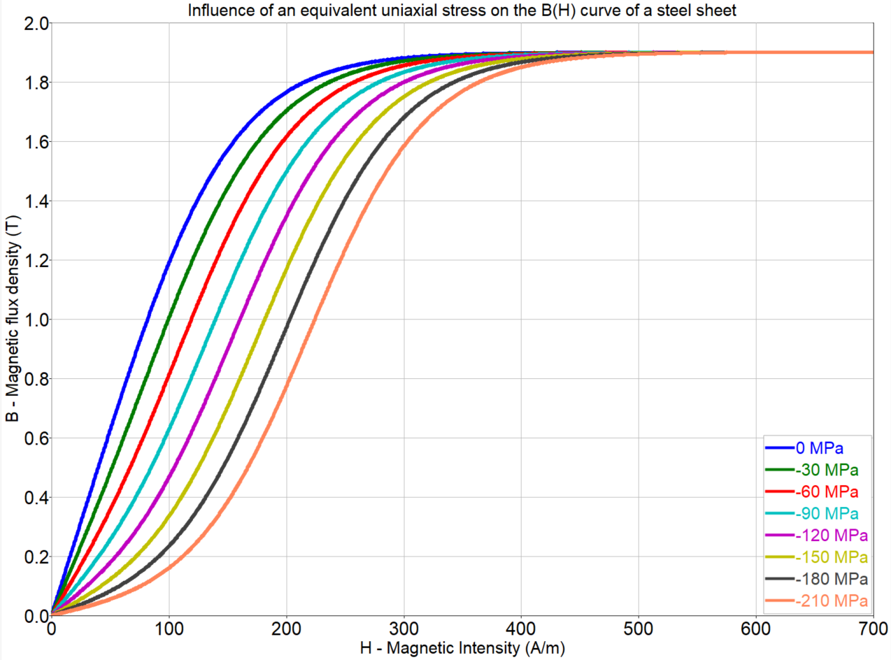

It is important to note that the descriptions of both the B(H) and B(Stress) properties of a material are mandatory to account for magneto-mechanical stress effects. Figure 1 shows the computed B(H) curves that result from different values of mechanical stress for an electrical steel sheet (FeSi alloy):
Figure 1. Example of modified B(H) curves of a FeSi steel sheet that are automatically computed by Flux, in accordance with the coupled B(Stress) property for different mechanical constraint values.
In this model, the influence of mechanical stress on the shape of the B(H) curve is governed by the saturation magnetostriction constant λ. In Figure 1, the unconstrained material may be described by the Isotropic analytic saturation + knee adjustment law with the following parameters:
