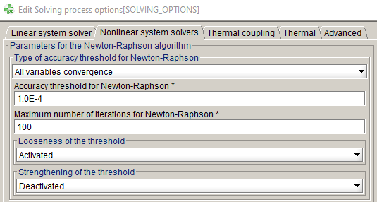

Newton-Raphson parameters and strategies are set automatically to ensure robustness and fast non-linear solving. It is nevertheless possible for the user to adjust these parameters, using the Nonlinear system solvers tab of the Solving process options box.
Adjusting of Newton-Raphson method
The user can adjust the following Newton-Raphson parameters:- Type of accuracy threshold: three options are available, namely:
- All variables convergence: all variables of the system must satisfy the required precision;
 - Global convergence: the variable exhibiting the hardest convergence must satisfy the required precision;
 - Automatic.
The Automatic option corresponds to All variables convergence in all cases, with a few remarkable exceptions, which are listed below:- projects containing hysteretical materials (in 2D and 3D);
 - when the optimal method with a stabilization stage relaxation method is used;
 - in the case of 2D initialization for Skew.
For all these exceptions, the Automatic option corresponds to Global convergence instead, since this approach leads to better performance and improved robustness.
 - The threshold: relative epsilon value below which Newton-Raphson non-linear solver stops. Depending on the activation of looseness and/or strengthening, this threshold is fixed or is the starting point of the adaptive criteria strategy. Default value is 10e-4.
 - Maximum number of Newton-Raphson iterations: the default value is 100.
- Adaptive criteria strategy relies on hard or easy convergence detection.
Figure 1. Easy (yellow), normal (green) and hard (red) convergence illustration - Looseness of the threshold: this adaptive criteria strategy is meant to ease hard
                  convergence. The adaptation is based on the residual decrease between two
                  consecutive Newton-Raphson iterations. If the decrease between these two residuals
                  is less than a percentage P (default is 10%), we consider a hard convergence
                  situation (Red region on Figure
                     1). If we have a hard convergence situation, the threshold is multiplied
                  by a factor F (default is 1.78) to ease the convergence.
Percentage P and factor F can be modified in advanced mode:

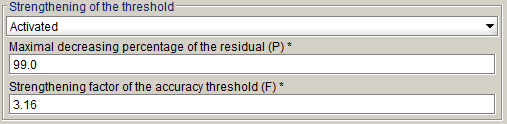

 - Strengthening of the threshold : this adaptive criteria strategy is meant to
                  harden easy convergence. The adaptation is based on the residual decrease between
                  two consecutive Newton-Raphson iterations.
                  residuals is more than a percentage P (default is 99%), we consider a too easy
                  convergence situation (Yellow region on Figure 1). If we have too easy convergence situation, the
                  threshold is divided by a factor F (default is 3.16) to harden the
                     convergence.
