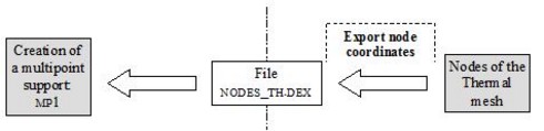

The 1st exchange type concerns the transfer of the coordinates of the nodes (stored through multipoint support). These exchanges are presented in the tables below.
- Support MP1 (thermal nodes in the electric problem)
- Support MP2 (electrical nodes in the thermal problem)
