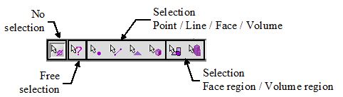

For the graphic entities, the selection filter can be activated directly by the user with the commands in the menu Selection or in the toolbar Selection.
Menu Selection
The proposed choices in the menu Selection or in the toolbar Selection, relate to the graphic entities; they are presented in the figure and the table below.
| Choice | Description |
| No selection | nothing selectable |
| Free selection |
                         all is selectable The first entity which will be selected by the user will determine the entity-type selectable  |
| Select points | the points are selectable |
