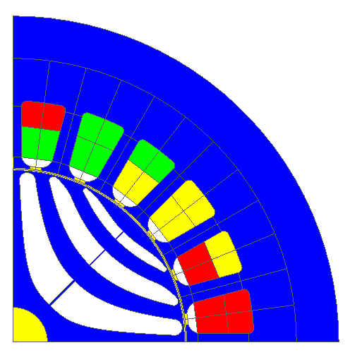

Let's consider the modeling of the following electrical machine represented by only one-quarter of the full device.
Figure 1. Four poles electrical machine with three current phases

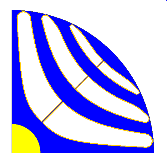

In the end, the lines where the nodes can move are selected as depicted in the figure below (the lines are surrounded in yellow):
Figure 3. Lines to be considered during the optimization process

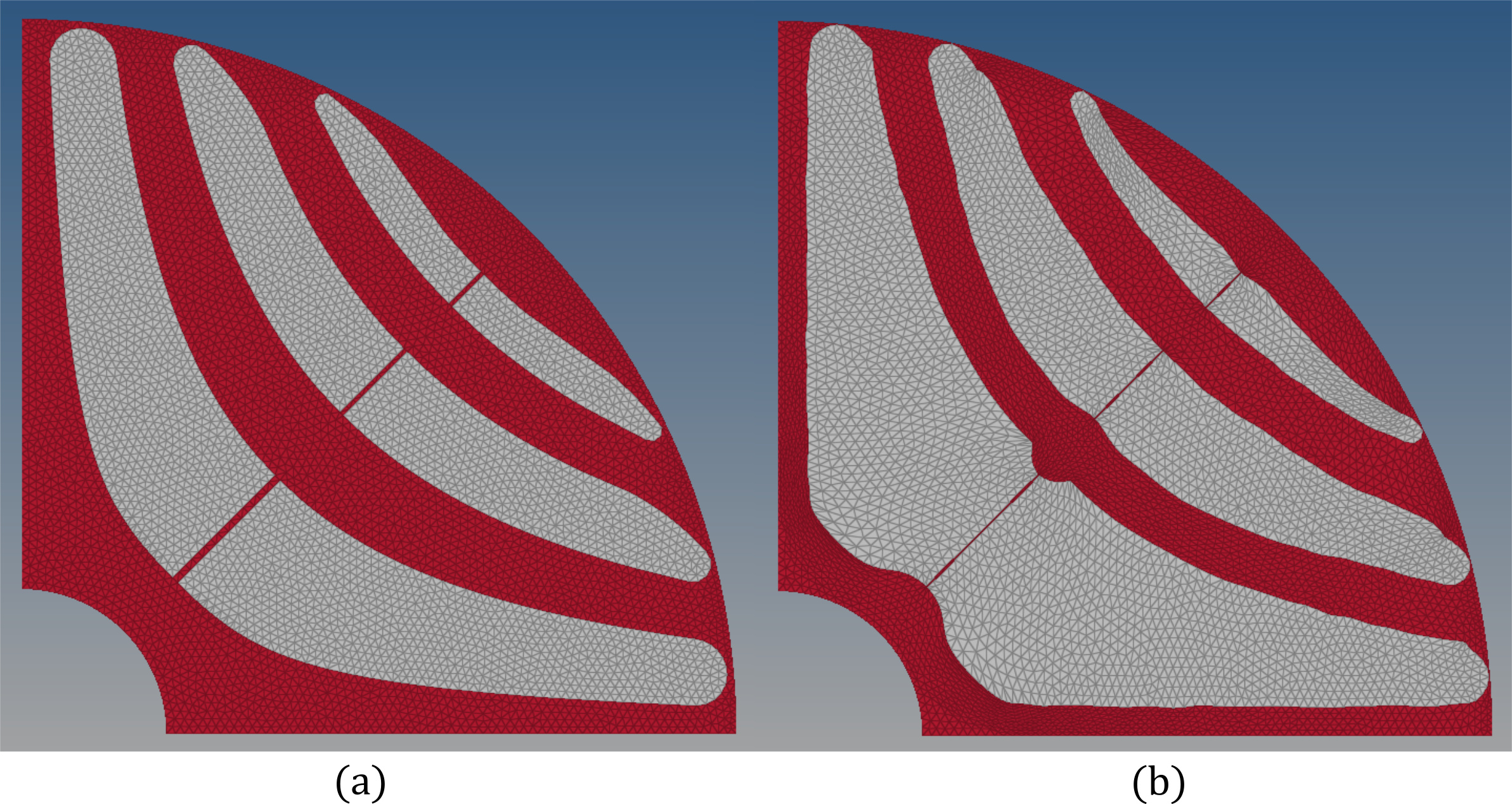

The scenario is piloted by the mechanical set angle and is covering an electrical period with two degrees per computation step.
Figure 4. Initial design of the reluctance synchronous machine (a) and final design of the reluctance synchronous machine (b)
| Initial design | Final design | Difference | |
| Mean torque (N.m) | 11.9 | 12.5 | + 4.8% |
| Rotor weight (kg) | 0.5 | 0.4 | - 20% |
