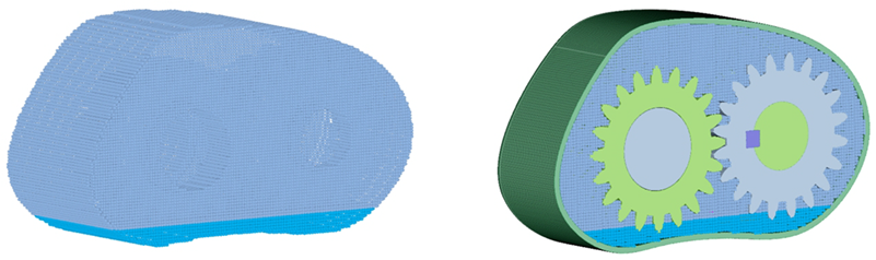

Body Type: Container
Sometimes the outer casing can have features like bolt holes or ribs which do not impact the solution. It is more efficient to generate the model without these features. This is achieved by identifying solids that define the container (should not include the moving parts, should be closed, and should not have gaps bigger than the particle distance) and a point inside the container where the fluids are present. The mesher will automatically identify the wetted surface (surface that is touched by the fluids) and create several layers of particles away from the wetted surface.
In the below model, the Moving solids (gears/shaft) are modeled as solids. While creating particles for Container, the Moving solids should be ignored. Hence, the bodies that would be considered for creating a Container, are bodies from the Model minus Moving solids.
