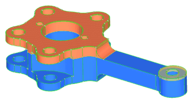

Figure 2
shows that one trim of the model by a single surface (the top surface of the
rectangular shaft, in this case) has created two additional solids within the model.
One solid remains in the ignored map state (blue), one is now not mappable (orange)
and one is one directional mappable (yellow - transparent).

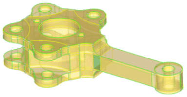

After additional partitioning of the model using the Geometry Edit
tools, it has transformed from having an ignored map and non-mappable
states to having only one directional and three directional mappable states. Figure 3 shows one three directional mappable solid, as
indicated by the green transparent solid at the base of the shaft where it joins the
part's main body.

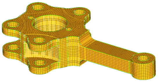

Once partitioning is successful, meshing can commence. Using the Map tool and
selecting all of the solids, plus the required meshing options, yields a complete 3D
mesh for the entire complex part, as shown in Figure 4.
Figure 4.

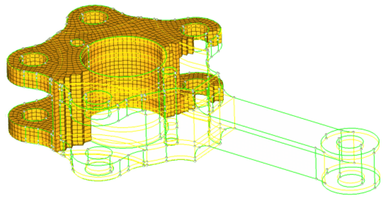

Selecting and masking a section of the elements confirms that the mesh is a
complete 3D mesh, as opposed to just a surface mesh, as shown in Figure 5.
