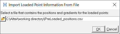

Click the Import Loaded Profile button.
Figure 17. NLFE Connectivity tab - Loaded View
In the Import Loaded Points Information From File
dialog, browse to your <working directory> and
select PreLoaded_positions.csv.
Figure 18.
Click OK to import
the loaded positions.

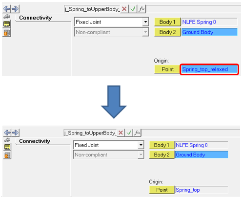

The fixed joints created by the NLFEHelicalSpring Component utility will
be at the free positions. You need to move one of these to the pre-loaded
positions. Inspecting the spring positions reveals that the spring is compressed
at the top while the bottom position is the same in both the
configurations.
Change the origin point of the joint Spring_toUpperBody_att in the NLFE Helical
Spring 0 system from Spring_top_relaxed to Spring_top (in
the parent CamFollower system).
Under Origin, double-click the Point collector
to display the model tree.
Clear the Only show entities within valid scope
check box.
Select Spring_top using the model tree or in the
graphics area (after closing the model tree).
Figure 21. Changing the connection to pre-loaded position

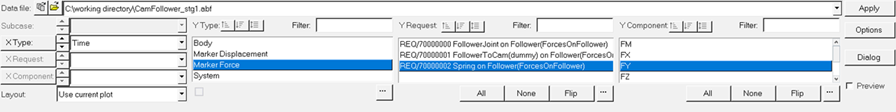

Click to add a new page.
Change the client to HyperGraph 2D.
On the Page Window Layout toolbar, click > to split the window.
In the left window, click and load the .abf file
corresponding to the solver run with the original spring (created in the step
Review the Model). Make the selections for the
plot shown in Table 2
then click Apply.
Table 2.
X Type
Time
Layout
Use current plot
Y Type
Marker Displacement
Y Request
REQ/70000003 Follower from Ground
Body(FollowerDisplacement)
In the right window, make the selections in Table 3 and click
Apply.
Table 3.
X Type
Time
Layout
Use current plot
Y Type
Marker Force
Y Request
REQ/70000002 Spring on
Follower(ForcesOnFollower)
Y Component
FY
Figure 28. Plot selections – Spring force on follower: regular spring

Apply axis labels and formatting as appropriate.
The comparison is shown in Figure 30: Figure 30. Result comparison: Regular spring versus NLFE spring
