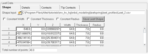

Enter Leaf 1 Data
In this step, you will enter the required data for Leaf 1 using the Leaf Data section.
Enter Leaf 2 Data
In this step, you will enter the required data for Leaf 2 using the Property Editor.
