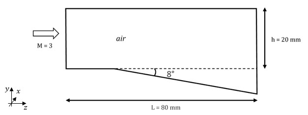

A supersonic wind tunnel (80 mm length, 20 mm height) is filled with a supersonic flow (M=3) of air.
The lower wall includes a convex corner with a downward angle of 8 degrees.
Figure 2. Problem Description for the Prandtl-Meyer Expansion Fan

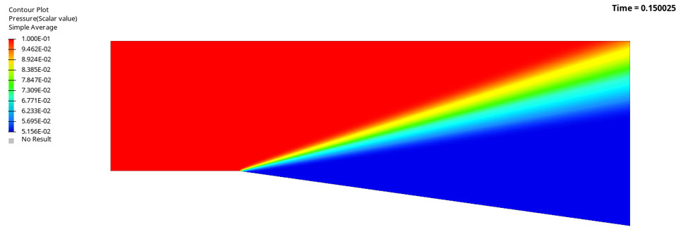

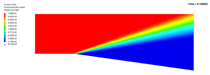

Figure 4. Pressure Contour of Fluid Domain

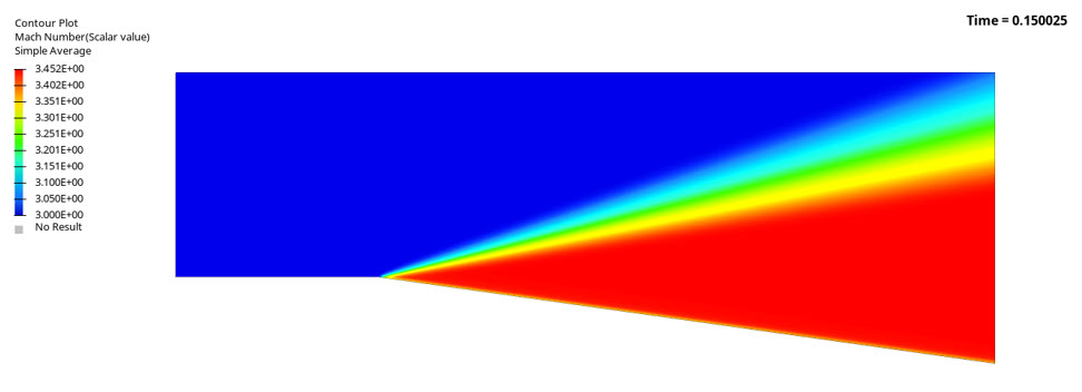

Figure 5. Mach Number Contour of Fluid Domain

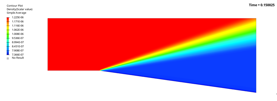

Figure 6. Density Contour of Fluid Domain

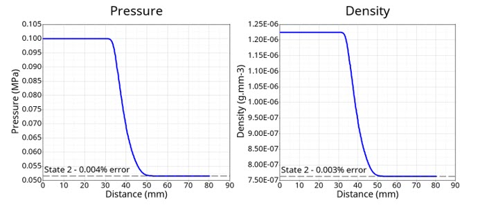

Figure 9. Pressure and Mass Density Spatial Profile in Steady-State. with the value of the relative error to the analytical value
| Values | Analytical | Simulation | Percent Error |
| Mach number | 3.4519 | 3.4518 | 0.004 |
| Pressure [MPa] | 0.05157 | 0.05158 | 0.004 |
| Mass density | 7.6337E-07 | 7.6334E-07 | 0.003 |
