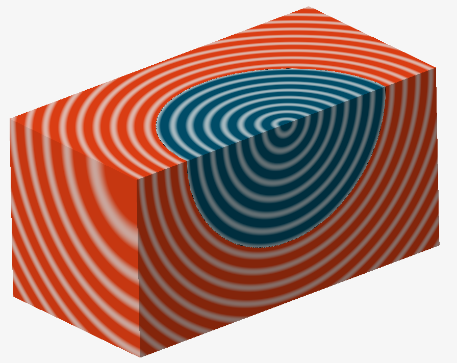

Signed-Distance Fields (SDFs)

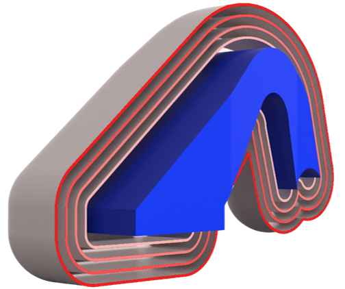

Figure 1. First Example of a SDF. The concept of SDFs is represented by the region external to the model in this image. The modeled object is shown in solid blue, and the onion-peel layers represent isosurfaces of constant distance to the object's surface.
Figure 2. Second Example of a SDF. This is another way of visualizing a field. This image shows a section view of a field that represents a cylinder aligned to the green axis (the cylinder itself has been hidden). Both the internal and external regions of the SDF are visible, with the interior region shaded in blue and white bands, and the external region shaded in orange and white bands. The bands indicate how the scalar values change in space. For a SDF, these bands will be evenly spaced and not distorted, as shown here.
SDFs are particularly useful as they give instant inside/outside checks, and they tell you how close a point is to the surface of an object. This arrangement is optimal for creating accurate offset surfaces for a given geometry, and they also enable controlled blending between surfaces, filleting operations, and much more.

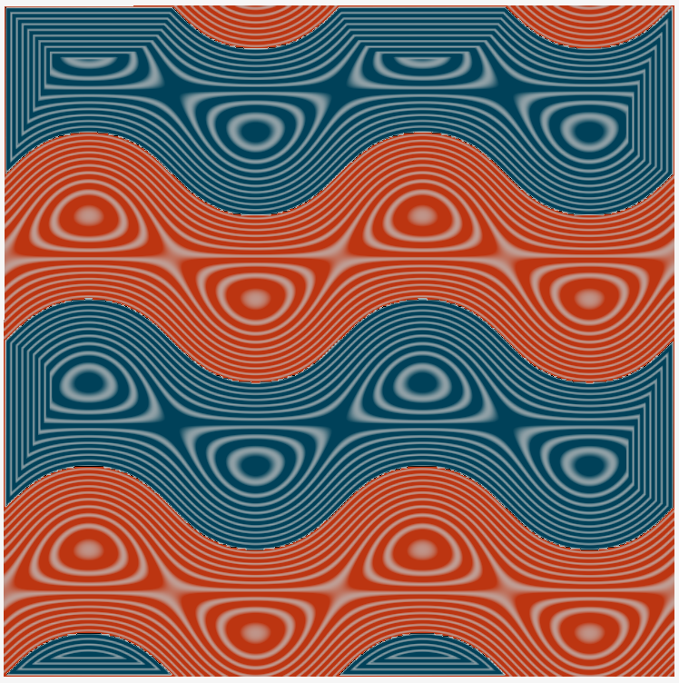

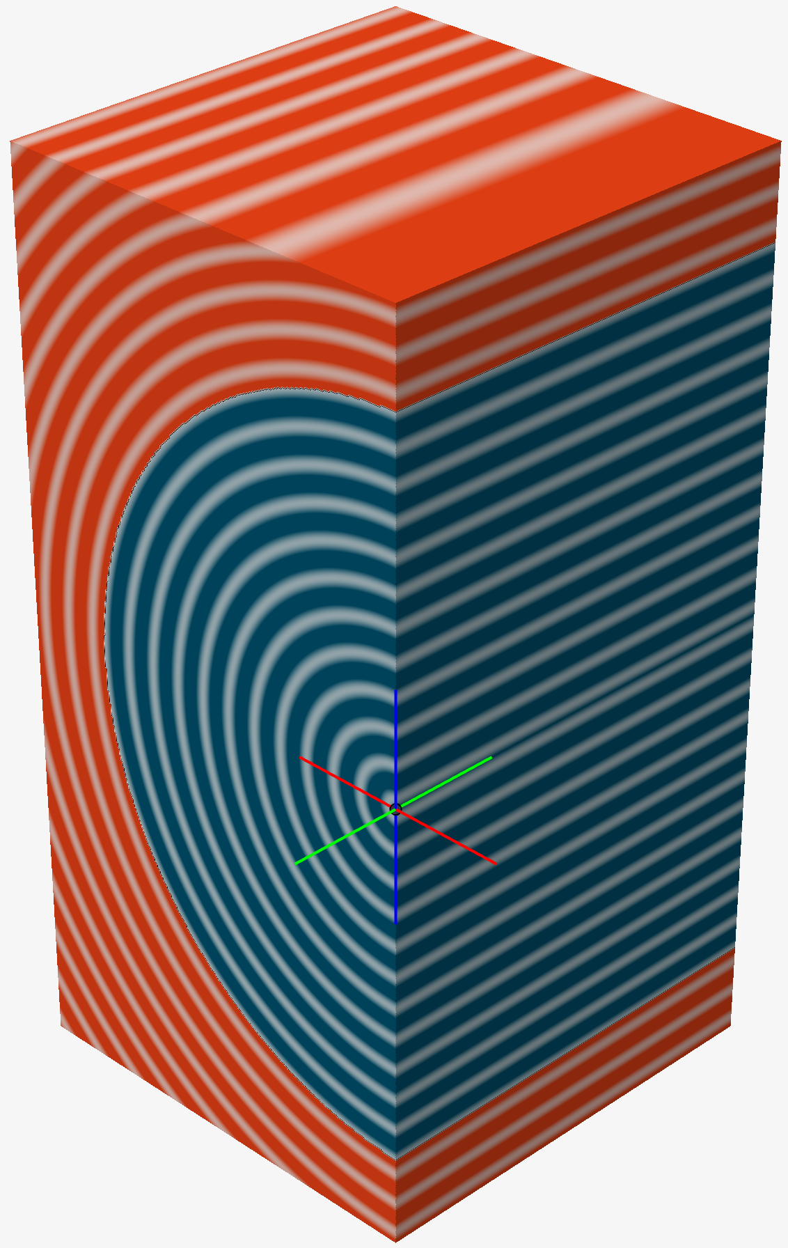

Distance-Like Scalar Fields
Figure 3. Example of Distance-Like Scalar Fields. As a illustrative example, consider this image, which shows a section view of the field of a gyroid lattice. Despite some behind-the-scenes rescaling of the field to improve the distance-like properties, careful inspection shows that the bands (e.g., blue and white) are not evenly spaced, and they become distorted farther away from the surface. This is because the underlying equation for the gyroid lattice produces a distance-like scalar field and not a SDF.

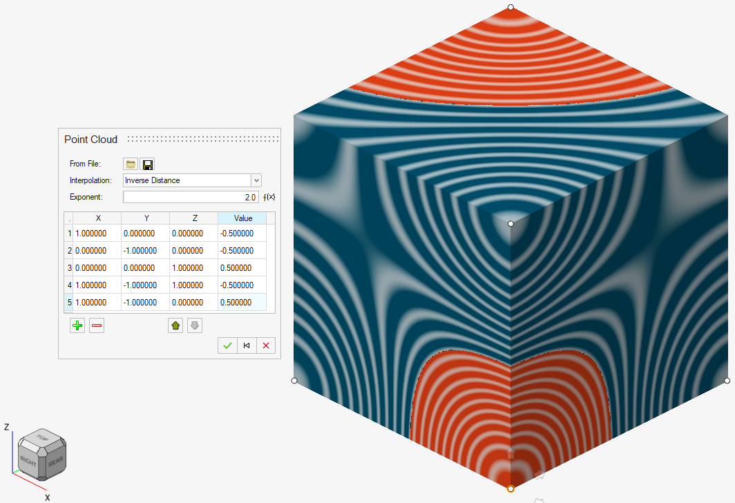

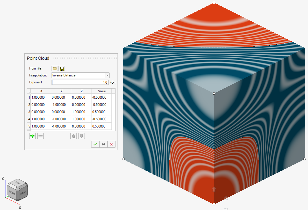

Inverse Distance Weighting
Figure 4. First Example of Interpolating Scalar Fields Using Inverse Distance Weighting. Using a lower exponent (2 in this case) results in each point's contribution traveling further through the field, decaying gradually, but being weaker in the vicinity of its source point. In this case, the field strength from this source point is inversely proportional to the square of the distance to the point.
Figure 5. Second Example of Interpolating Scalar Fields Using Inverse Distance Weighting. Increasing the exponent to 4 results in a much stronger influence in the vicinity of the source point but a rapid decay as you move farther away from this source. In this case, the strength of the contribution is inversely proportional to the distance raised to the power four.

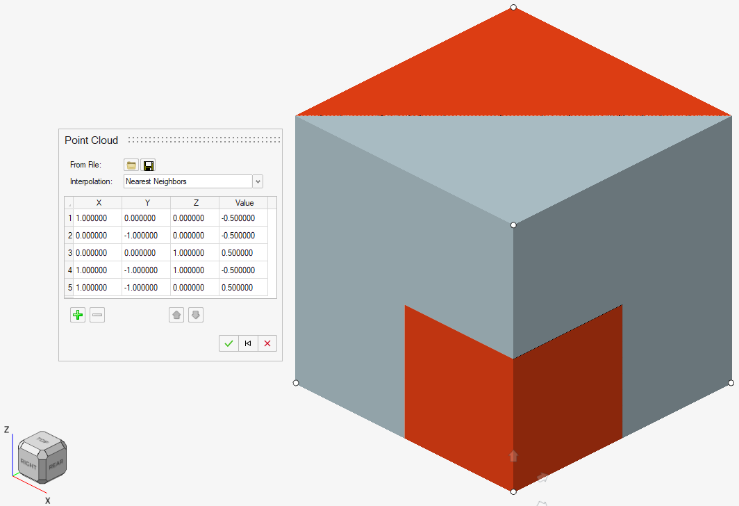

Nearest Neighbor Interpolation
Nearest Neighbor interpolation is simpler to visualize. Each position in the field adopts the scalar value of the nearest point in the point cloud. This technique forces abrupt changes in the resulting Interpolating Scalar field as nearby positions in space may "snap" to different scalar values.
Figure 6. Example of Interpolating Scalar Fields Using Nearest Neighbor Interpolation. This effect is shown for the same point cloud configuration. You will note that there is no banding in the color scheme, as there is no smooth variation in the field.

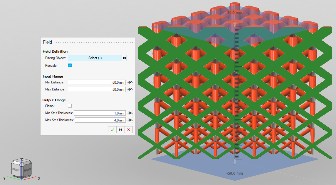

Fields can be used to locally vary certain parameters or sizings for existing geometry.
Here is a simple example of field-driven design.

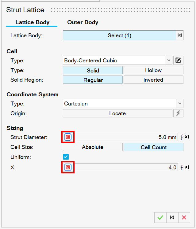

Figure 8. Section View of a Strut Lattice. The green face is the intersection between the lattice and the section plane. The thickness of the struts reduces linearly from the top blue plane to the bottom blue plane. The field was created based on the distance to the z=0 plane, where the range of distances for this model extend from -50mm to +50mm in the z-direction (the two blue planes). We use the Rescale checkbox option to map these distances into a suitable thickness range of 1mm to 4mm. To be clear, at -50mm to the reference plane, the thickness will be 1mm, and at +50mm from the reference plane, the thickness will be 4mm.
Figure 9. Strut Lattice Parameters. Continuing with the strut lattice example above, both the strut diameter and the unit cell sizing can be controlled using field-driven design. This is made clear by the small field button highlighted in red. When using this method, you should set all of the parameters that are not field driven (such as the unit cell type), and then create the field in situ using the relevant field button. In the strut lattice, a field was created by clicking the field button next to Strut Diameter and then defining the field using the global z-plane (z=0).
- Relating the local thickness of a lattice or shell to structural simulation data, thereby carefully placing material where it is needed
- Automatically controlling the radius of fillets throughout a model based on the level of stress experienced in that location, thereby efficiently relieving local stress raisers
- Locally strengthen or weaken structures to deliberately route forces through a preferred path (e.g., safely absorbing impact)
- Locally altering the sizing of lattice structures to changes non-structural properties (e.g., electromagnetic behavior, permeability or pressure drop in fluid flow, acoustic performance, heat-transfer coefficients, etc.)
- Seamlessly merge from one geometry type to another, to create different (meta) material properties in specific locations (e.g., morph from one lattice type to another to exploit their respective advantages within the same object)

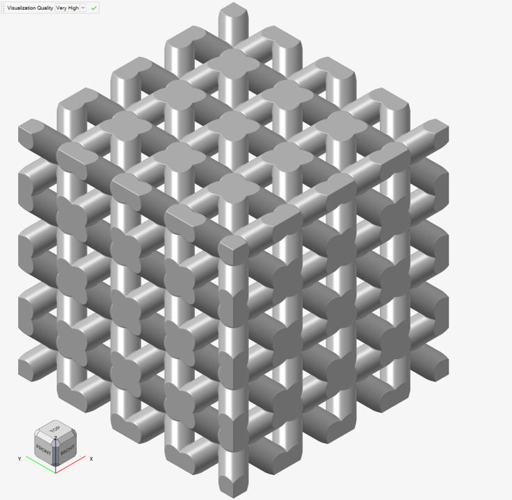

"Why do sharp edges look rounded?"

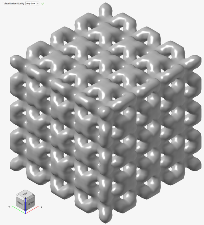

Although many fields technically have infinite resolution, they ultimately end up being sampled using a 3D grid. The coarseness or fineness of this grid is controlled by the Visualization Quality. Were the grid to be infinitely fine, sharp edges would be perfectly sharp. As the grid becomes coarser to match the computing resources available, sharp edges become somewhat rounded in both rendering and any subsequent conversion to, for example, a triangle mesh.
Figure 10. Lattice Structure with Very Low Visualization Quality
Figure 11. Lattice Structure with Very High Visualization Quality
To minimize this effect, you should finish the design in the highest visualization quality that your computer can tolerate, possibly even using a custom quality.

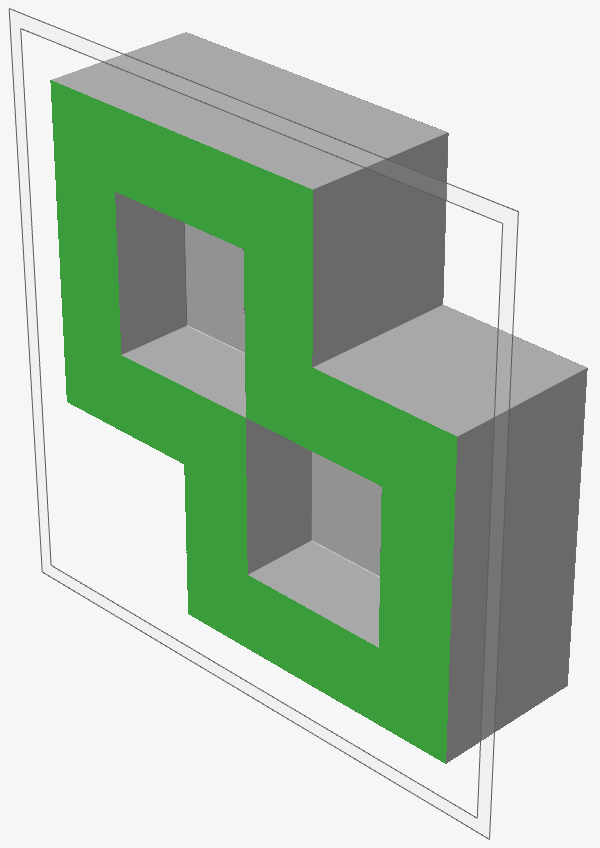

A Not So Obvious Pitfall: Not All Implicit Modeling Operations Preserve Distances When Combining SDFs
A common operation in implicit modeling is to combine separate bodies to form one connected body. This is often referred to as a Boolean union operation, but implicit modeling uses the shorter term "Combine." One would be forgiven for thinking that combining two bodies, each represented by an SDF, would result in another SDF. However, let's take a look at what happens to the field in this case. The images below were created using the following steps:
- Create two cuboid primitives that are offset from each other but still overlapping.
- Combine the objects (Boolean union).
- Create an inward shell of the combined object to create a hollow object of constant wall thickness.

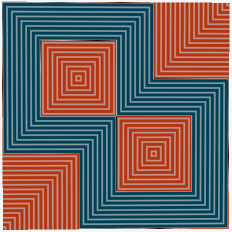

Figure 12. Section View of the Field
Figure 13. Section View of the 3D Object
Careful inspection of the above images will show that the wall thickness is not constant. Specifically, the region where the wall thickness causes the internal corners to touch represents a wall thickness that is larger than expected.

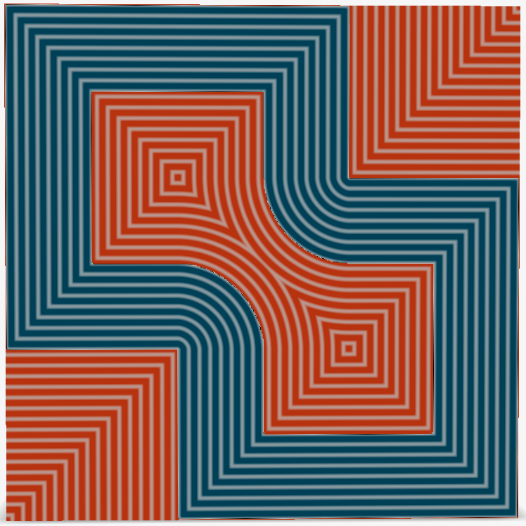

Figure 14. Section View of the Corrected Field
Figure 15. Section View of the Corrected 3D Object
To summarize, simply combining multiple SDFs does not necessarily result in a SDF after the operation. The same is true of other operations, such as smoothing, morphing, and offsetting operations. It is useful to keep this in mind when using Implicit Modeling in general.
