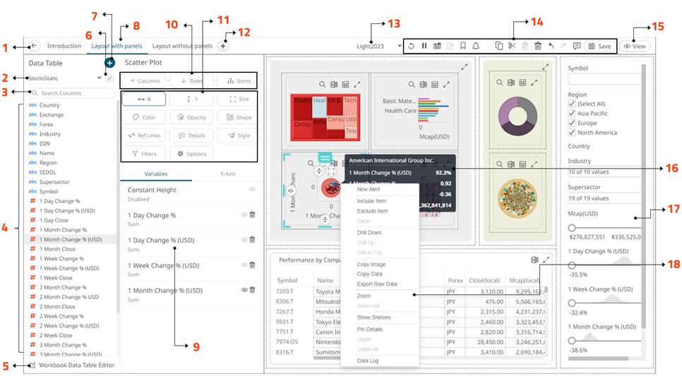

Using the Open Workbook in Design Mode
    Property  |
    Description  |
    1  |
    Back Exit the Workbook in Design Mode to go back to the Workbooks page  |
    2  |
    Data Table Selected data table  |
    3  |
    Search Columns Allows searching of columns in the selected data table  |
    4  |
    Data Table Columns Columns to drag to dashboard visualizations and parts  |
    5  |
    Go to Data Table Editor Displays Data Table Editor layout where you can further configure the data table.  |
    6  |
    Edit Data Table Opens the Edit Data Table Wizard. Enabled when the data table was added using the Add Data Table Wizard.  |
    7  |
    Add Data Table Opens the Add Data Table Wizard  |
    8  |
    Dashboard Selected dashboard where you can add, edit, and delete visualizations, filters, actions, and general parts You can also create, edit, duplicate, rearrange, and delete dashboards.  |
    9  |
    Columns Columns dragged to the X variable of the visualization  |
    10  |
    Breakdown, Columns, and Rows Allows definition of hierarchical structures for the visualization  |
    11  |
    Visualization Variables and Filters Variables and filters that can be defined for the visualization  |
    12  |
    New Dashboard Add new dashboard. You can also opt to select a template to use.  |
    13  |
    Workbook Theme Select the workbook theme  |
    14  |
    Toolbar Toolbar options in the Workbook in Design Mode  |
    15  |
    View Go to Workbook in View Mode  |
    16  |
    Show Details Displays information available in the Details variable of a visualization  |
    17  |
    Filters Filters added on the dashboard  |
    18  |
    Visualization Context Menu See Context Menu for more information.  |
