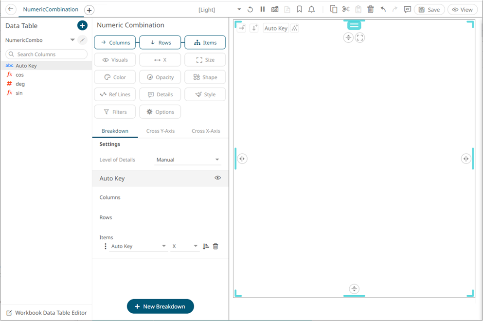

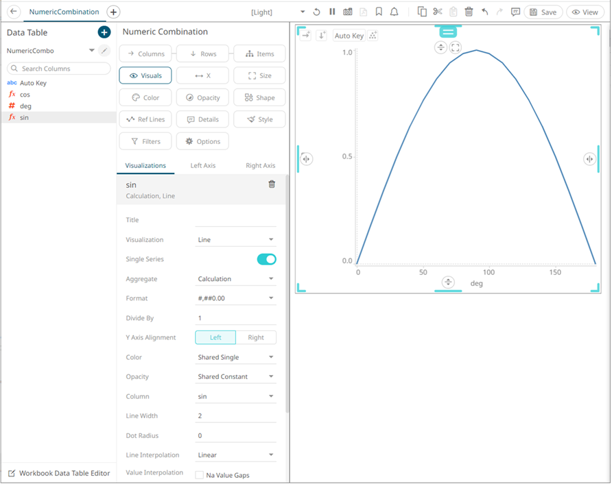

1.     The numeric combination settings pane is displayed after clicking the Options  button or the Visualization Title (i.e., Numeric Combination):
2.     Set the following property:
Setting
Show Coordinates
Determines whether the graph coordinates (i.e., X-Y plots, or Date/Time-Y plots) on mouse over are displayed in the visualization. Tap the slider to turn it on.

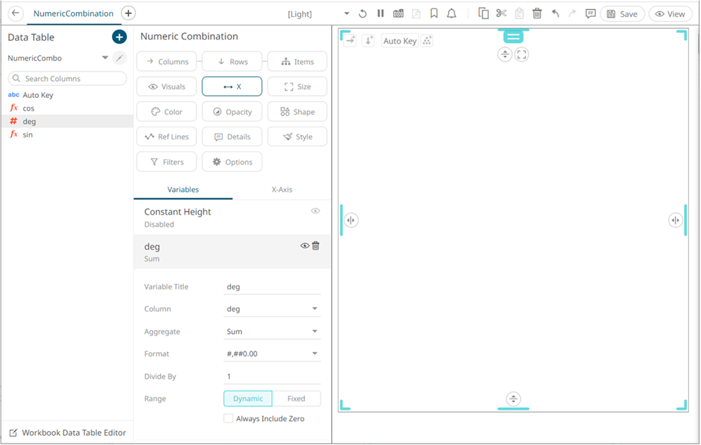

3.     To build the hierarchical structure in the numeric combination graph, drag text columns to the Breakdown Items drop area (e.g., Auto Key).
4.     To set the X-axis, drag numeric columns from the Data Table pane to the X variable drop area.
For this sample visualization, the deg column will be the used as the height variable.
5.     You can opt to drag columns to the Size, Color, Opacity, Shape, Reference Lines, and Details drop area.
6.     Continue designing the visualization by dragging numeric columns from the Data Table pane to the Visuals variable drop area.
The column (e.g., sin) is added under the Visualizations tab list and, by default, uses the Line graph and the Left Y-Axis alignment.
The graph displays a single series based on the column added in the breakdown.

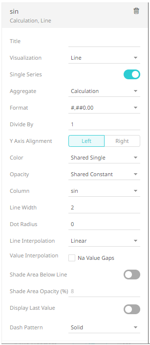

8.     Visual members can be set to display any of the following visualizations:

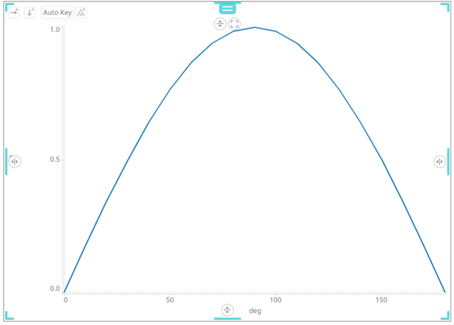

·         Line
Additional settings include:
Setting
Single Series
Determines whether to use all columns in the breakdown to create a single series or if one column should be used to divide the data into multiple series.
Opacity
Select the Opacity value.
Line Width
Specifies the line width in pixels.
Dot Radius
Specifies the radius of each data point in pixels.
Line Interpolation
Specifies whether the line is Stepped, Linear, or Smooth interpolation.
Value Interpolation Time Gaps
Determines whether time axis gaps (Working Week/Time) are interpolated.
Value Interpolation Na Value Gaps
Determines whether Na value (or missing) gaps are interpolated.
Shade Area Below Line
Defines that opacity shades are applied between the lines and the zero Y grid line.
Shade Area Opacity (%)
Specifies the opacity (transparency) of the shaded area, expressed in percent 0-100 of the opacity value currently set on the line.
Display Last Value
Determines if the flag of the last value will be displayed.
Once enabled, the Show Last Value Title is displayed.
Check the box to display the title of the last value in the flag.
Dash Pattern
Specifies the line pattern. Available options are:
·         Dotted
·         Dashed
·         Solid

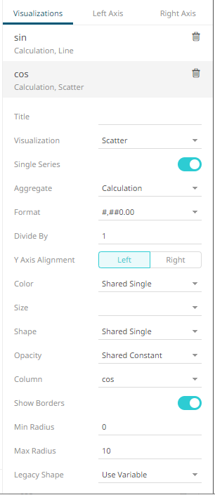

Sample 1. Single Series is enabled, and the Color is set to Custom Single (#2580bd).

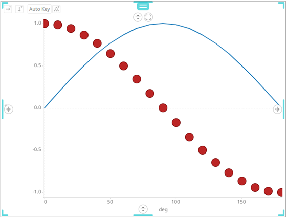

·         Scatter
Setting
Single Series
Size
Select the Size variable that will be used.
Shape
Select the Shape value.
Opacity
Show Borders
Determines whether a border is drawn around each scatter point.
Min Radius
The minimum radius in pixels of the scatter point.
Max Radius
The maximum radius in pixels of the scatter point.
Legacy Shape
Allows older workbooks to be updated and use the shape variable. Default is Use Variable.
Other shapes can also be selected.
Sample 2. Single Series is enabled in the Line and Scatter graphs. In addition, in the Scatter graph, the Color is set to Custom Single (#bb2525).

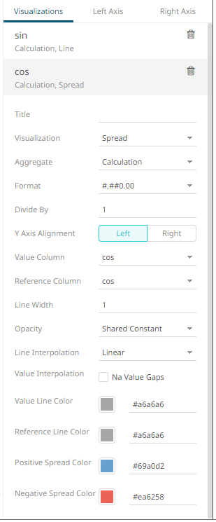

·         Spread
Setting
Reference Column
The field that will be used as the reference line data series.
Line Width
Specifies the width in pixels of the Spread Graph data series lines.
Opacity
Spread Color Opacity
Specifies the level of color transparency/opacity for the Positive and Negative Spread colors. The value is from 0 to 255 with the default set to 128.
Line Interpolation
Specifies the interpolation mode as Linear, Stepped, or Smooth.
Value Line Color
Specifies the color of the value line data series.
Reference Line Color
Specifies the color of the reference line data series.
Positive Spread Color
Specifies the color when the spread between the value and reference is positive.
Negative Spread Color
Specifies the color when the spread between the value and reference is negative.
Sample 3. Single Series is enabled in the Line graph. In addition, in the Spread graph, the Value Column is set to the cos column, and the Reference Column to the sin column.

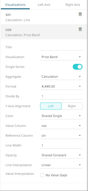

·         Price Band
Setting
Single Series
Reference Column
Line Width
Opacity
Line Interpolation
Sample 4. Single Series is enabled in the Line and Price Band graphs. In addition, in the Price Band graph, the Color is set to By Sign, the Value Column is set to the cos column, and the Reference Color to the sin column.

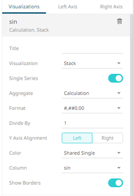

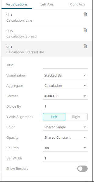

·         Stacked Bar or Grouped Bar
Setting
Bar Width
Specifies the width in pixels of each bar.
NOTE: This is overridden when a column is added in the Size variable. Consequently, the width of the bars will be based on the comparison of their size in relation to where they are located on the X axis.
Show Borders
Specifies whether a border is drawn around bars. These are only visible if the Bar Width is greater than 1 pixel.
·         Stack
Setting
Single Series
Show Borders
Specifies whether a border is drawn around stacks.
