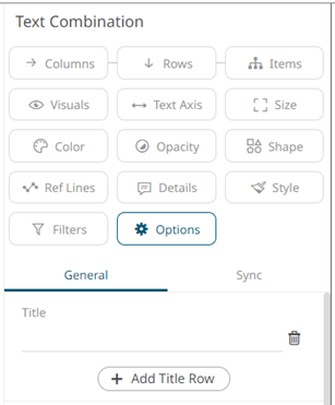

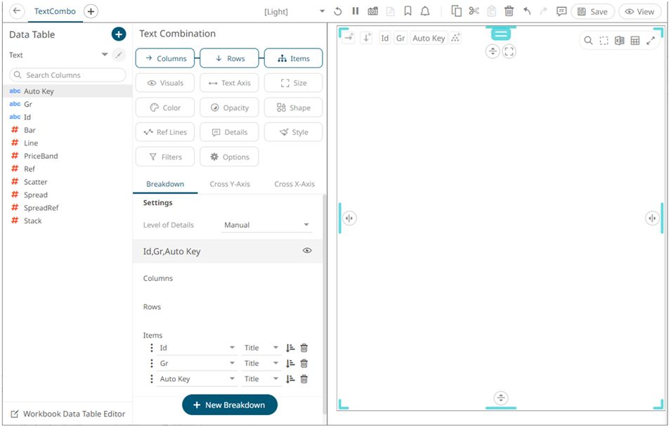

1. The text combination settings pane is
displayed after clicking the Options
button or the Visualization
Title (i.e., Text Combination):
2. To build the hierarchical structure in the text combination graph, drag text columns to the Breakdown Items drop area (e.g., Id, Gr, and Auto Key).

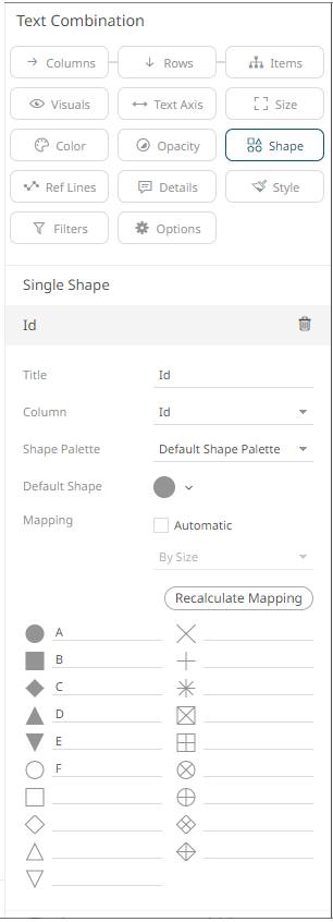

3. You can opt to drag columns to the Size, Color, Opacity, Shape, Reference Lines, and Details drop area.
For this sample visualization, we dragged the Id column to the Color and Shape variables drop areas.

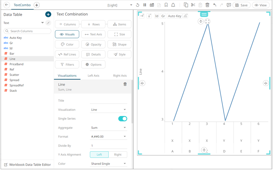

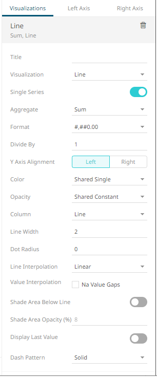

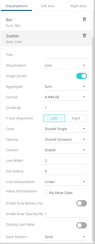

4. Continue designing the visualization by dragging numeric columns from the Data Table pane to the Visuals variable drop area.
The column (e.g., Line) is added under the Visualizations tab list and, by default, uses the Line graph and the Left Y-Axis alignment.
The X axis displays the multi-level hierarchy based on the three columns added in the breakdown (e.g., Id, Gr, and Auto Key). The Y axis displays the added visual member (e.g., Line).
5. The properties that you can set will depend on the visualization type that you will add.
The general settings include:
Setting |
Description |
Title |
Title of the visualization. |
Visualization |
If the visualization is incorrect, instead of deleting, you can just select another one in the Visualization drop-down list. The settings pane will be changed to display the corresponding properties of the selected visualization. |
Aggregate |
Aggregation method to be used. Default is Sum. |
Format |
The format that numbers will be displayed in. Panopticon uses the same formatting rules as MS Excel. |
Divide By |
Select the Divide By value to divide a number: · 1 · 1000 (by a thousand) · 10000 · 1000000 (by a million) · 1000000000 (by a billion) |
Y Axis Alignment |
The Y-Axis alignment: Left or Right. |
Color |
The Color variable that will be used for the column: · None · Shared Single · Custom Single · Column added to the Column variable |
Column/Value Column |
The column used for the visualization. If the dragged column is incorrect, instead of deleting, you can just select another column in the Column/Value Column drop-down list. |
6. Visual members can be set to display any of the following visualizations:
· Line
Additional settings include:
Setting |
Description |
Single Series |
Determines whether to use all columns in the breakdown to create a single series or if one column should be used to divide the data into multiple series. |
Opacity |
Select the Opacity value. |
Line Width |
Specifies the line width in pixels. |
Dot Radius |
Specifies the radius of each data point in pixels. |
Line Interpolation |
Specifies whether the line is Stepped, Linear, or Smooth interpolation. |
Value Interpolation Time Gaps |
Determines whether time axis gaps (Working Week/Time) are interpolated. |
Value Interpolation Na Value Gaps |
Determines whether Na value (or missing) gaps are interpolated. |
Shade Area Below Line |
Defines that opacity shades are applied between the lines and the zero Y grid line. |
Shade Area Opacity (%) |
Specifies the opacity (transparency) of the shaded area, expressed in percent 0-100 of the opacity value currently set on the line. |
Display Last Value |
Determines if the flag of the last value will be displayed. Once enabled, the Show Last Value Title is displayed.
Check the box to display the title of the last value in the flag. |
Dash Pattern |
Specifies the line pattern. Available options are: · Dotted · Dashed · Solid |

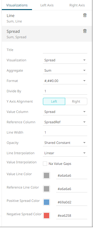

· Spread
Setting |
Description |
Reference Column |
The field that will be used as the reference line data series. |
Line Width |
Specifies the width in pixels of the Spread Graph data series lines. |
Opacity |
Spread Color Opacity |
Specifies the level of color transparency/opacity for the Positive and Negative Spread colors. The value is from 0 to 255 with the default set to 128. |
Specifies the interpolation mode as Linear, Stepped, or Smooth. |
Value Line Color |
Specifies the color of the value line data series. |
Reference Line Color |
Specifies the color of the reference line data series. |
Positive Spread Color |
Specifies the color when the spread between the value and reference is positive. |
Negative Spread Color |
Specifies the color when the spread between the value and reference is negative. |

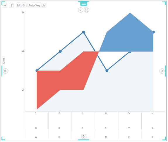

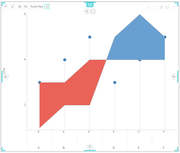

Sample 3. Single Series is enabled in the Line graph. In addition, in the Spread graph, the Value Column is set to Spread, and the Reference Column to SpreadRef.
Sample 4. Single Series is disabled in the Line graph. In addition, in the Spread graph, the Value Column is set to Spread, and the Reference Column to SpreadRef.
The last column in the breakdown (e.g., Auto Key) is used to divide the data into multiple series.

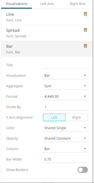

· Bar
Setting |
Description |
Opacity |
Bar Width |
Specifies the width in pixels for each bar. |
Show Borders
Determines whether borders are drawn around bars. These are only visible if the Bar Width is greater than 1 pixel. |

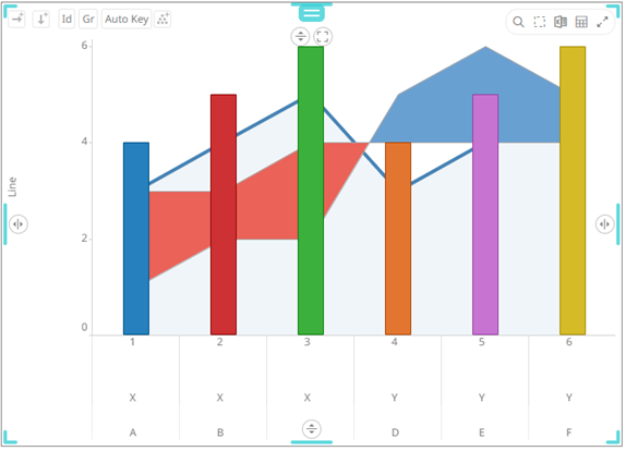

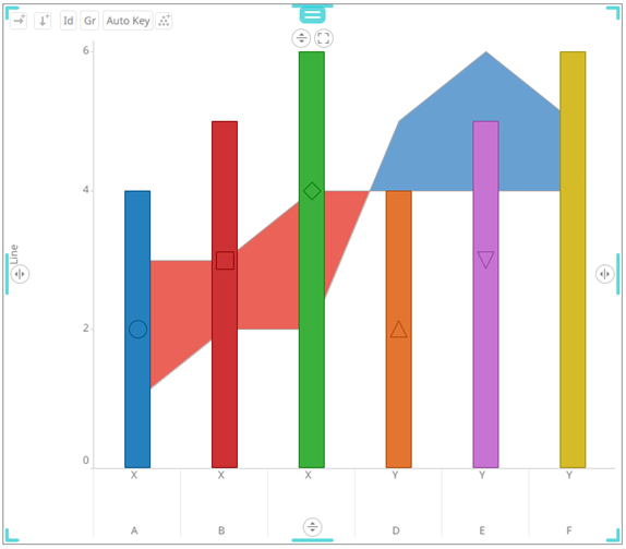

Sample 5. Single Series is enabled in the Line graph. In addition, in the Bar graph, the Color is set to column Id, the Bar Width to 0.3, and the Show Borders is enabled.
Sample 6. Single Series is disabled in the Line graph. In addition, in the Bar graph, the Color is set to column Id, the Bar Width to 0.3, and the Show Borders is enabled.

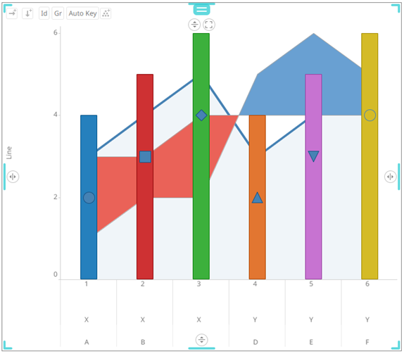

Sample 7. Single Series is enabled in the Line and Scatter graphs. In addition, in the Scatter graph, the Shape column is set to Id and the Min Radius to 3.
Sample 8. Single Series is disabled in the Line and Scatter graphs. In addition, in the Scatter graph, the Shape and Color columns are set to Id and the Min Radius to 3.

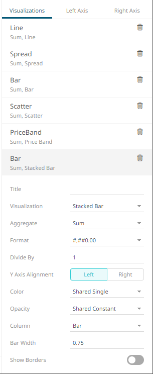

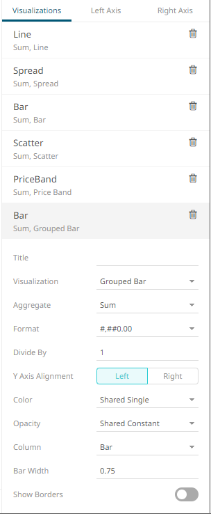

· Stacked Bar or Grouped Bar
Setting |
Description |
Bar Width |
Specifies the width in pixels of each bar: NOTE: This is overridden when a column is added in the Size variable. Consequently, the width of the bars will be based on the comparison of their size in relation to where they are located on the X axis. |
Show Borders |
Specifies whether a border is drawn around bars. These are only visible if the Bar Width is greater than 1 pixel. |

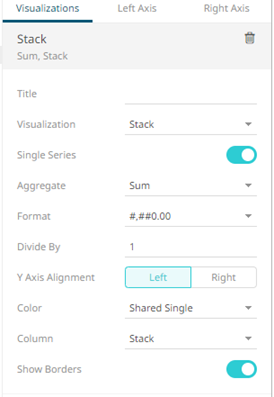

· Stack
Setting |
Description |
Single Series |
Show Borders |
Specifies whether a border is drawn around stacks. |

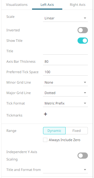

7. The text combination visualization includes an expanded axes pane, which includes specification of the properties for both the Left and Right Y axes.
Select or specify the following properties:
Setting |
Description |
Scale |
Determines whether the scale of the axis is Linear, Log, or Power. · Linear – a change between two values is based on addition e.g., 30, 60, 90, 120, 180, etc. · Log - a change between two values is perceived based on the ratio of the two values or based on multiplication. Once selected, the Base control displays the value of the common base for the logarithmic scale (i.e., 10).
For example, log10(x) represents the logarithm of x to the base 10 e.g., 1, 10, 100, 1000, etc. You can opt to enter a new Base
value then click NOTE: Value cannot be lower than 2. · Power – Works according to the SIGN(MEASURE)*LOG10(MAX(1, ABS(MEASURE))) formula. Works like the Log scale except it can handle negative values and every value between -1 and 1 is set to 0. For example, for values between -100 and 100, the axis will be: -100, -10, 0, 10, 100 |
Inverted |
Determines whether the Y or Height axis is inverted. |
Show Title |
Displays an Axis Title label. When enabled, you can opt to enter a custom Title for the axis which will override the title of the visualization variable. |
Axis Bar Thickness |
The margin in pixels for the axis. If set to zero, the axis is removed. |
Preferred Tick Space |
The preferred space in pixels between the minor grid lines across the axis. |
Minor Grid Line |
How minor grid lines are drawn across the axis. Allowed values: · None · Dotted · Dashed · Solid |
Major Grid Line |
How major grid lines are drawn across the axis. Allowed values: · None · Dotted · Dashed · Solid |
Tick Format |
Set to From Variable to use the format string that is on the current variable displayed in the axis. Set to Metric Prefix to format the Tick labels in the numeric axes using the metric prefixes. |
Tickmarks |
Click
Enter the Value and the Label. Click
Range |
The visible range for the Left and Right Y-axis variables can either be calculated dynamically (Dynamic Range) or set between predetermined limits by selecting Fixed Range. This enables the Min and Max text boxes and populates them with default values taken from the data set. |
Independent Y-Axis Scaling |
Determines whether to have each visualization Y-axis in a cross tab automatically scaled independent of the others. |
Title and Format From |
The title and format of the Left and Right Axes based on the selected fields. |
