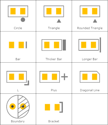

- First Pin Mark Shape Definition: Select the shape of the First Pin
Mark.
Allowable polarity mark types in PollEx DFM are as follows: If the following types of polarity marks are detected in the searching area, PollEx DFM recognizes that the component has a polarity mark.

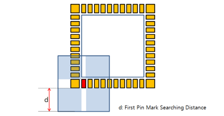

- Check First Pin Mark within First Pin Area for Board Figure
Geometry: If first pin mark is designed with board figure geometry,
PollEx DFM searches for the first pin
mark within the area near first pin.
- Searching Distance from First Pin: Set the distance from the
first pin.
first pin.
