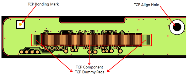

TCP component is a tape carrier package. TCP align hole is used to fix the TCP components.

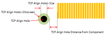

- TCP Align Hole Definition: TCP align hole can be defined with the hole size
and distance from the TCP component.
Figure 2.- Definition with Hole Size: Define the align hole with its size. Using the floating value input tool, set the size or range of hole size.
- Define with Distance from TCP Component Group: TCP align hole should
not be apart from the TCP component. They should be placed close
together.

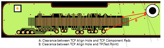

- TCP Align Hole Clearance Checking: Check clearances between the TCP align
hole and the TCP component pad/test points in the design.
Figure 5.- Clearance between TCP Align Hole and TCP Pads: Set the clearance value between the TCP align hole and the TCP component pads.
- Clearance between TCP Align Hole and TP (Test Point): Set the clearance value between the TCP align hole and the test points.

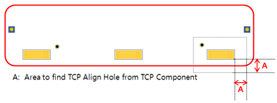

- Existence Check for both Edge Components: Check if all edge TCP
components have a TCP align hole within the given area. Hole
searching area is defined in the TCP Align Hole Definition. If one
of them doesn’t have a TCP align hole, it is a fail.

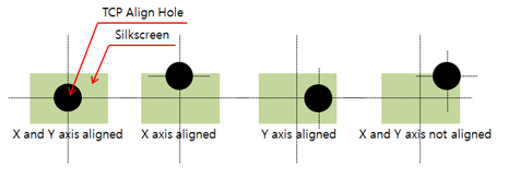

Figure 6. - Silk Hole Mark Alignment with TCP Align Hole: Check if the TCP align
hole and silkscreen are aligned along the given axis.
Figure 7.- X: Check if the TCP align hole is aligned with silkscreen along the X-axis. If they are not aligned along the X-axis, it is a fail.
- Y: Check if the TCP align hole is aligned with silkscreen along the Y-axis. If they are not aligned along the Y-axis, it is a fail.

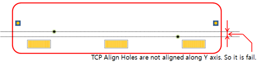

Figure 8. - Alignment between Side Edge TCP Align Holes: Check if the side
edge’s TCP align holes are aligned with each other along the
Y-xis.
Figure 9.- Tolerance: For the two location values, if they are less than the tolerance, PollEx DFM recognizes them as the same value.
- X/Y: Select alignment axis.
