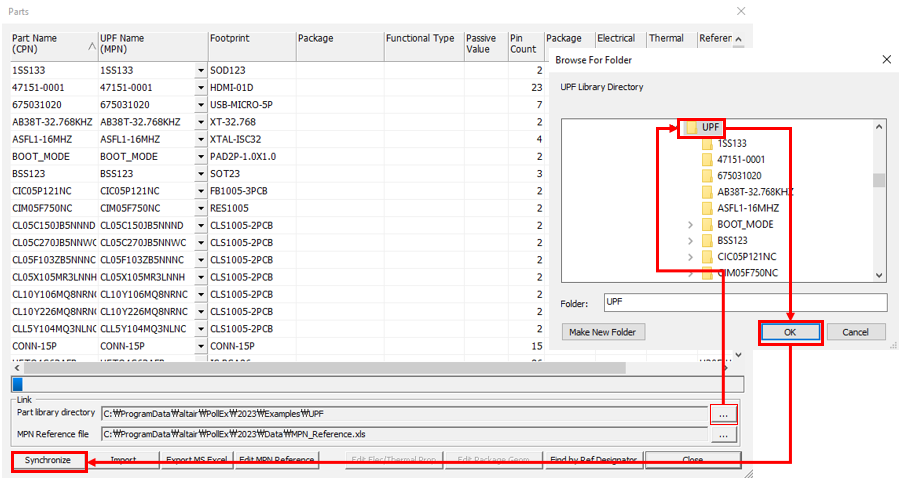

Link Unified Part Libraries.
From the menu bar, click Properties > Parts.
Click in the Part Library Directory.
Select the UPF folder in the path
(C:\ProgramData\altair\PollEx\<version>\Examples\UPF)
and click Synchronize.
You can check the linked data in the package, electrical and
thermal columns for 3D package shape for SI and Thermal analysis.
Click Close.

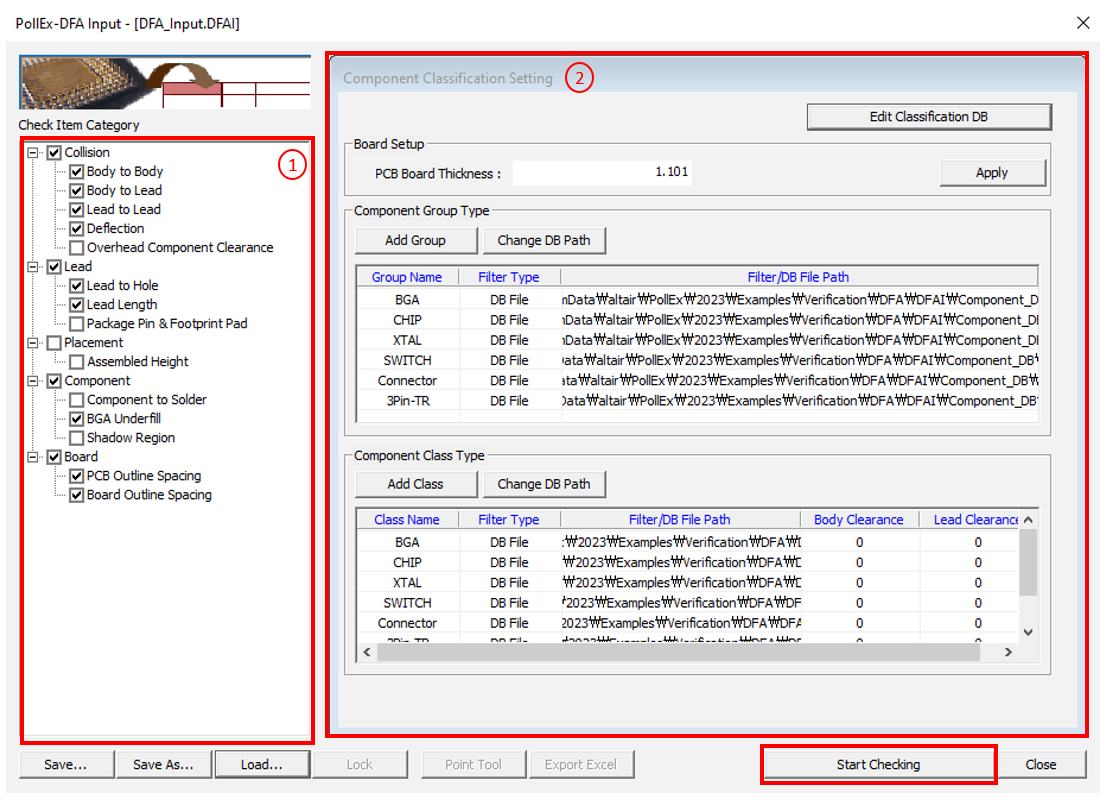

Open DFA Input setting file.
From the menu bar, click Option > DFA > Input.
To load the DFA rule file, click Load and select the
DFA_Input.DFAI file from
C:\ProgramData\altair\PollEx\<version>\Examples\Verification\DFA\DFAI
Click Open.
Check DFA Input file and verification.
In the Check Item Category menu, you can see the lists of checking items. In
the Component Classification Setting, you can classify a component
group.
Refer to the DFA manual
for the detailed rule settings.
Click Start Checking to run the
verification.

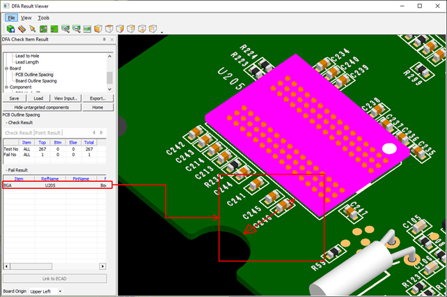

Check the DFA verification results by clicking PCB Outline
Spacing from the item list.
You can check detailed information of the No Good (fail) items from
the lists. Figure 3.
The above image is an example where the U205 part fails due to not
complying with 7mm clearance from the PCB board outline.

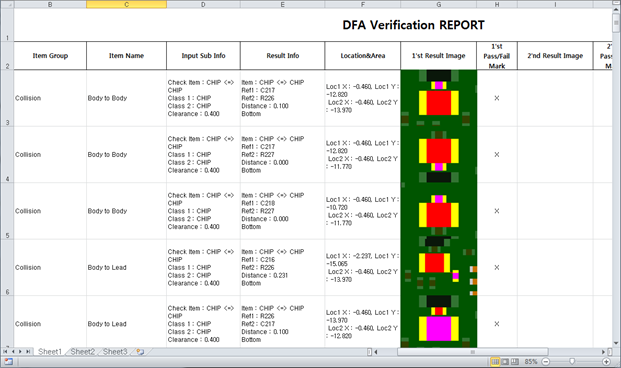

Excel export of DFA verification result.
From the menu bar, click Export > User Defined Excel Format to execute the wizard.
Click Load and select the
PollEx_DFA.DFAE file from
C:\ProgramData\altair\PollEx\<version>\Examples\Verification\DFA\DFAE.
